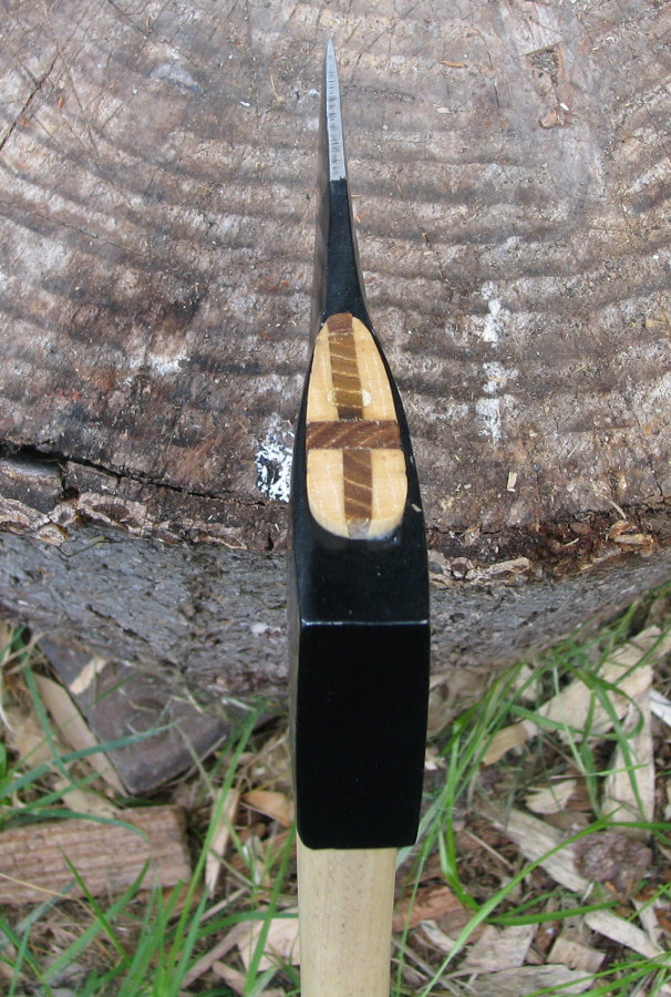

I will have an actual project in the next few days but in the mean time this poorly drawn diagram. This is just how I do the cross wedges, there are other methods that make sense. The next time I do one, I'll photograph it along the way.
crosswedge by city_ofthe_south, on Flickr
What I wanted to illustrate is that the first wedge is the same width as the handle - top left image.
Top right image shows the wedge driven. The green line indicates where I split the wedge with a chisel. The arrows indicate that the first wedge has spread the handle "front to back".
Bottom image shows that the second wedge can be driven as usual.
Another picture of the same concept.
crosswedge2 by city_ofthe_south, on Flickr
First image the black is the eye, the 2 kerfs are cut.
Second image the first wedge is driven the same width as the handle, spreading the eye "front to back", leaving room "left to right" for the handle to spread.
Third image shows a wedge as wide as the eye. You can picture that when the second wedge is driven it will be fighting the first one.
Final image shows both wedges driven, filling up the eye.
So, could you just use 2 small wedges in the 3rd picture to solve the problem? Yep. But to my way of thinking, this is simpler and the result is the same.

That's what I do. I don't split the cross wedge. But your way looks just as good.

I would have done the same! Good plug for Florida if you emphatically muttered some version of "sunny beaches". I have a hard time visualizing that a wood wedge could have done this to a sound head; is that entire crack fresh? In the same token it does make me wonder if soft hardwood wedges (Poplar) became an industry mainstay (instead of Hickory/Oak/Maple wedges) through misfortunes such as this.
The same thought has crossed my mind. Imagine a time before welders. Your axe was finished at this point. I can see how a softwood wedge could become the industry standard. Not that it's necessarily best, but that the lost revenue from occasional failures would cause the industry to seek alternatives.
Thanks fellas. I think I've got someone in mind who can handle the weld. Good Lord was the wedge and handle tight .... I've pulled a lot of my own handles before, but not right after hanging one. It was hung for life.
Sorry, I meant to respond to this. I think there was a small crack there. I didn't do a good job examining it, and I think that I mentally wrote it off as something typical at the point of the eye, but it's one of those things where you know you can't rely on your memory because you didn't make an effort to look and think about what you were seeing. Yeah my theory is basically that "something" was there and I made it worse.
I think it's possible that my use of harder wedges may ultimately be turning out to be wrong, or risky. As you guys are pointing out, if the wedging process could destroy an axe, then I could see avoiding the risk. Though I have no idea what that wood is. You are seeing it nice and fresh in these pics because at that point all I did was quickly sand a hair off the top - you can still see the ring where it was held in the lathe - so maybe one of you guys will have an idea. I believe it is stud material (2x4) but it's really old and rough sawn. It's just something that was in my shed when we moved here.
Building studs today are almost exclusively Spruce with a small proportion of Red-type Pines thrown in despite the ubiquitous S-P-F (Spruce-Pine-Fir) grading stamps. Hemlock/Douglas Fir is hardly ever used because it's tough to nail and it splits easy. Judging by the distinct band colouration you've likely got a Fir or perhaps a Southern Pine. To me that's a hard softwood and not really different from a soft hardwood so I don't think you can blame the wedge.
