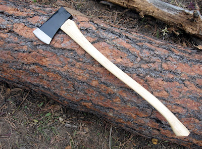

Council tool velvicut boys axe is finally here...
Looks great, and glad to have more choices. But from the photo it looks like a pretty uneven grinding job for a $140 axe.
From the website:
"Final hardness Rc 52-56."
That's respectable. I'd like to take a file to one just to see. My gut feeling is that they have a winner here.
Just a standard polished US Forest Service Boy's Axe head & pre-stained handle?
http://www.counciltool.com/product.asp?pg=product&item=JP22DV28C
Velvicuts are 5160 alloy steel, Council's standard axes and FSS heads are tool steel (unspecified). The Velvicut handles are also the pick of the litter with regards to grain orientation and density. The one in the photo looks stained probably because it's heartwood.
I'd love to see a spec to spec comparison of the two.
They are identical in weight.
Is a handle coated in linseed oil considered "stained" or is there a diiference between "stained" & "coated"?
Because Council claims that Bad Axe's handle is coated with linseed oil.

The forging dies that they use to form axe heads cost a fortune. That's why it's so hard for even a large company like Counsel to introduce a new pattern. They already had the dies for a boys axe and it would be a desirable pattern for people who would buy the velvicut line so it's really a no brainer business wise. I would love to see a Connecticut or jersey next as well as a smaller variance in hardness. I can't even imagine what the sales would be on a decent jersey. The Kelly perfects regularly go for $50-$60 on ebay even in pretty bad condition.
..I would love to see a Connecticut or jersey next as well as a smaller variance in hardness.
I'm just happy to see that someone tipped them off on the HRC issue.. I've been going on and on in these Council threads about how 5160 is indeed a good choice of steel for premium axes, but how it won't shine at the 50-54 hrc they were keeping it at. Even GB's proprietary 1050 will outdo it because of the better heat treat (57hrc). I just looked over their whole velvicut offering and it seems they've upped it to 52-56hrc. I'd still like for them to get it to a smaller variance of 54-56 (or even 55-57), but it's definitely a step in the right direction. Might just pick one up!
