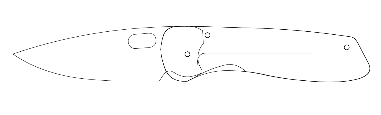

Type - Tactical Framelock, .190" Ti Frames and a .203" CPM D2 blade. My goal is a clean or simple look with overbuilt features.
I am using phosphor bronze washers and want the smoothest action possible. Hopefully it will flick open if I get everything right.
1/4" AKS Pivot - 1/4" standoffs - 1/4" Press Fit Stop Pin

Here's what I am making
The holes are undersized in this sketch, they represent where the pivot, stop pin and lanyard hole will be placed. I'll be adding a .25" standoff to either side of the lanyard hole as well.
