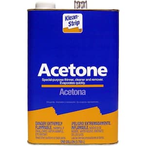

i am glad i asked. are there any store bought items that have enough acetone in them to work? if so what?
this is not the cheapest hobby so you might hav eot buy straight up acetone be warned that you cant use a cooler to hold the mix as it will jsut eat it up
A can.
I just buy Acetone by the quart or the gallon in the hardware and auto parts store store.
It works for glue clean-up too.
http://www.homedepot.com/Paint/h_d1...splay?langId=-1&storeId=10051&catalogId=10053
17$ a gallon at Homedepot.com in the USA
It's in the paint section.
Butch
Good point on the cooler, it will eat Styrofoam and many plastics up
