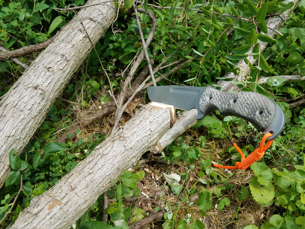

This is probably my most used chopper, which is 3V, and it handles it like a champ. I use it for just about everything. I know I probably shouldn’t use a machete as a chopper, but it is extremely rugged and oh so much fun, haha.
Though, I do have a Himalayan Imports CAK, and that thing is purely a chopper. If I want to plain old wreck stuff, the CAK comes out with me.
