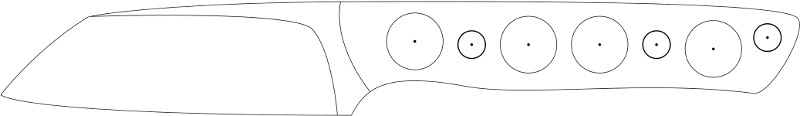

7" OAL, 1" height
.113" (3/32") CPM 3V tempered to 60Rc
Almost full flat right hand chisel grind with microbevel
1/8" G10 handles, bright colors with black .060" G10 liners. I have Orange, Neon Green, Blue and Red.
Design:
Note 1: Though the design has the grind on the left side, this will be a right hand chisel grind (unless someone requests a left hand grind )
Note 2: I designed the blades originally to use 1/4" chain ring bolts. Since I can't get any that will work with a blade and handle this thin I am going to use 1/8" stainless pins and 1/4" stainless tubestock for the lanyard hole.

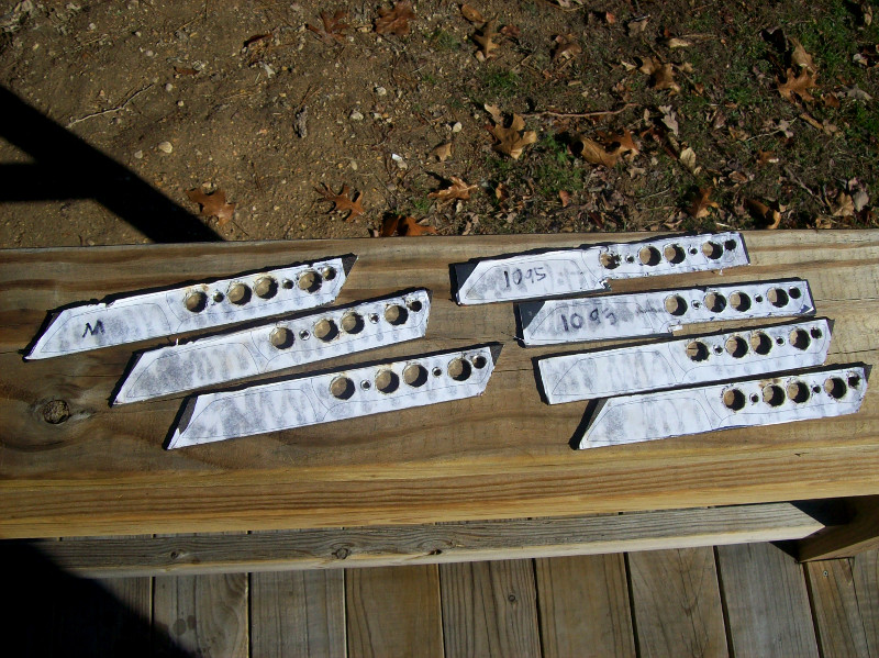

These have had my design printed out and glued to the bar then I cut them to length. I like to drill all my holes before I profile because the heat from profiling will usually require a dip in water to cool the blade; this blurs my lines. I know where the profile should be (I designed it after all ;)) but I like to drill my holes based on the template.
That's all I have done for now; my 2"x72" grinder will arrive on Monday and I will profile them then. My belts and everything else I'll need came with the steel from USAKnifeMaker.com

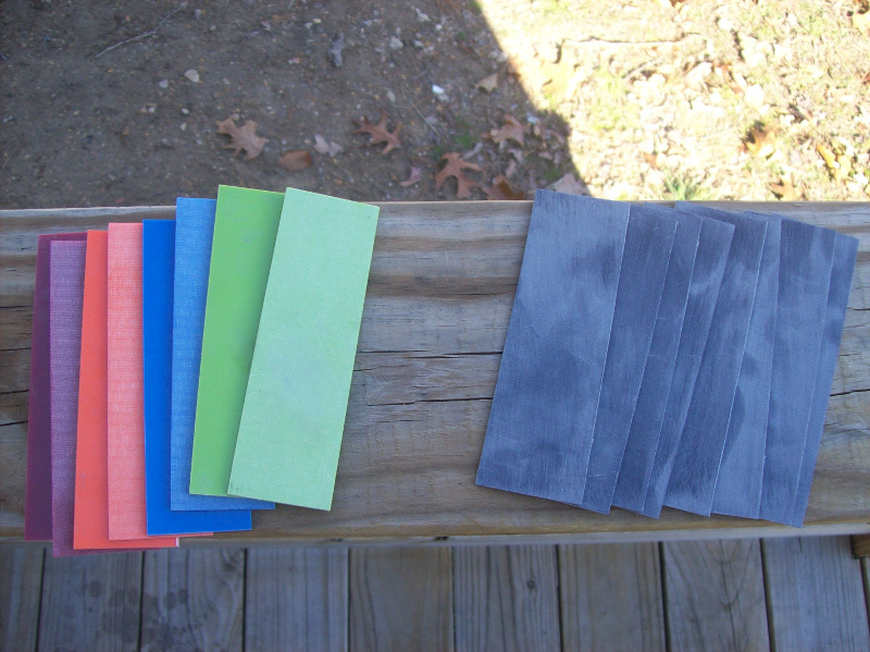

Here's the pieces, the liners have been cut to size from a sheet and roughed up.
Here's what they will look like.

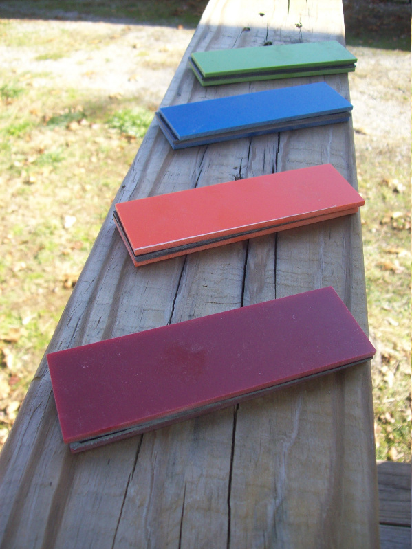

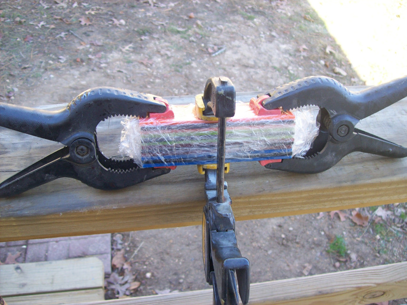

I got my epoxy made and glued a liner to each scale. I stacked all of the pieces together with plastic wrap in between what I didn't want to glue together.
Most (but not all) glues will not bond to plastic. The epoxy I am using won't.
The entire block is sitting under a lamp now to keep it at a nice warm curing temperature. They should be cured by tomorrow morning and we'll see how it turns out then.
Thanks for looking.

I like the design and your methodology. If you can't cut any closer to the profile lines, drilling some holes in the negative areas outside the lines will help grinding go faster and cooler later. I haven't done the math but it seems to me that bits remove metal faster than belts.
Thanks James, I have used the hole drilling technique extensively on larger blades. On these, the most I have to grind though is the handle area and that is ~1/4" at the most. I have a brand new 36grit CubitronII thats going to be profiling these out; it shouldn't take too long.

I love that drawing, matt. Can't wait to see more.
I'm little unclear about this drilling method, do you mean to help profiling as in drilling outside the profile, or actually the bevel grind? How does that work if so?
You should be seeing more of it once I get my grinder in ;)
Drilling outside the profile, it helps by reducing the amount of metal you have to grind. If you use a saw it reduces the amount you have to cut and lets you follow curves a little tighter. If you're like me and you are using a saw that is slow, hard to use, and can only cut in straight lines (sawzall) then pre-drilling a path along your line helps a lot!
I learned something today. Thinning your epoxy a little to help it flow is usually a pretty good idea; sealing thinned epoxy in with plastic wrap is not :thumbdn: The acetone cured out of the epoxy alright but collected all over the inside of the plastic where it kept the excess epoxy there from curing all the way. Sticky and stinky but the epoxy between the liner and scale seems to be alright. I'll do some tests tomorrow to make sure.
