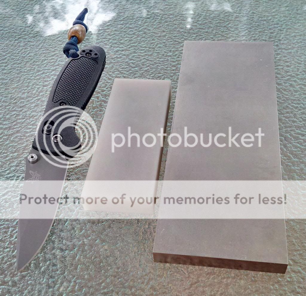

First post in the benchmade section. Just picked up one of these in CPM-M4. I always wanted to try the steel. I have had it for a few and used it for cardboard, whittling hardwood, foil, food, rope/twine etc. It will see a lot of use in the future. I waited to put up my initial reaction until I figured out sharpening this. Turns out its not bad at all. My beloved collection of Arkansas stones were not the most useful but the diamond makes it a snap. I settled on my hard leather strop with black compound that I made. Gave me the best reaction out of all my strop types and compounds. Interesting enough I can still use the translucent Arkansas stone in the picture. It takes the stropped diamond edge and just pushes it even scarier with a few light passes. I am sure I will be figuring tricks hear and there to get even more out of this steel but that will come with time and using the knife.
As for the knife, its small in my hand and a three finger grip but that is okay. The blade centers and has no lock play. Speaking of lock play this is my first experience with the Axis lock and I have to say this lock is ingenious and it makes me wonder why I ever spent so much on all my liner locks and frame locks. That is for another time though.
The blade is nice and thin for a modern knife with a great flat sabre grind. I would prefer a full flat grind but its still nice geometry. The handle is great, I love checkering and do not need the extra weight of G10.
All in all I really love this little knife for what it is and it will be my carry for a while. I am a HUGE traditional fan but this one spoke to me.

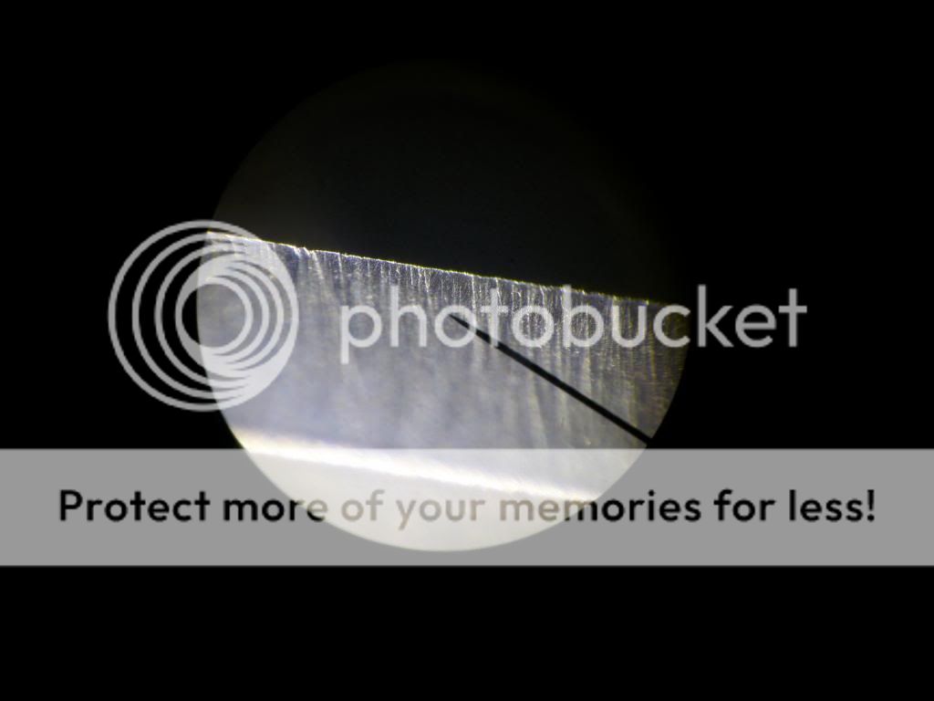

Holo07, Mine came with a tenacious wire edge just like the one in your picture! I have worked a little more on mine with a LOT of cutting tests in between just to see what this steel is all about. I modified my old barbers strop and swapped in a new compound that works better with this steel. Now I am feeling MUCH more comfortable with this as an EDC. I thought some may be interested to see a 100x microscope shot of my edge as it stands now. You can see at the apex the microserrations with a lack of any burr. The other interesting detail is my diamond stone does not seem to be broken in that well. You can see some larger abrasions, but do remember this is 100x. I hope to get this edge even better as I learn more about it through my own trial and error.

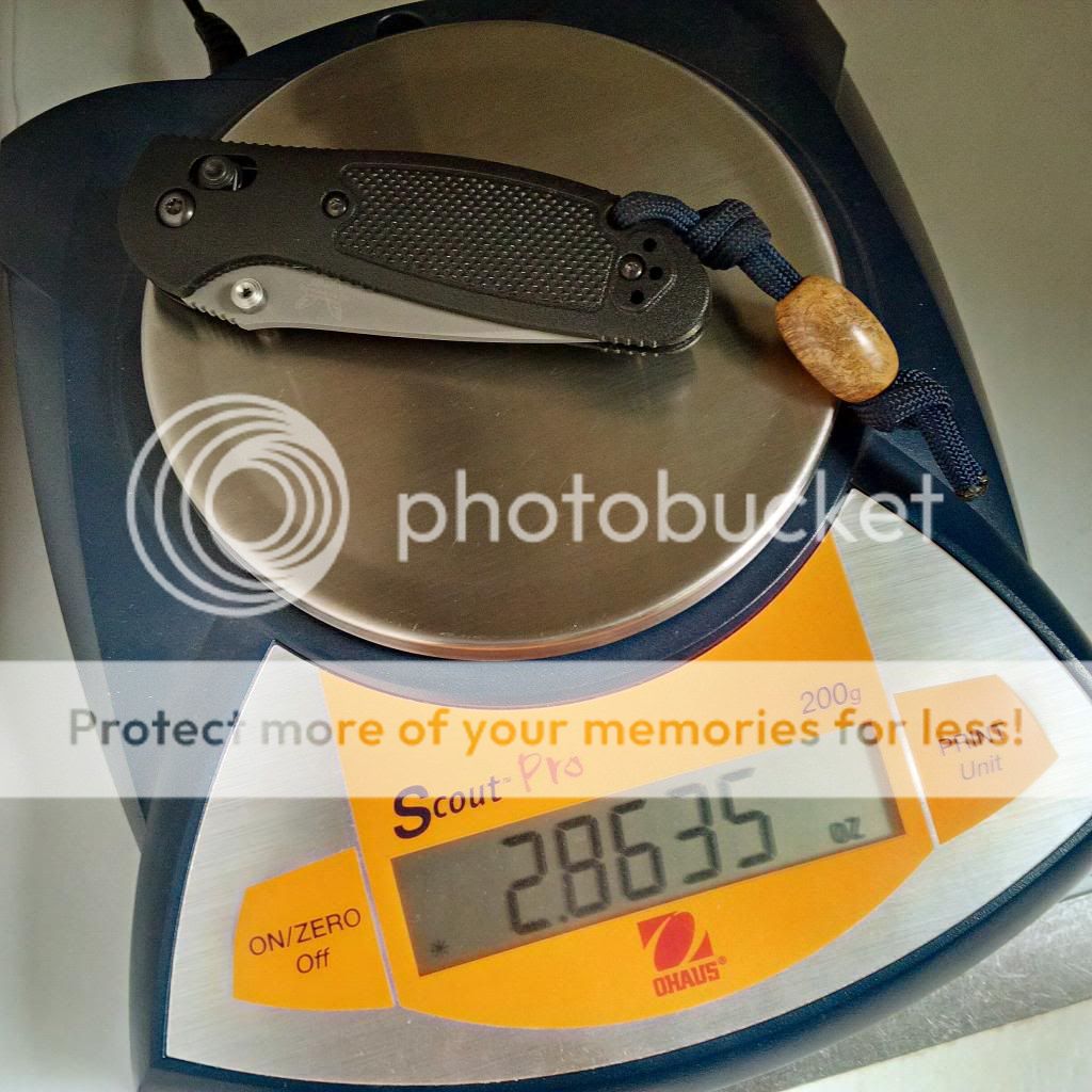

Once I got used to the three finger grip and added the lanyard with bead for better security I have no complaints. I really like the lightweight feel too.
With that said, what can you tell me about those aftermarket grips? I just looked them up and I see they are an open back design? I do not prefer that for my knives as coins and such can hit the edge. I appreciate any further info you can give me on my options!
Weights would be a great additional bit of info.
