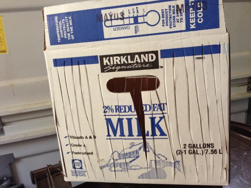

Hey David,
Here's my cardboard cutting media. Costco milk box that holds 2 gallons. I can usually get 55 - 60 cuts out of one box, and the cuts in the handle holes are shorter, the others are probably close to a foot long. So say I can cut 50 feet out of one box. I like these boxes because they are pretty consistent and clean. This box was cut by my Manix 2 S110V, and the before and after was almost unnoticeable. It would drag slightly when cutting newspaper after this box in a couple of spots on the blade, and it was cleanly slicing before the cardboard. It would still easily pop arm hair after the cardboard.
I would consider this excellent performance, one of these boxes will easily completely dull many knives such as a Mora or a knife in 420HC. I cut fast when doing this and the blade gets warm.
