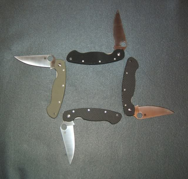

don't have enough for a circle, so i have tried other geometrical stuff
btw, nice pic, yablanowitz :thumbup:
