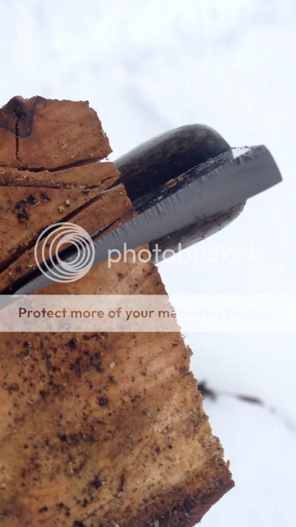

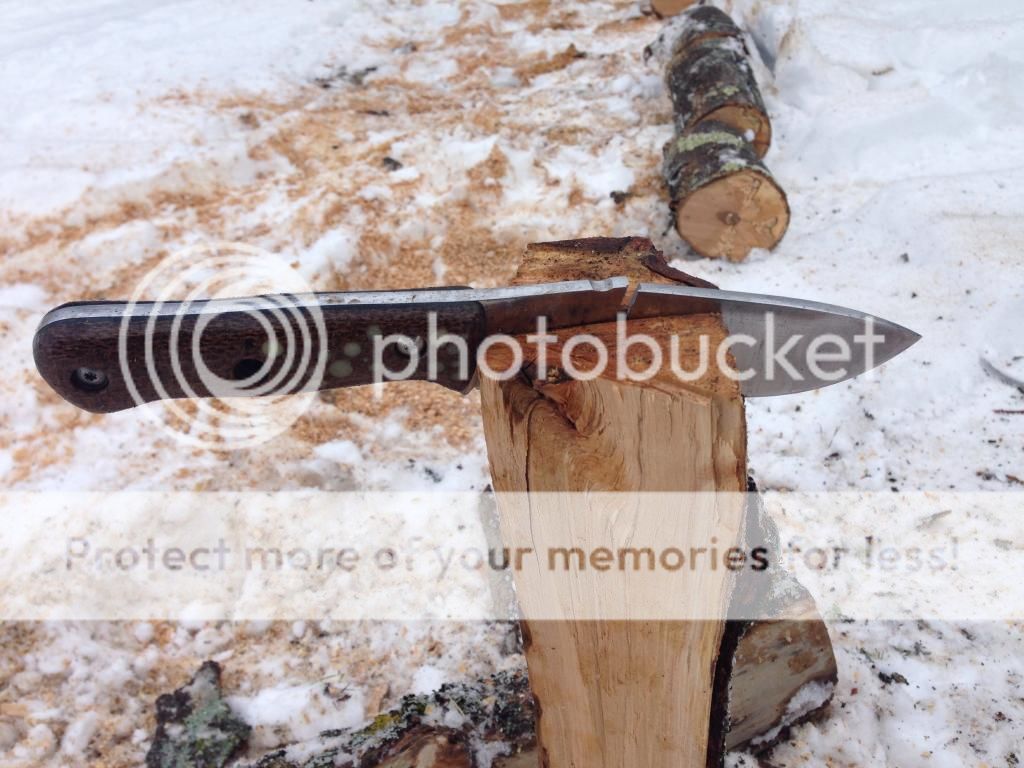

Looking for some feed back on CPM 3V vs 4V. I finished two knives so far in 3v with one being 62-63RC and the other being 61. They are both 3/16 survival knives which I have beat the snot out of so far. I did notice some very small chipping on the 62-63RC knife and none on the 61.
I understand I had the 62-63 done somewhat out of its desired hardness.
I have done some test flexing on both knives flexing them beyond 50'. Much farther then I ever would. I have read all that I seem to be able to find about both and talked to a rep from a steel company I have bought from but you get really bland non direct answers.
