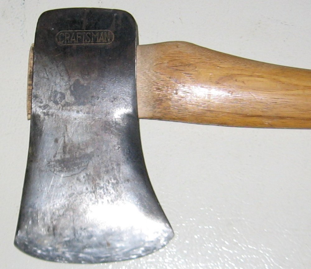

Next is a boys axe with a single oval stamp. I think this one might be from the 50's or 60's. This is one of my favorite axes.

Hey Peg...The boys axe in your third photo is a real beauty. Nice depth and very nice rounded poll. Very nice pattern indeed.
Don't even need to pick it up to know she would feel 'easy' to use.
Regards...Frank
Thanks, Frank. It's a sweety alright. I like it even better than my Collins boys axe. Very fresh and came with a great original handle, too.
