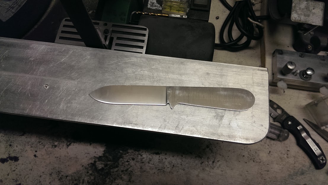

Took me forever to get this pic uploaded. I was fairly convinced that I couldn't get a flat grind using the little grinder, but with the machine dialed in I can.
The sawzall blade is just for reference.
A well set up 2" belt would be seriously sweet, but for now at least I know that I can get a flat grind with some effort.

With some care you can grind a decent blade with that grinder and I'm seeing people that actually prefer that machine for sharpening.
Though far from my best even in my short time at the hobby. This knife was ground on a HF 1x30.

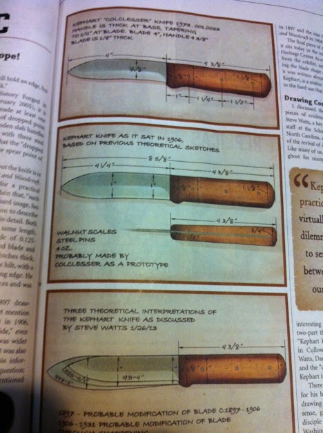

Looking back at your design and the criticism you got for the handle scales following the ricasso. I see now that you were following the Kephart design pretty close.

Personally, I think the Kephart blade style is pretty unattractive but after doing some studying recently, I think you've got a pretty good Kephart blade here. I can definitely see where some of what your getting criticism for here are actually design cues in a correct Kephart knife. Here is a picture my uncle sent me about Kephart knives.
