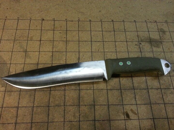

Here it is after HT, but still a little rough. It is a looooooooong and light convex grind with a blended plunge. Recurve 7" blade, olive micarta scales. I ended up ditching the GITD stuff in the hollow pins and going with a primitive finish. It is in 1075 and is differentially hardened. It swings very nicely with these dimensions...
I used hidden copper pins to offset weight as well, and to keep it nice and tight with the two hollow pins so close together.
Here it is mostly finished with the inlay sheath which is a high ride design.

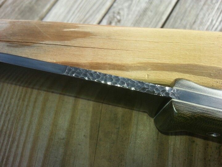

And a randomized section I did as a thumb 'anti-slip' area.
And here is how I did the handle area underside. I went with white spacers, however probably should have gone with something a bit more sedate...
Sorry if that hi-jacked your thread. I saw your other build, and I have done several that are similar. I made my own smaller bushy/camp knife a while ago and have been asked for that design more than anything else I do. I just hoped maybe since we seem to do the other design so similar maybe you could glean a little perspective from this one.
By the way, I sharpen that little inset at the end of the blade near the plunge as a little tooth to cut cord and whatnot. It has become almost a signature thing on my knives...
