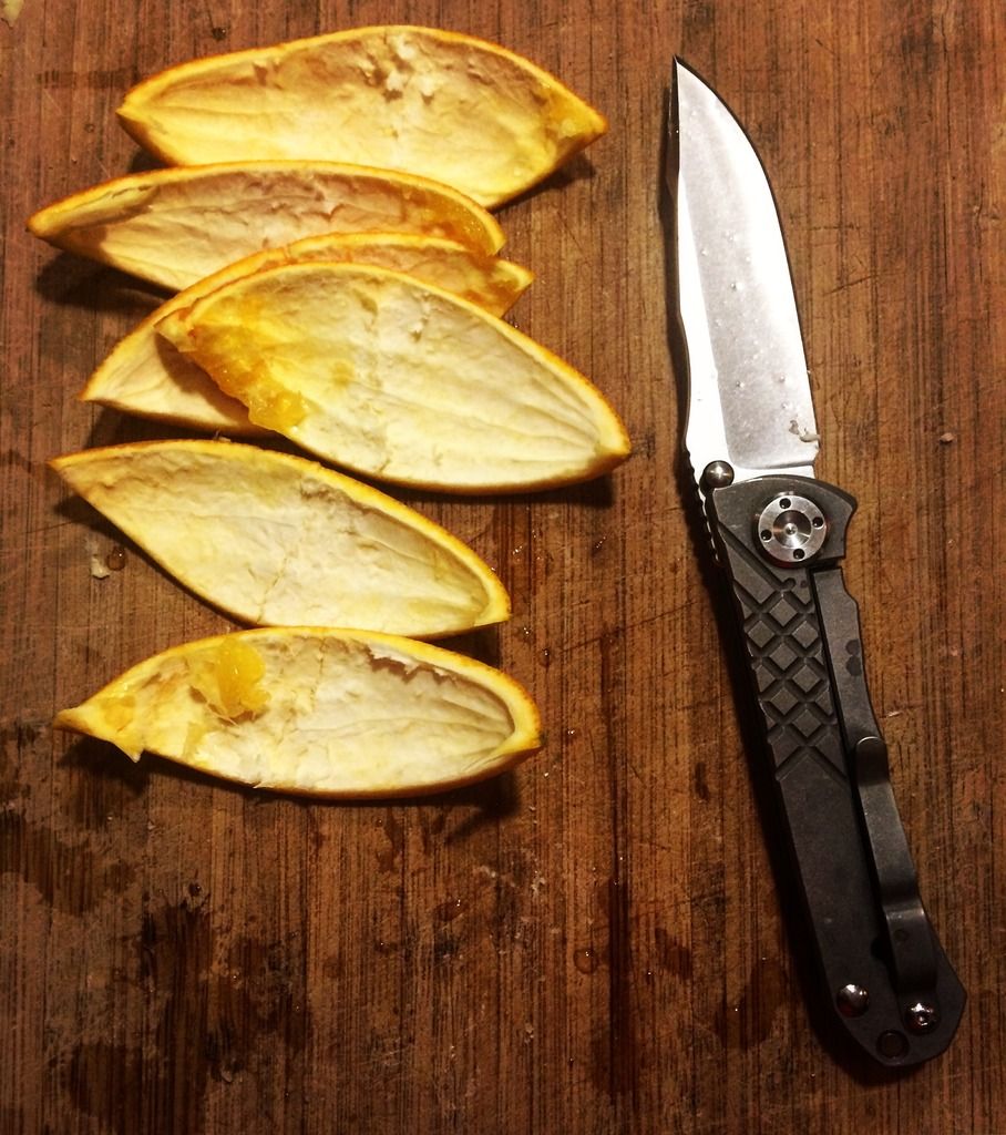

CRK Sebenza 25 pivot & and orange juice

From the same owner, a small Sebenza made in 2014.
Disassembled & cleaned for the last time in January 2016, and put together using 85 as well as 10 weight Nano-Oil.
Has been used to cut a lot of cardboard boxes as well as 5 oranges a day since then, and was rinsed afterwards under a hot tap, never disassembled.
Just took it apart for the first time again.
Corrosion on the pivot area of the blade is less than on the Sebenza 25, but the bushing has suffered quite a lot.
(pics can be clicked 2 x for a bit more detail)

Holy Smokes! No more nano oil! It's not doing it's job.
We recommend using our specially formulated Fluorinated Grease or a high quality gun oil to lubricate the pivot - you should only need a drop or two.
straight from ChrisReeve.com.
I don't think it matters too much which you use. I think the knives were subjected to A LOT of OJ, that's why they got as bad as they did. 5 oranges a day for a year is like 1825 oranges! That's a lot of juice! The grease would have resisted being washed out under the hot tap better I'd think though, so there's that :)

When contacted CRK about maintenance, I asked about oil and was told it could be used, but grease was better due to its protection of the pivot from oxidation.
No worries about this bad-boy today. Quick rinse in the sink and Christolube in the pivot. All good!
I am wondering what can be done to the rust, as it will continue to develop. Should one actually perform "passivation"?

I meant the rust, which has already been developed like in the OP's case.
I would agree that grease slows down further growth of rust by limiting oxidation. But it wouldn't stop the process.
I was thinking if the rusted part of the steel should be treated with citric acid or nitric acid to remove free Fe and for reformation of the "stainless" chromium oxide layer.

soak the blade in kerosene overnight... clean effected areas with fine steel wool if need be... clean and coat with good gun oil "rem oil" for example, wipe clean... apply fluro grease to appropriate pivot area, bushings, reassemble ...
