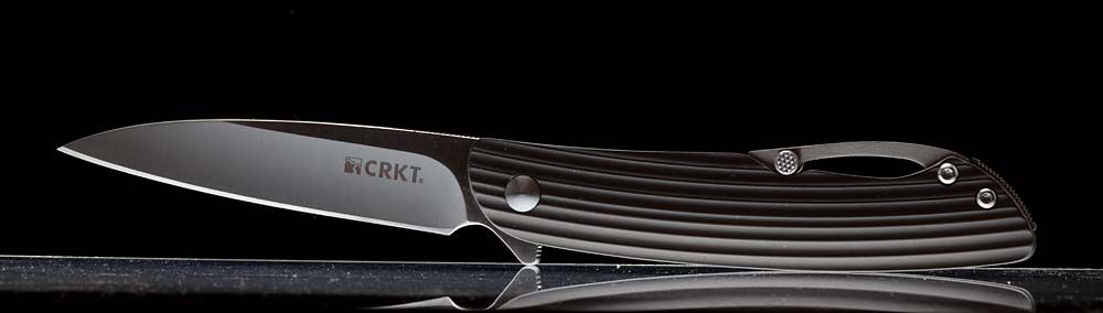

It is a narrow blade, as you can see from the photos, and is totally enclosed by the handle, so it seems strange to grab the knife and try to pull the blade out...but ya can't, as it's down into the handle. Only by using the flipper can you get the blade to come out. And speaking of the flipper, this feels like the flipper is loaded or has some tension applied, possibly the detent ball is deep in the hole in the blade, but that aids in the opening, once you overcome this load the blade comes out quickly due to the IKBS bearings inside, now, it has the IKBS logo but doesn't say IKBS, although most sites will credit it as being from them. In any case, it is SMOOTH, very very smooth. Lockup is solid once open with the integral lock bar. There isn't any blade play whatsoever. Unlocking works well and closing the blade is also just as smooth. I tried making the blade to pop open using inertia of my knife hand's wrist against my other arm, holding the knife and swinging my arm down against my other arm to stop it and see if the blade would come free of the detent, it didn't, that's a good thing.
Now this is noted as a gentleman's folder and I would say that would be about it, not a survival knife or wilderness knife or a heavy hard use knife. My concern for that is, when open the only thing keeping the blade in it's place is the steel lockbar against the tang of the blade. There isn't any stop pin on the back side of the blade, so when you apply pressure with the edge against material, you are pushing on that lockbar, a strong forceful cutting action might cause some deformation of that, but that is pure speculation on my part as I've not tried to press the blade or my luck that far. Suffice to say that this WILL cut material and she was quite sharp on arrival, but of course she's a bit sharper now and cuts quite well through cardboard, leather, and the few remaining scraggly hairs on my left arm.
Here are some photos taken tonight, pardon the dust, winter is a very static time and dust just attracts itself too easily, but you'll get the idea.
Interestingly the knife is held together at the pivot point and at the clip mount, no other mounting hardware on this folder.
Swindle_open.jpg~original
here you can see how neatly they cut the lock bar on the scale, it is important to remember NOT to be gripping the lock bar when you are trying to open the knife, as you are compressing the detent stronger so it makes it very difficult to open the knife, if you drop your fingers below the line of the lock bar, you'll find it will open much easier.
Swindle_lock_side.jpg~original

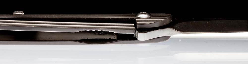

Lockup is very good
Swindle_Lockup.jpg~original

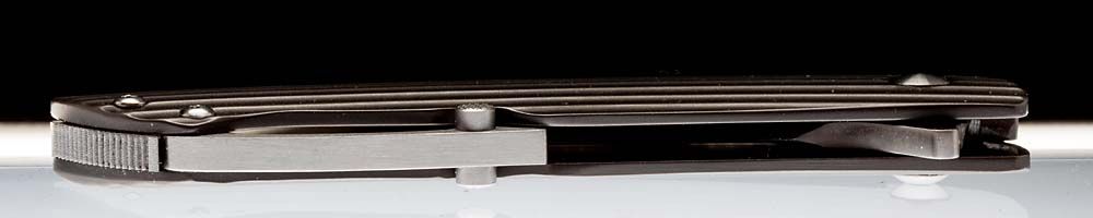

The pocket clip, it is spring loaded from the spine of the handle, unusual but works ok, in the pocket it appears almost like a pen, the retention in the pocket isn't very strong but the weight helps to keep it in place
Swindle_clip.jpg~original

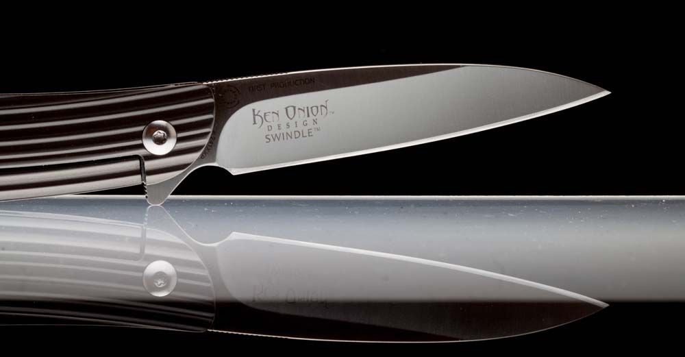

Nice blade shape, very pointy, not one you would pry with but not too delicate either, about right
Swindle_Blade.jpg~original
