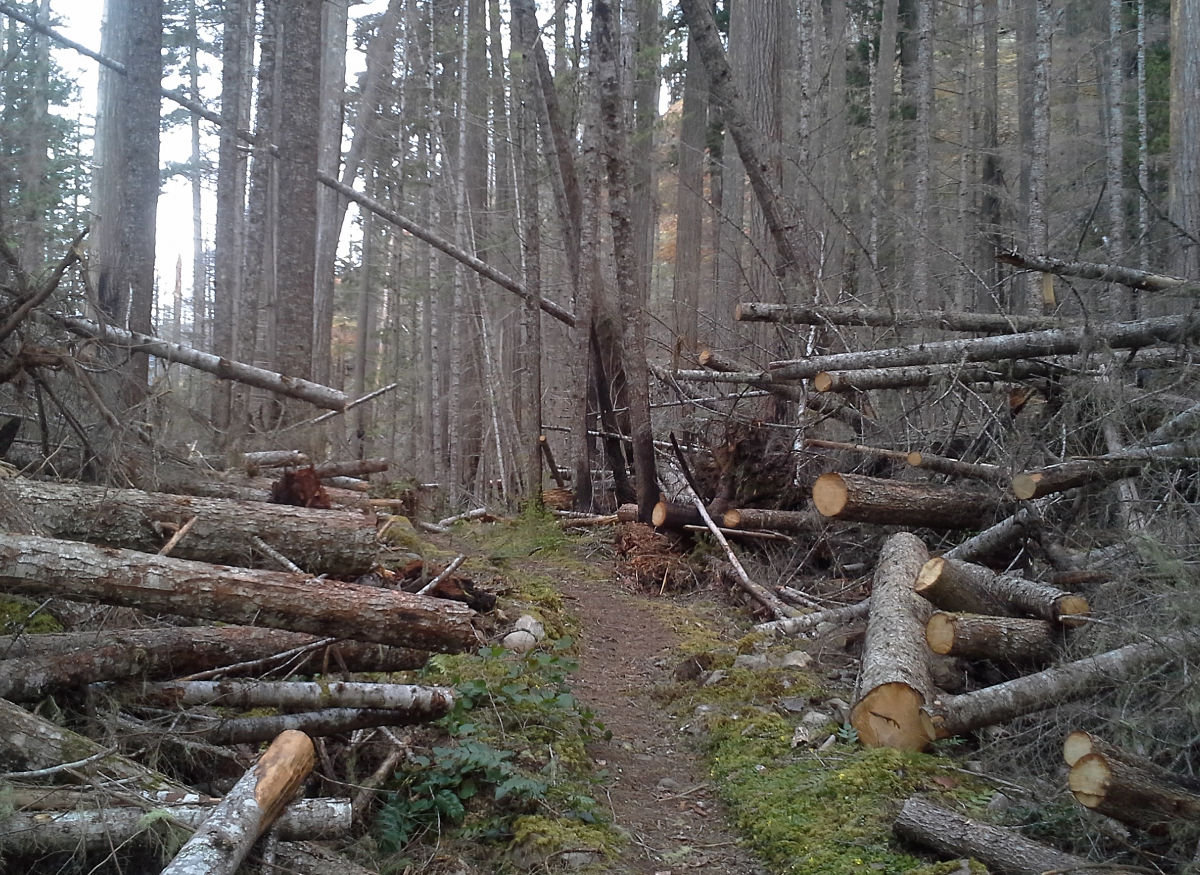

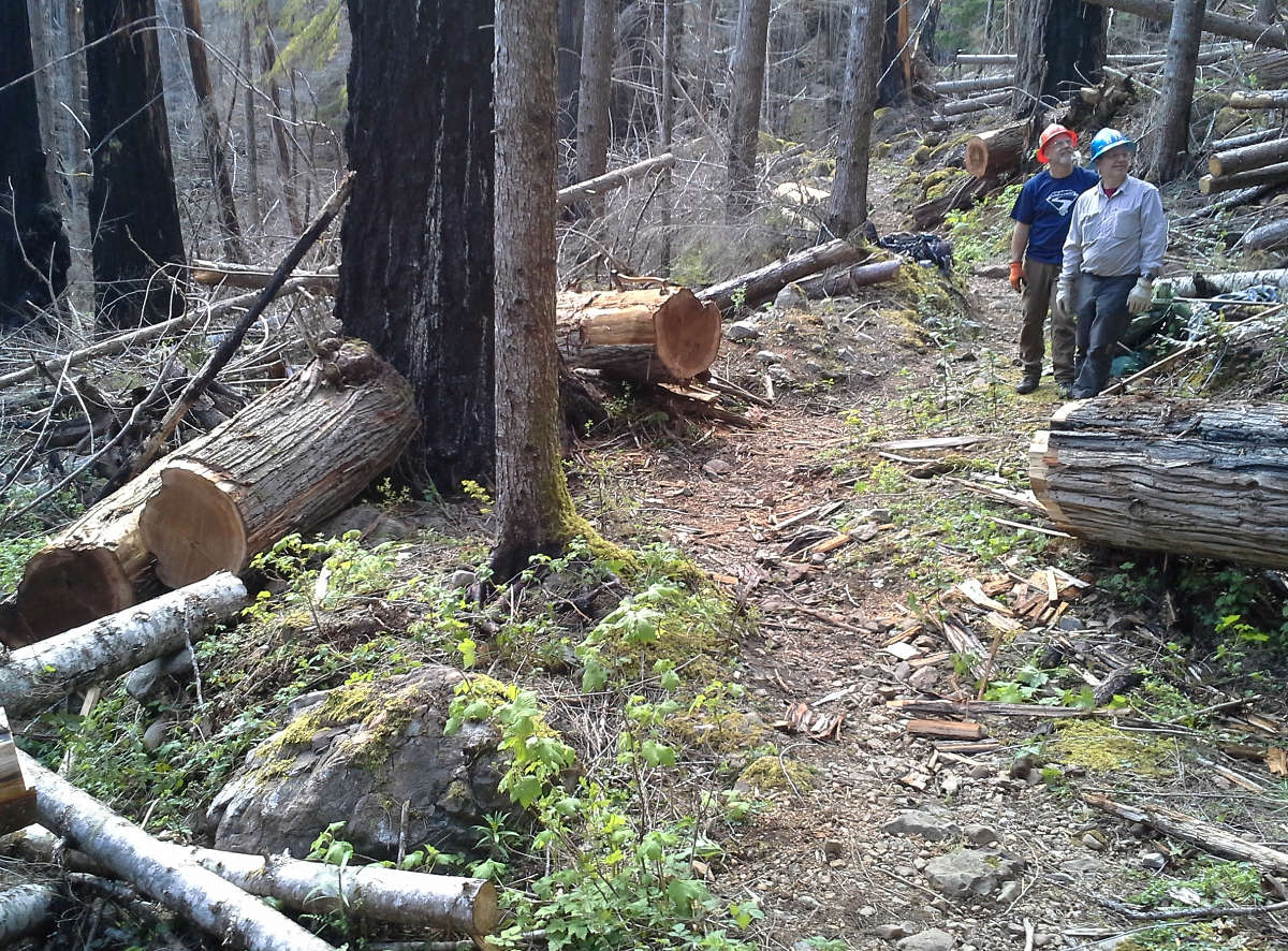

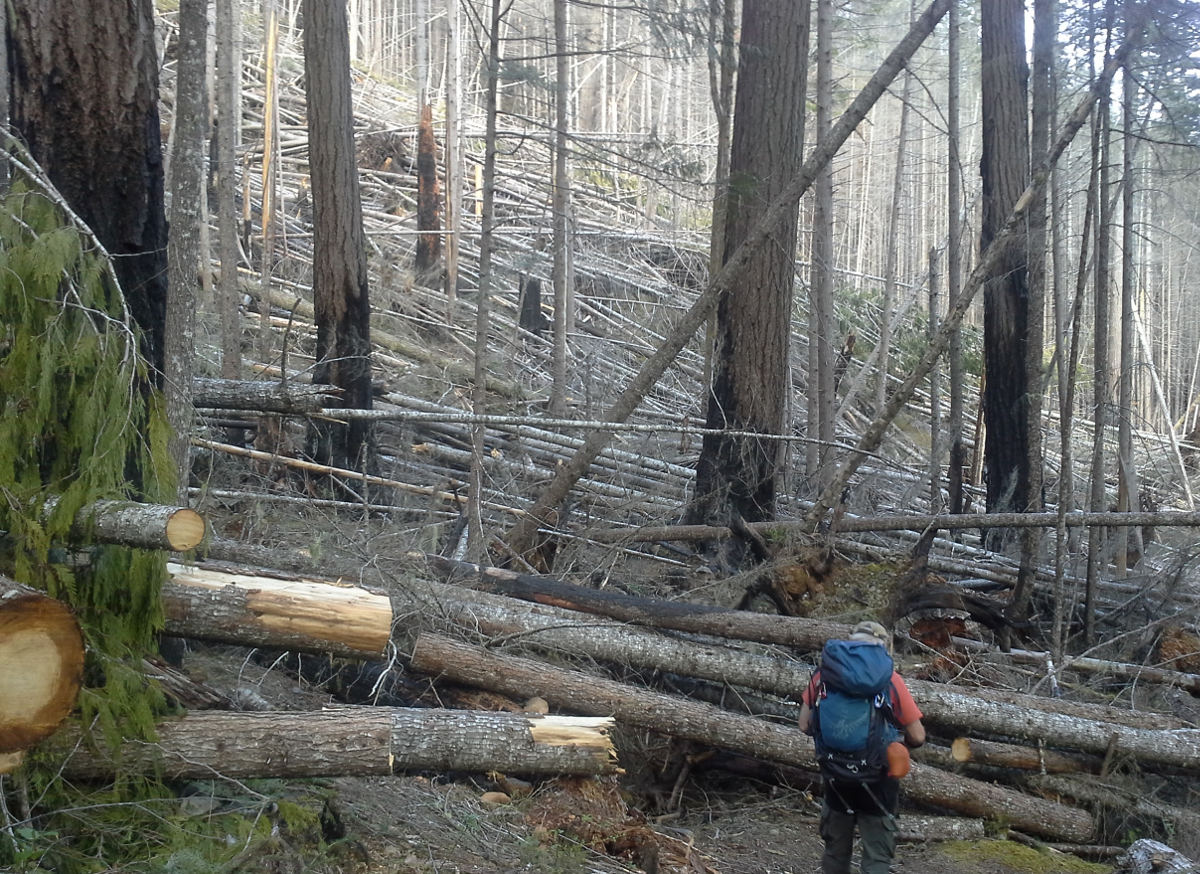

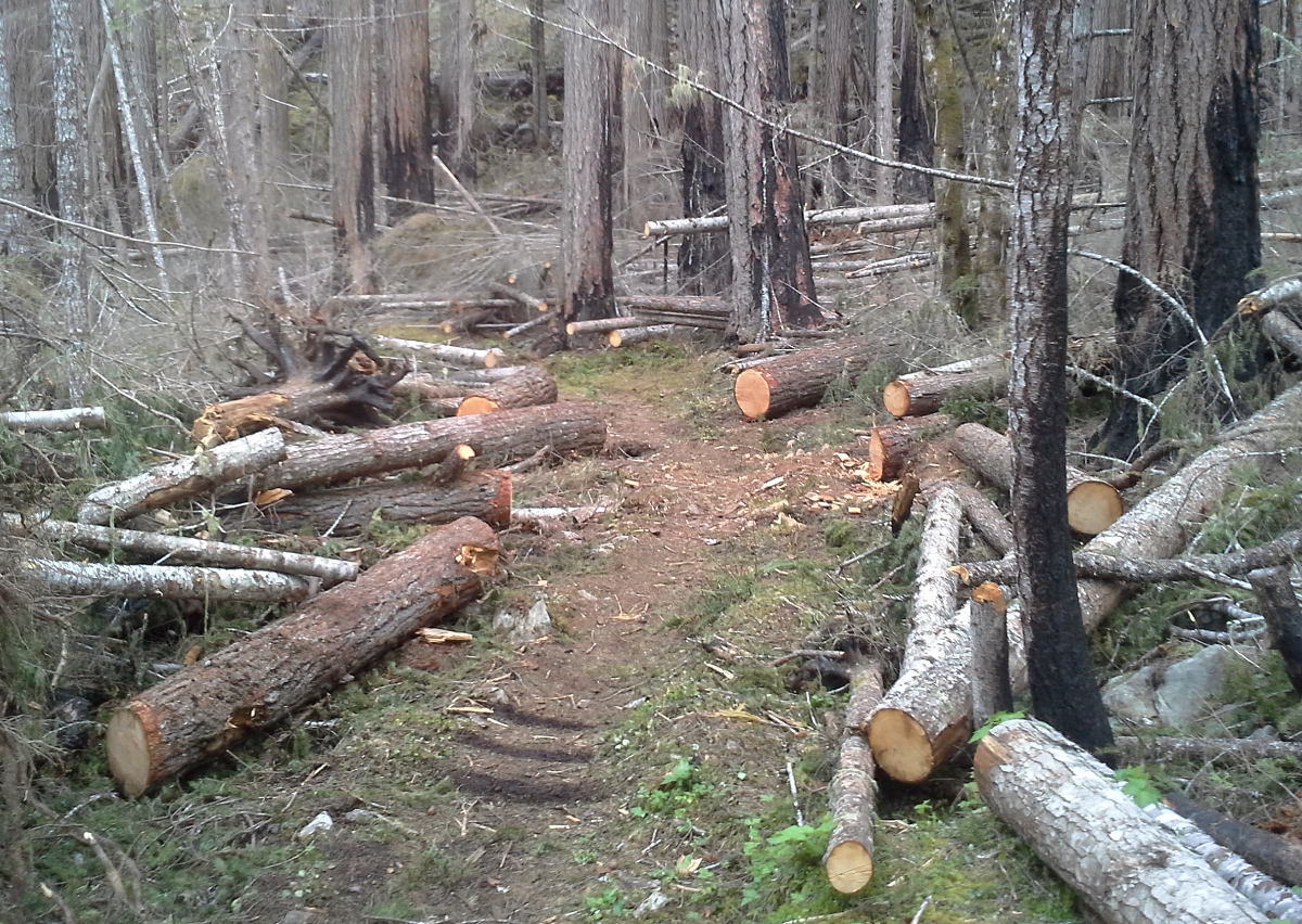

I got some crosscut time in last week. I was doing trail work in an area where we had a fire a couple years ago. The trees are coming down in droves. It reminded us of the Mt. St. Helens blowdown. We hiked in and set up camp. The work was on a ridge 900' above camp. So first thing every morning started with a little hike. We spent 4 days and 3 nights out there.
There are hundreds of trees across the trail. And because it's a wilderness area there are no combustion engines (chainsaws) allowed. It's all being bucked by hand with crosscut saws.

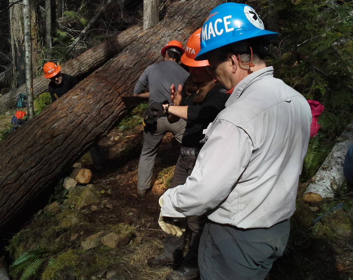

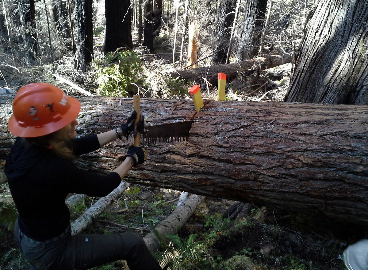

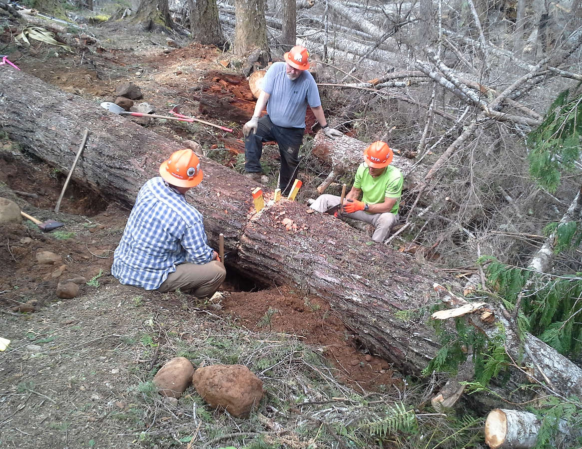

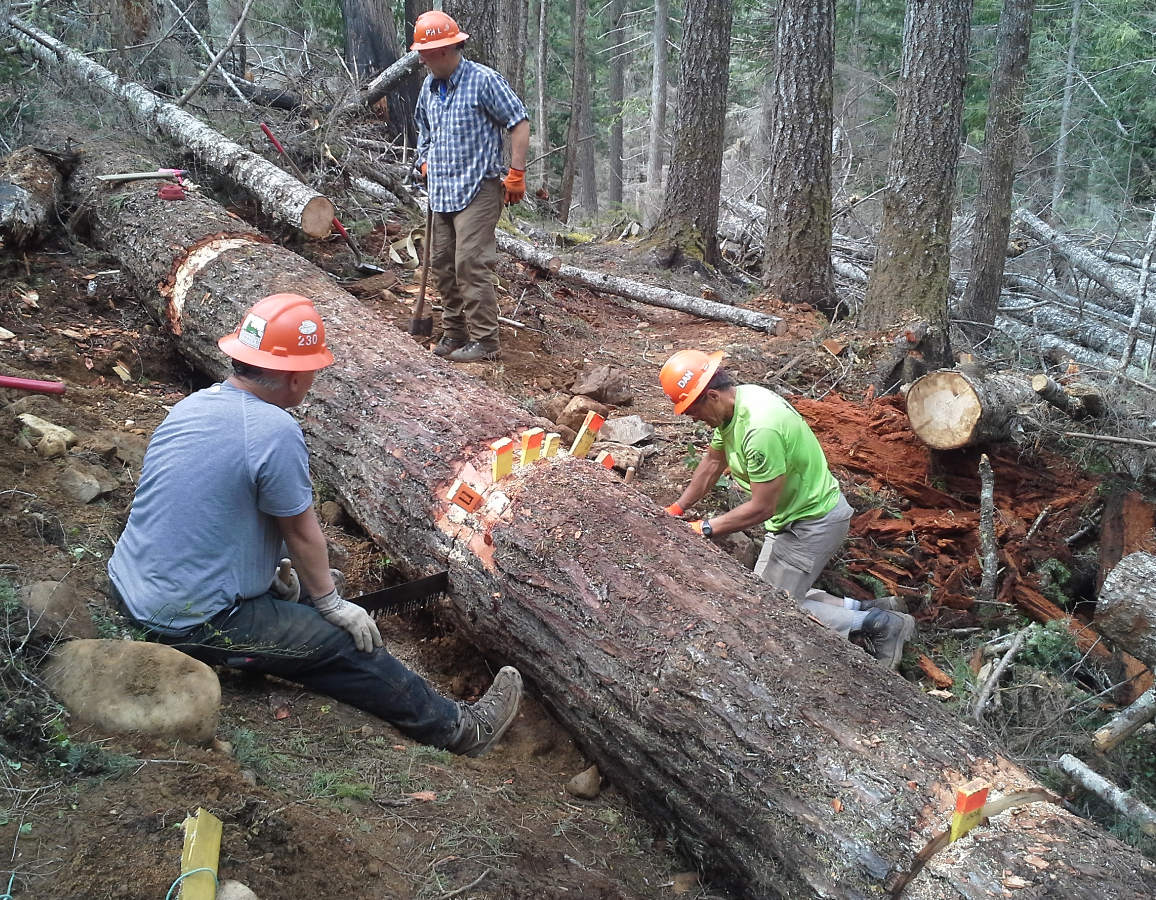

Sometimes we had to dig them out to make space for our saws. It often took multiple cuts to clear a tree from the trail.
One big Doug Fir fell so it crossed the switchback trail 3 times. Plus its root ball fell on the trail. We had to buck that one 7 times to clear it.
[video]http://cedarriverforge.com/Photo-index/Duckabush/Bucking1.mp4[/video]
This one went perfectly. I happened to be pulling the saw when it finished but the whole 4-man crew cut it and set up the rails to clear it from the trail.

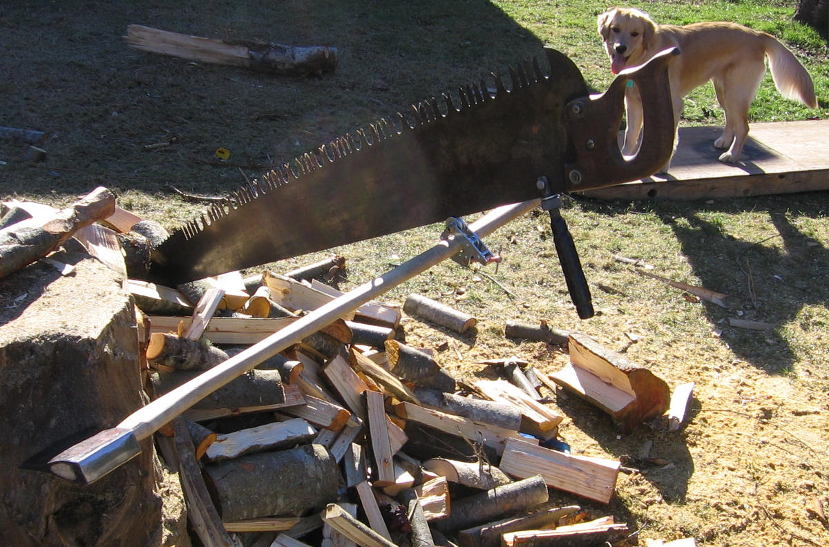

Here's a pic of the underbucking tool at use. Very useful tool for logs suspended across the trail. A suspended log will quickly bind the saw if you cut from the top. But if you cut from the bottom the kerf opens up. This tool makes cutting from the bottom easier.

That's quite a tangle there. I noticed a Griphoist in the opening pic. Did you use it on the rootball? Big crews have extra hands for extra tools.
Good eye, Trailtime.
Ended up not using the Griphoist on this trip. Never got to pulling that root ball. But there's another crew going in next week to pick up where we left off.

Have you ever used wedges to lift a tree off the ground instead of digging under it? If the BD's not too big you can stack and pound wedges from both sides of the tree and it will lift the whole tree off the ground, leaving you airspace to saw, especially if you start a kerf and wedge in above it. The log will want to lift naturally from the top wedging and will be assisted from the bottom by the under wedging. Of course it helps to have a big crew and lots of wedges on hand to make this work.

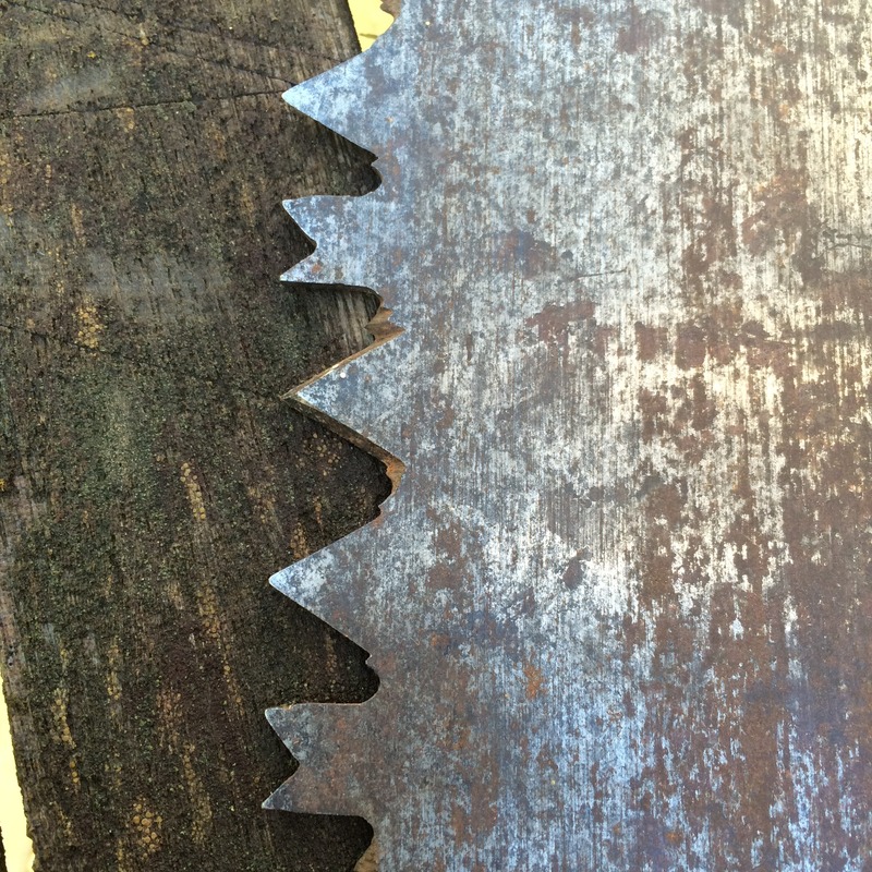

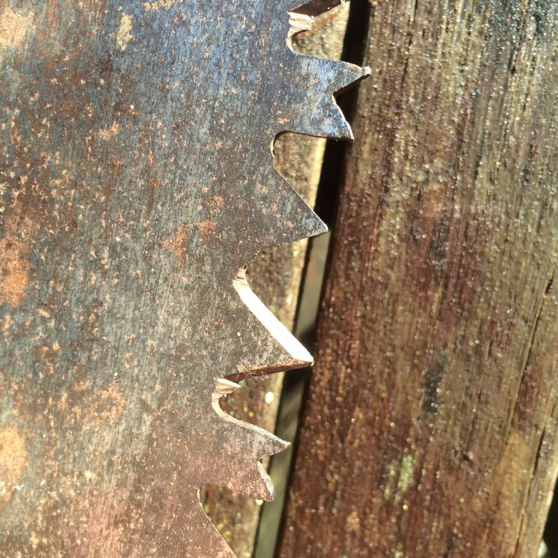

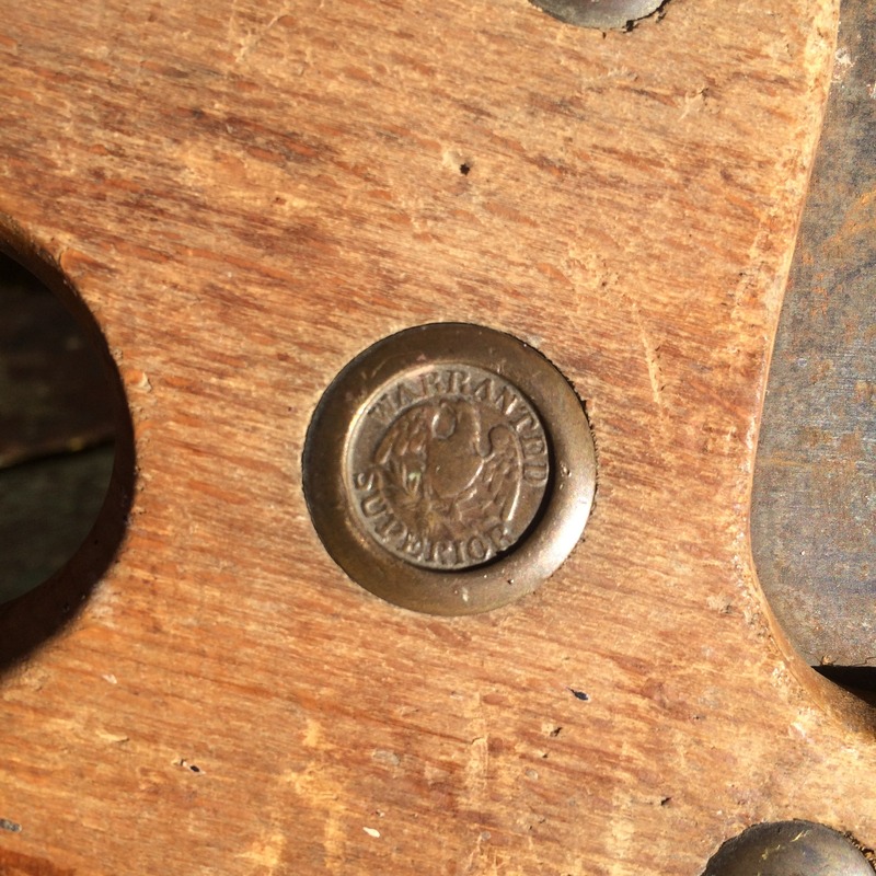

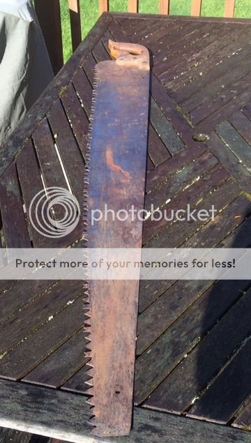

This is the one that I've ended up with recently. The handle is solid and the hardware doesn't look like it was molested too much (relatively clean screws), it is straight without dents, and it's nice and rusty.... I mean it seems to have a nice patina. Blade is 48" - 53" overall. Handle holes in the blade are all intact without obvious use or the handles were sized right/tightened if used. Maybe a little worm activity at one time?
Since we have some experts here, I was hoping to find out some basic information on this one or on them in general.
1. The tooth pattern is... champion? Is this a really worn saw or is it close to what it should be?
2. By outward appearances, does it look usable?
3. Does it look like someone did a hasty or inexperienced sharpening job on it? There are some pretty sharp "points" in the drops next to the rakers and it looks like that between almost all of them. Might be the tooth pattern but I don't know them well-enough yet.
3. What do you do to clean the blade up/remove rust?
4. Given the tooth pattern, what would I be cutting with this old gal?
It certainly doesn't look like some of the beauties I see on here so I'm kind of looking at this one as a "get to know ya" saw for the experience. Really want to learn to properly set and sharpen them so I am not super concerned about the $26 I have into it so far.
Don't have a saw vice or setting tool yet - some advice on those would be great as well. If anyone has a helper handle they just don't know what to do with...:D
Use all the saw-specific jargon you need to.:)
There is a place nearby that has racks of used, one and two-man blades so if this ends up being a dog, what I learn from this one will just refine what I am looking for.
The steel looks pretty clean but the saw has been "lazy filed". That's my term for filers who don't lower the gullets and let the teeth and rakers get squatty. You could bring it back to life with a couple 1/4" round files to deepen the gullets and a combination jointer/raker gauge to true it up. You're looking at at least a full weekend's work to re-profile the saw teeth back to their original shape and then you can begin the actual pointing and setting. Got some time on your hands?
