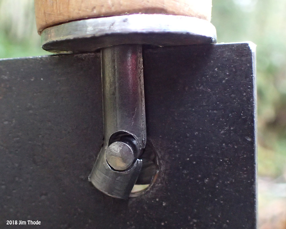

Using Trailtime's example - A new supplemental handle. The only hickory I had around was an old Model T Ford wheel spoke (about 1925 model year car). I used a cross dowel barrel nut in the handle with one side exposed and contoured to the shape of the handle.
The parts:
The competed parts:
Done with more handle parts in the background:

Part of great engineering is keeping it simple. I like this a lot. At first I did a double take on using a vintage spoke but a quick google showed that they are readily available.
I like that thick washer. Where'd you get it?
I found the thick washer in my miscellaneous used washer container. I see that they can be bought on Ebay. Do a search for "3/8" x 1-1/4" OD Extra Thick .125 Zinc Plated Heavy Fender Washer".
One like this would probably be better if the correct size could be found:
Jim
Jim
An update, I was concerned about the small size in the area where the pin goes through the hole in the saw so I took it out and tested on a 5' saw. In normal use it would likely work fine and I was able to cut with just this supplemental handle on the saw. However to test it under maximum load I set the saw well in the kerf and reefed on the handle with both hands.
Not a big surprise, it failed at the pin. The pin held up well with no damage but the metal around it broke. I'd used an ungraded bolt for the main threaded pin so it was not as hard as could be.
So, back to the shop and I made a pin with a larger end as most vintage handles have. I used the same threaded part and fabricated and welded on the heavier end.
This is a 392 Simonds handle and the current version of my Model T spoke handle:
Jim

Jim - I had a similar failure with ungraded home-made bolts. One advantage to the pricey Flicker Forge bolts is the reinforced end.
