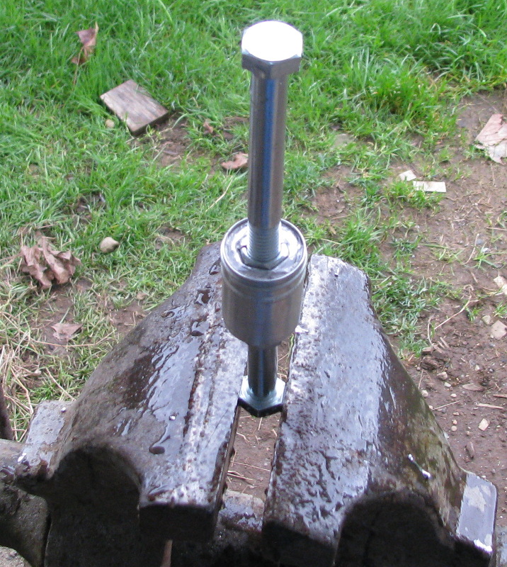

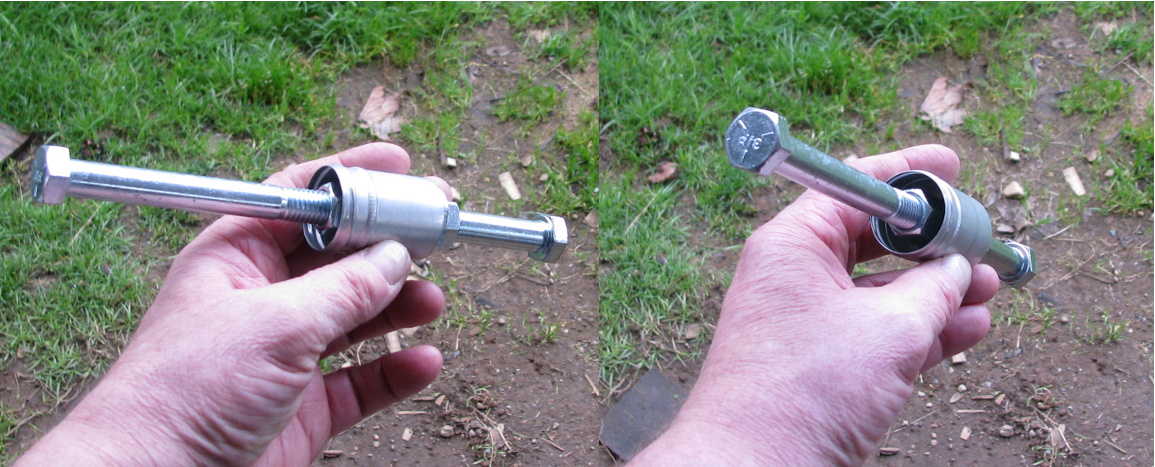

Here's what I was talking about when posted earlier about making a crosscut saw weight. It starts with an old aluminum film canister with a 1/2"-13 coupling nut mounted in it. A jam nut holds it together firmly. The lower bolt will be cut off and kerfed to slip onto the saw. The upper bolt is just to fill the coupling nut threads to protect them while casting the lead.

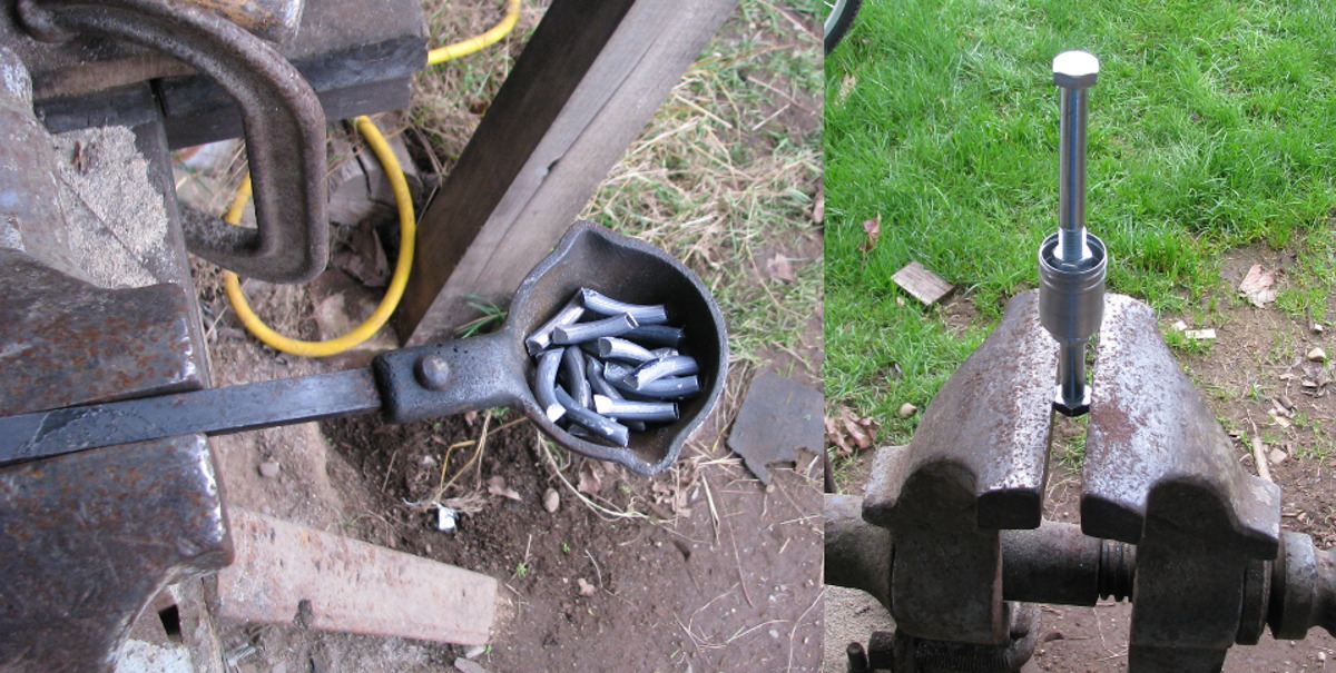

Chunks of steelhead fishing lead are melted and cast into the film canister.
After casting.

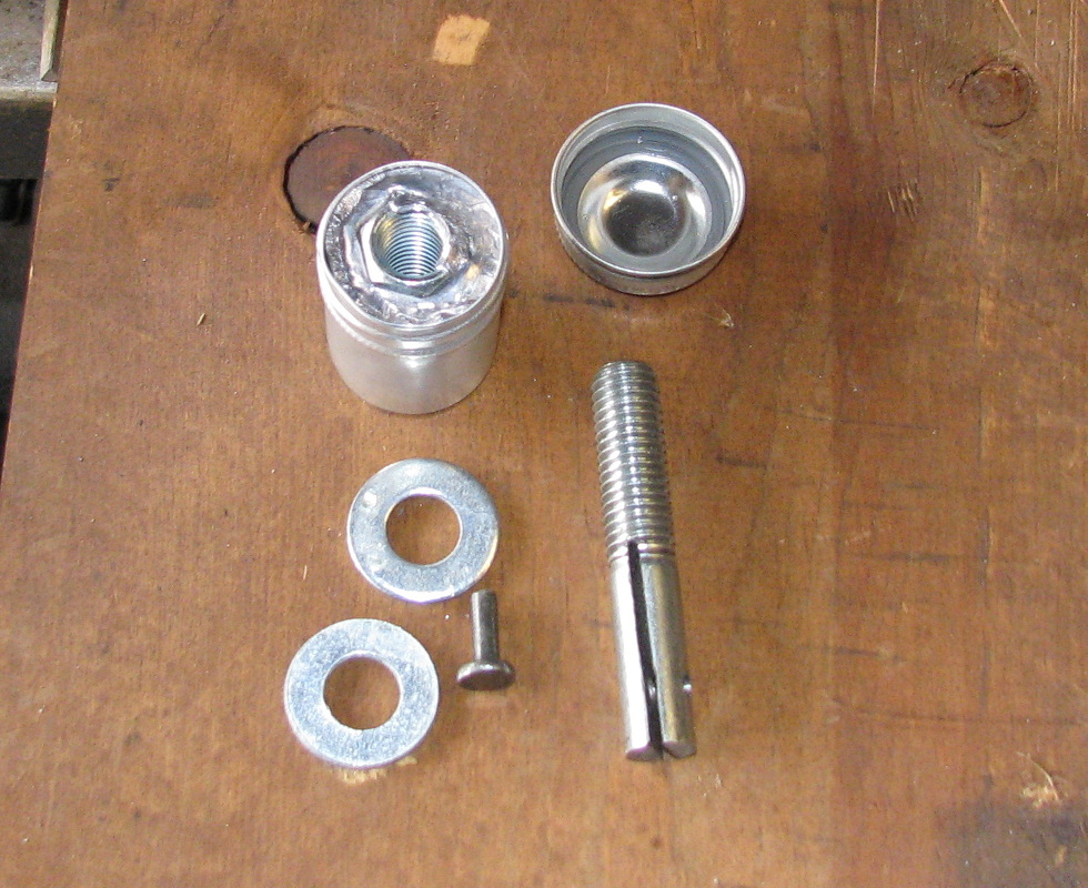

The parts. The lead-filled film canister and its lid, the cut-off half inch bolt, a 20D nail cut off and a couple 1/2" washers.

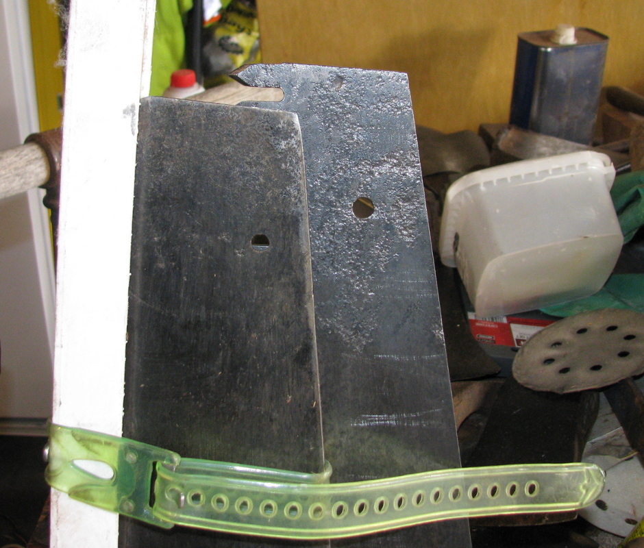

Some saws have supplementary handle holes lower than others. I made sure my weight would fit the deeper hole of my Disston 514 54" one man saw.

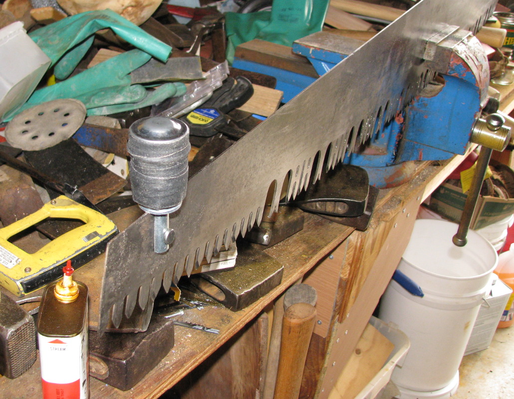

Here it is wrapped with friction tape and installed on the 54" Disston. Assembled and taped it came out to 374 grams. I think it will make a dramatic difference in how well the saw cuts. And it can quickly be removed when cutting larger logs.
