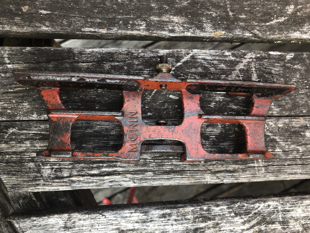

i think those black pads are to protect the teeth, if that's what you're refferring toI picked this Morin gauge, marked FEB 8, 1910:

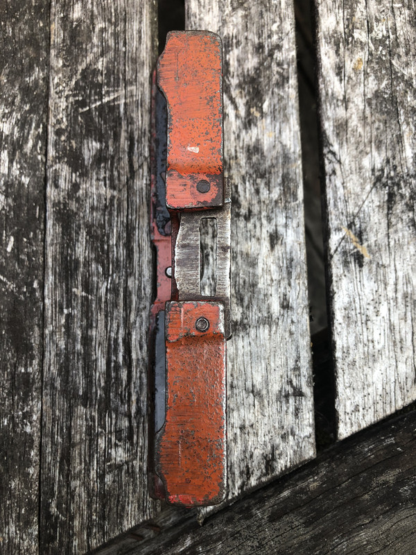

I notice here that there is a shim on one side and it’s missing on the other. I imagine this was user done? Would I be better served removing the existing shim and set it up with matching ones as opposed to trying to match the intact one? What depth would a guy want if any at all?
Also, any recommendations on removing the glue/epoxy completely?

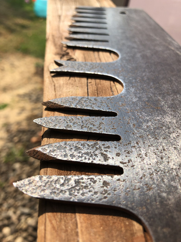

So i got to looking at one of my saws i kinda disregarded and i think it's a late Disston No.76.
The thing is it was a little warped so i tried to...
straighten it with a hammer.
you can see where this is going. Anybody here very competent in their skill with a saw anvil? i warn you it's pretty F.U.B.A.R
What I gather is it’s too easy to remove material and ruin the set?
