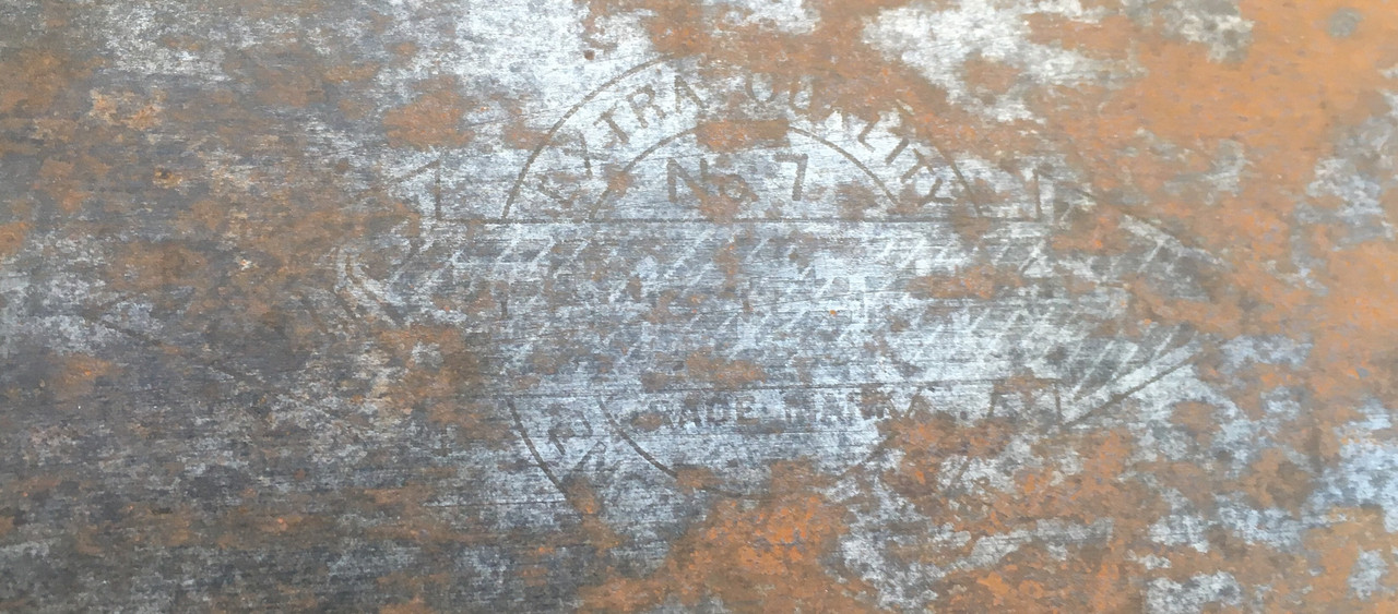

I was cleaning up this warranted superior saw this afternoon when I saw a circular etch on the plate and thought "Sweet, this might be a Disston or Atkins after all" A few strokes with a sanding block later and I saw an arrow. As it turns out the saw is an almost never used Stiletto rip saw. That surprise made my day. It's hard to read but in the arrow? it says STILETTO. Sorry for the wonky pic.
I actually know the locations of 2 stiletto hammers, a stiletto farriers rasp and a stiletto 4lb? double bit. All those are on my need to get radar. None of them are going anywhere fast though.

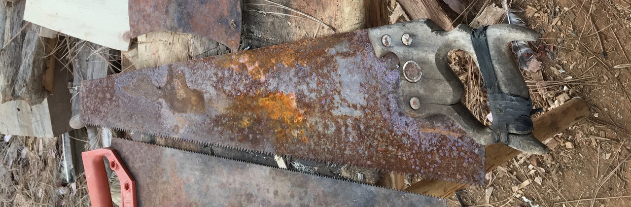

Does anybody know who made 2 man Craftsman cc saws over the years? There's a perf lance bucking locally, looks like 60", that's seen very little use. I imagine it was Atkins, Simonds, or Disston. But if anybody has some ideas or a way to ID the manufacturer I'd appreciate it! I'm trying to figure out whether it's worth picking up.

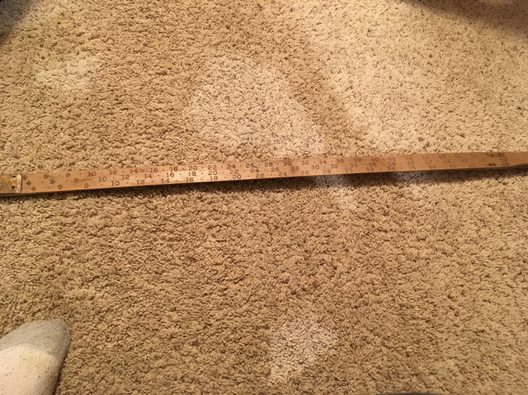

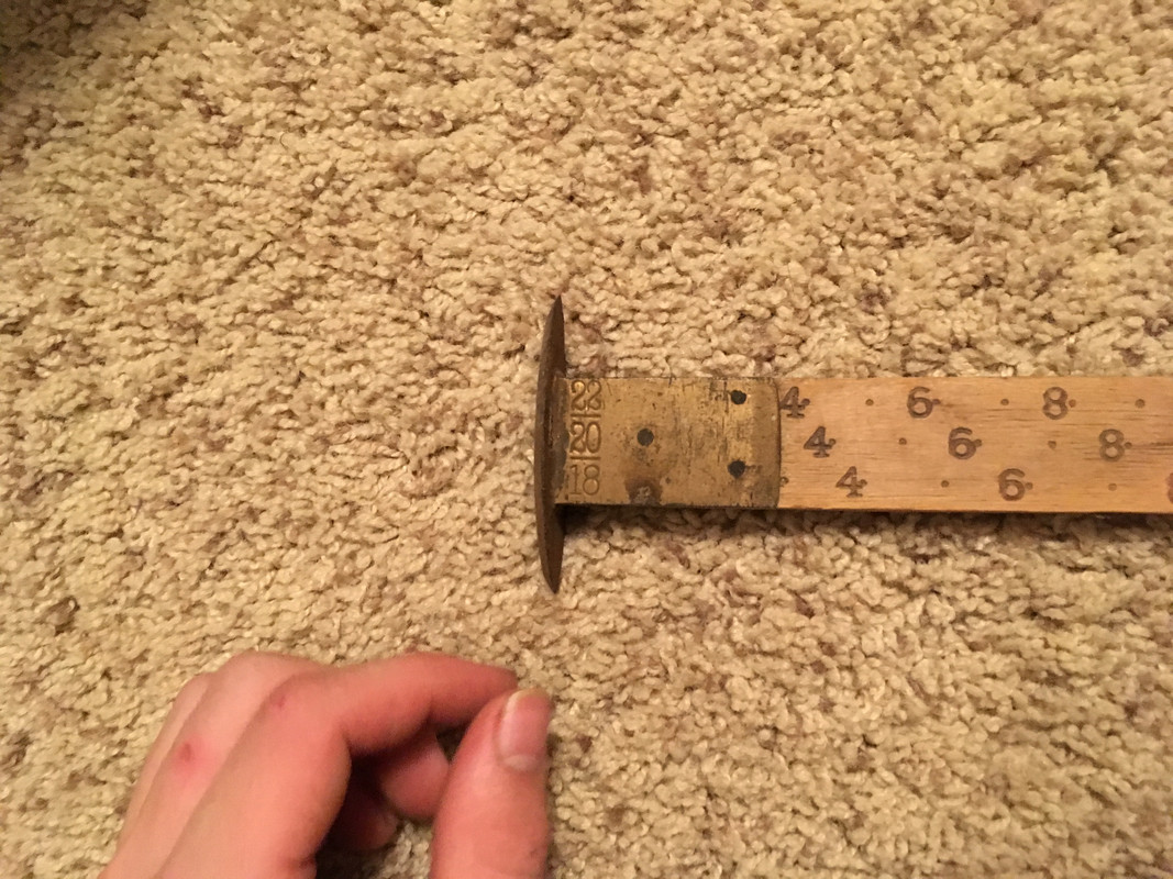

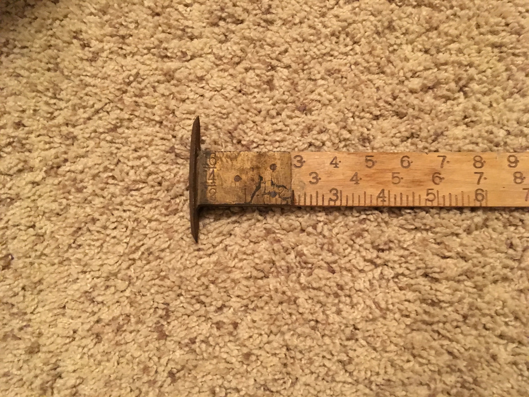

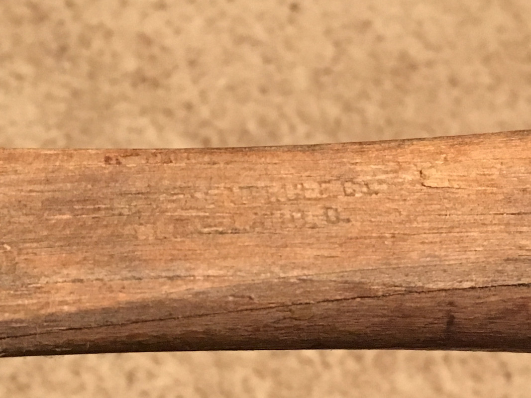

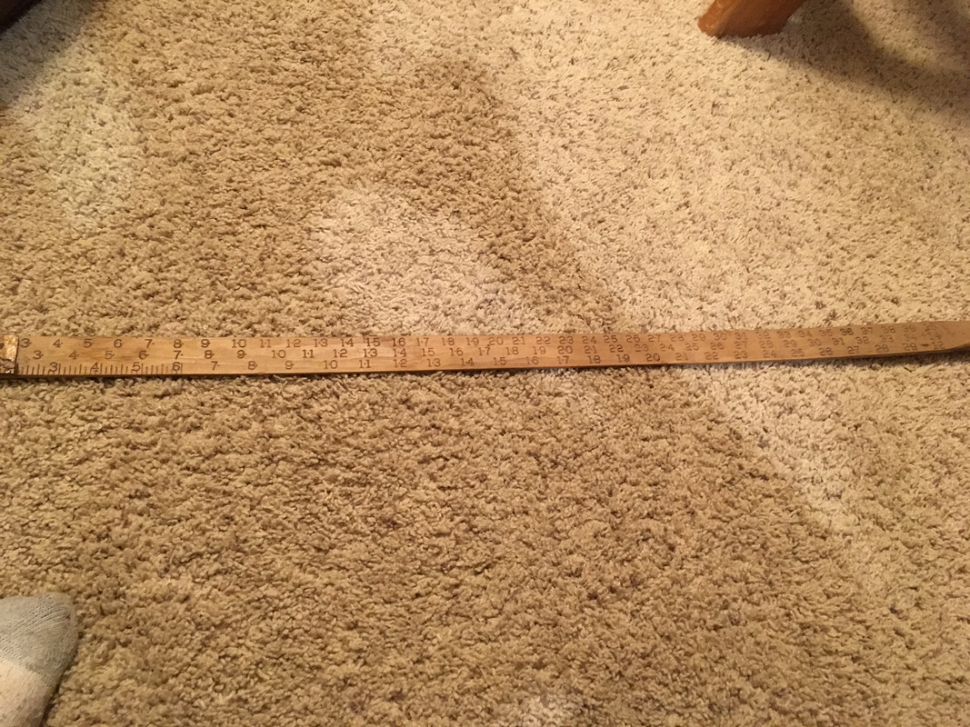

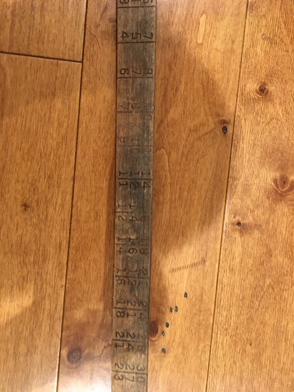

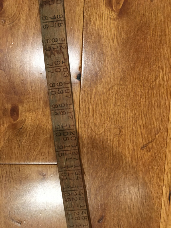

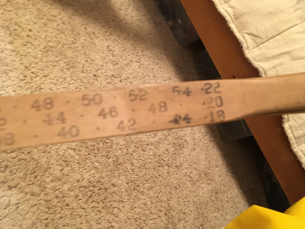

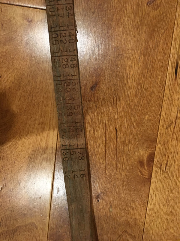

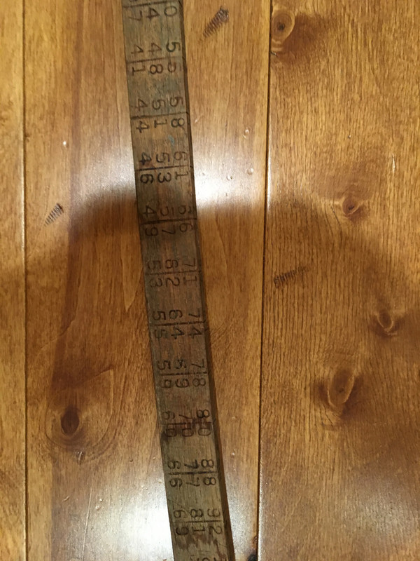

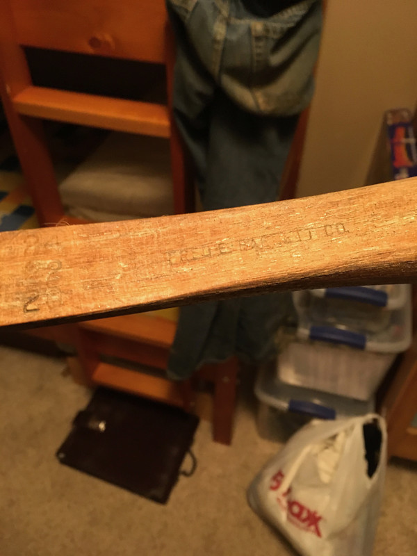

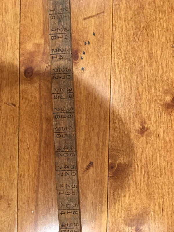

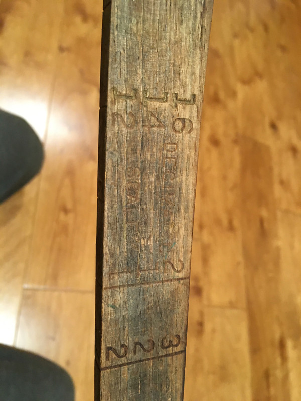

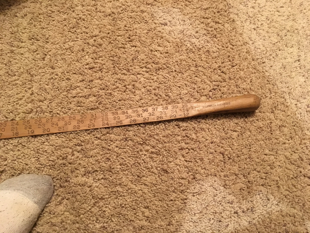

Anyone know what these are for? They were free and going to be left outside all winter so I snagged them. One of them is marked California Saw Co so I figured they were for something crosscut saw related. Better pics will come if requested.
That's a Biltmore stick. It's a timber cruisers tool, or log scalers.
You can use it to measure standing tree diameter, height, and scale logs.
The different log scales shown in the last page- Comparison Of Log Tables -lists all the different scales. The primary reason there were different scales was for different areas of the country. A lot of the reason they needed to be different was because different area forests had different species of trees. The uses of the scaling sticks was to tell the mill that was buying the logs how many board feet of lumber would come from each tree therefore how much the mill should pay the logger. Different species yielded different amounts of board footage. The two scales I ran into the most were Doyle's Scale with eastern hardwoods and Scribner scale in the western forests. A Biltmore stick is a timber cruisers tool used to estimate board footage when the tree is still standing.
That Stiletto clearly has a Disston D8 handle. Made by Disston for sure.
