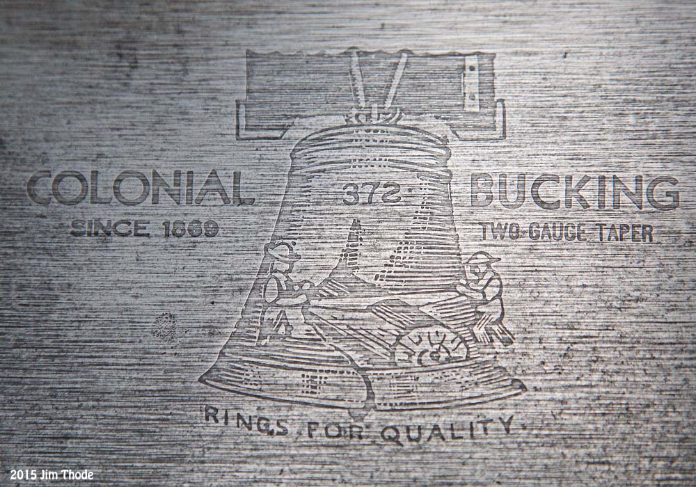

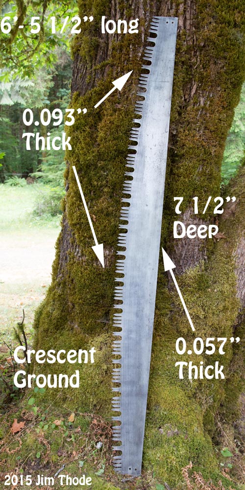

I have a quite nice and rare 6 1/2' Colonial bucking saw. I may sell it for the right price.

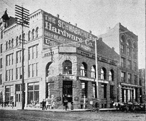

The three Schwabacher brothers’ only sister, Barbetta (Babette) Schwabacher (January 3, 1836 – January 7, 1908), married the brothers’ business associate Bailey Gatzert in 1861. The couple headed in 1869 for Seattle—then a town of barely 1,000 people—where Gatzert established a branch of Schwabacher Bros. & Company. Gatzert would go on to become Seattle’s first (and, as of 2009, only) Jewish mayor. Schwabacher Bros. & Company became Seattle’s first wholesaler, with a business opened October 11, 1869. Schwabachers’ 1872 Seattle shop at Front Street (now First Avenue South) and Yesler Way was the city’s first brick building. Under Gatzert’s direction, the company also constructed a warehouse, a grist mill, and Schwabacher’s Wharf.

Where was Schwabacher’s Hardware store located?

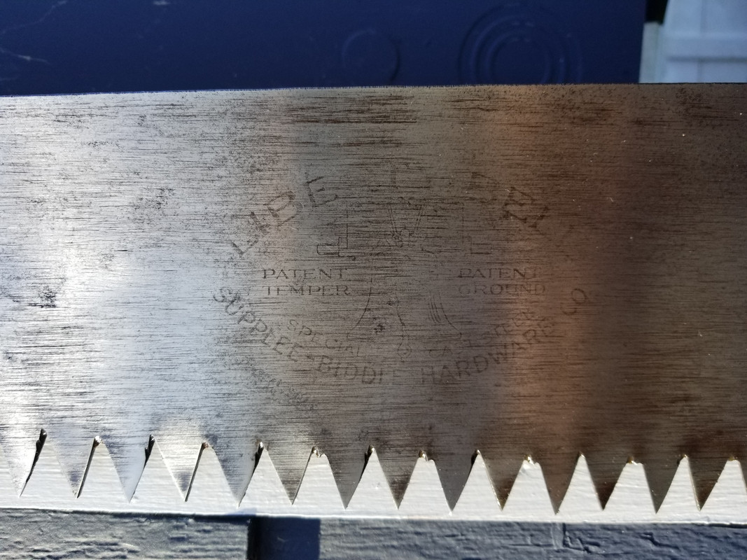

I have 2 supple biddle hardware store crosscuts but looking for one of their axes. They didnt produce the axe or saw, I believe Disston made the saws sold with the Supplee Biddle etch, I dont know who produced axes that are stamped supplee biddle.
The etch is faint on the 36" saw here but you can see the outline to the Liberty Bell, similar to the bell used in the Colonial stamp.

Wow! That is really cool! And thanks for pulling up the info on Schwabacher’s in Seattle.I have a quite nice and rare 6 1/2' Colonial bucking saw. I may sell it for the right price.

As I understand it Colonial was, according to info in the Axe Makers of North America book, a house brand of Schwabacher's hardware in Seattle. The 1869 date on the saw logo matches the opening of the Schwabacher's hardware store.Wow! That is really cool! And thanks for pulling up the info on Schwabacher’s in Seattle.
I’m curious though if that saw is actually Schwabacher’s “Colonial” brand? I know many companies made knock-off versions of other companies brands and I’m wondering if that Colonial Bucking saw was a different brand? It doesn’t quite look like the liberty bell design from Schwabacher's but it does have the “rings for quality” logo.
Nailed it! Well done sir!The 1869 date on the saw logo matches the opening of the Schwabacher's hardware store.
