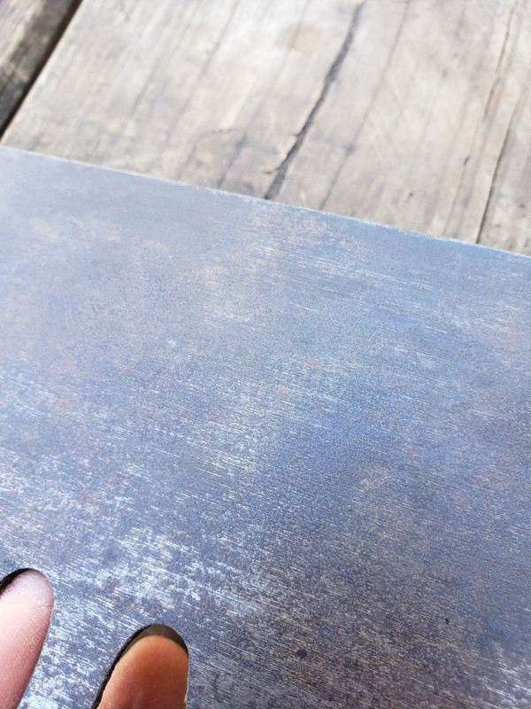

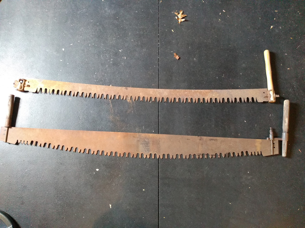

I took down and blocked up some trees for my uncle yesterday (with chainsaws) and I told him that I had just been certified on crosscut saws. He said that I should take the two old saws that he had hanging in his garage.

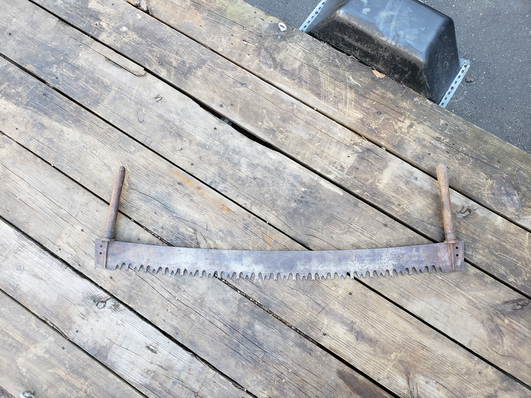

Here they are:
He said the narrow one which I believe is a champion tooth felling saw - was his father's (my grandfather - born 1907) and thought he bought it from LL Bean.
He also said that the wider saw which I believe is a champion tooth bucking saw - belonged to his grandfather (my great grandfather - born 1878) but he didn't know it's origin.
My uncle is 86 and remembers cutting wood with both his father and grandfather with both saws. Said his grandfather would yell at him for leaning into the saw too much.
The teeth on the bucking saw are all in really good shape - and may be a usable saw. However, there are some damaged teeth on the felling saw. both saws are about 6' long.
I have a couple questions.

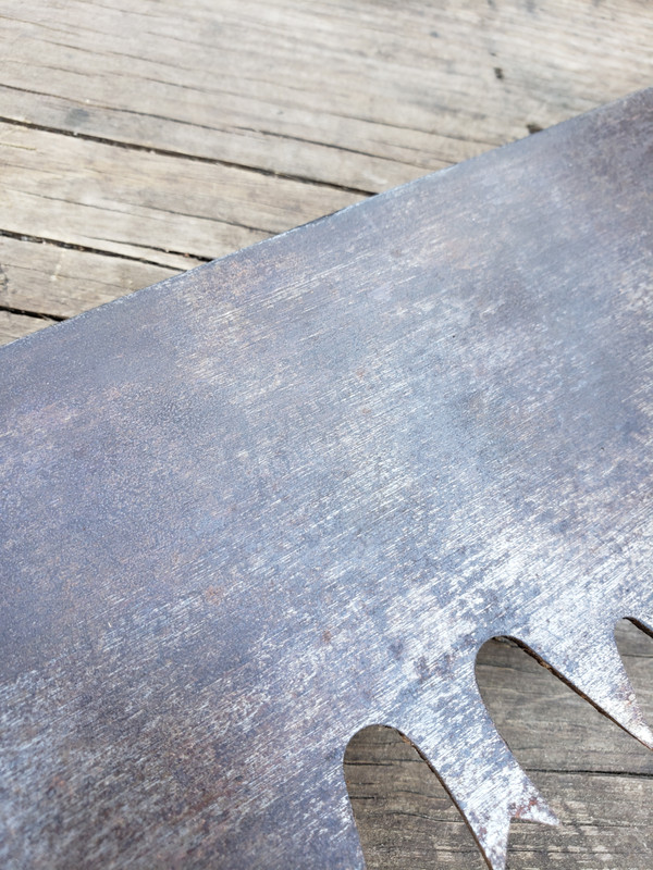

1. What is the best way to clean the rust from a saw? Can I use a wire wheel as I would with an axe? I'm not sure if there is an etch anywhere under the rust but I would like to preserve it if there is. Seems like a wire wheel would be better than sandpaper, but maybe not. Let me know the least damaging method of cleaning.

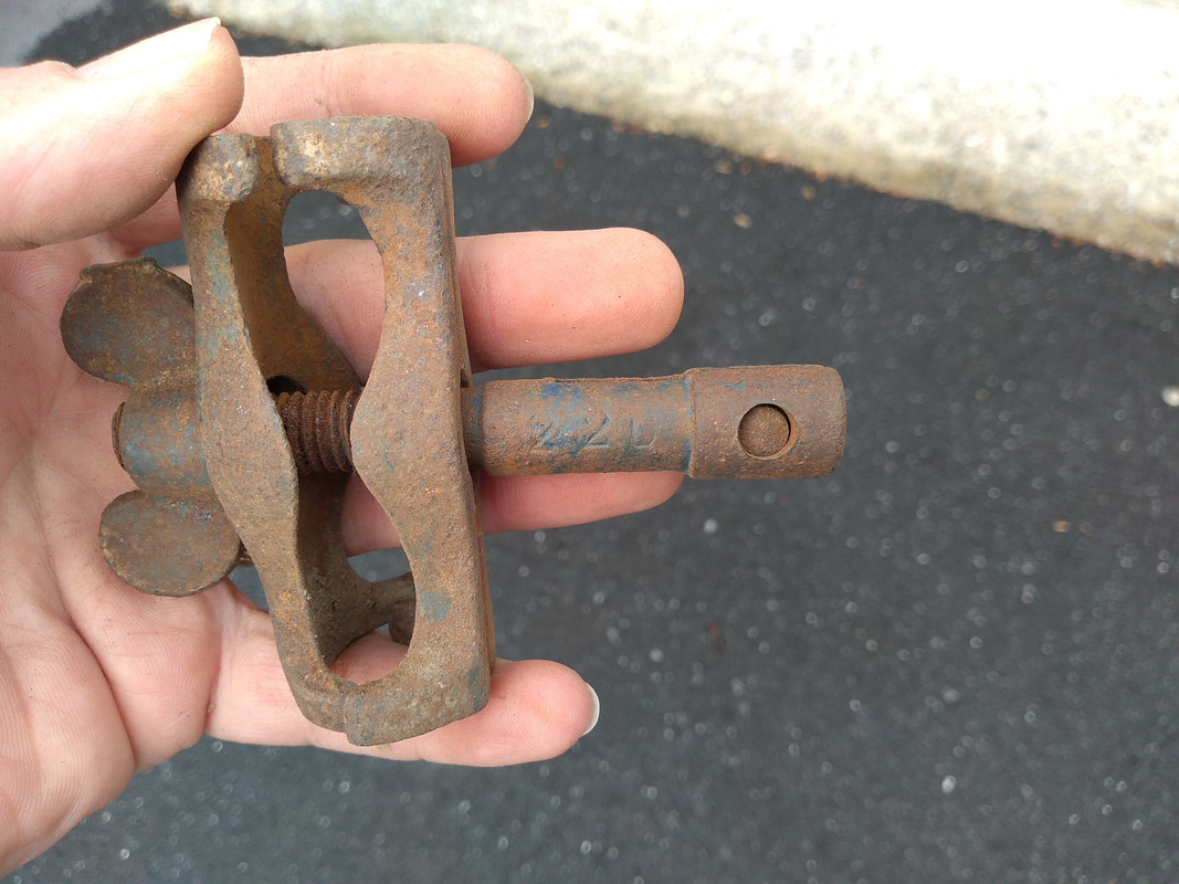

2. On the felling (narrow) saw: the handle clamps do have a stamp on them. I believe the stamp is 2 2C or 2 20, but I think it's a C and not a 0 - not sure if that means anything to anyone.

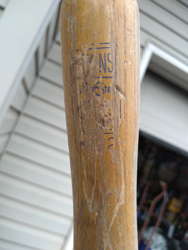

also, on that same saw, the remaining handle has this stamp - it says ___KINS super steel then something I can't read, then 1922. Not sure if the handles are original to the saw, but does anyone recognize this handle stamp?
Thanks for any info/input!!

That says Atkins Silver Steel, I believe.
Also, I'd vinegar soak them. Get some plastic sheeting, find a trough-shaped spot big enough to hold the saws and put the plastic in the depression, fill it full of vinegar and put the saws in it.

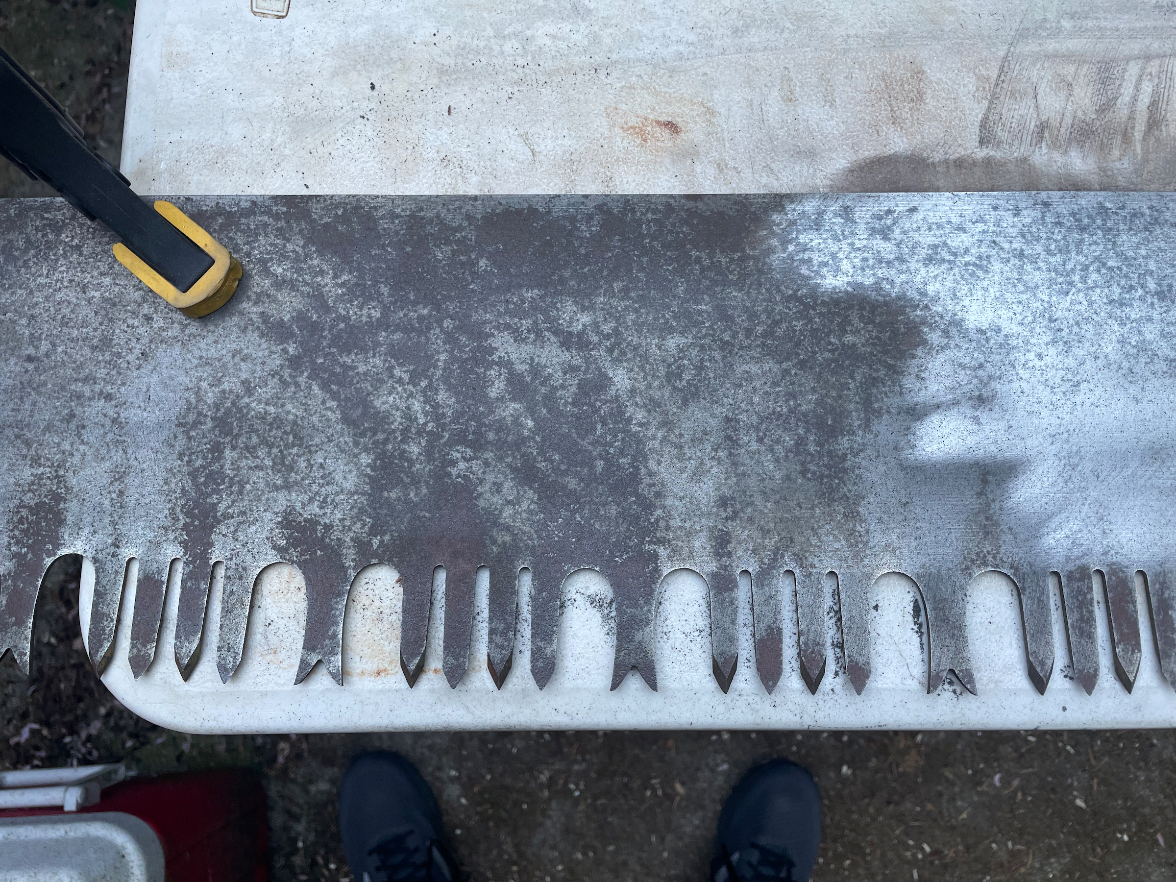

I'm a recent convert to a product called Evapo-Rust for removing rust from old tools like these. I've used it on a couple of saws as or more rusted than the ones you show with really great results. After removing my saws from the soak they had a dark patina on them, almost like that of selenium dioxide, but it came off easily with a wire cup brush on my drill. For areas of worse tarnish and pitting I used a sanding/grinding wheel, also on my drill, which worked a treat.

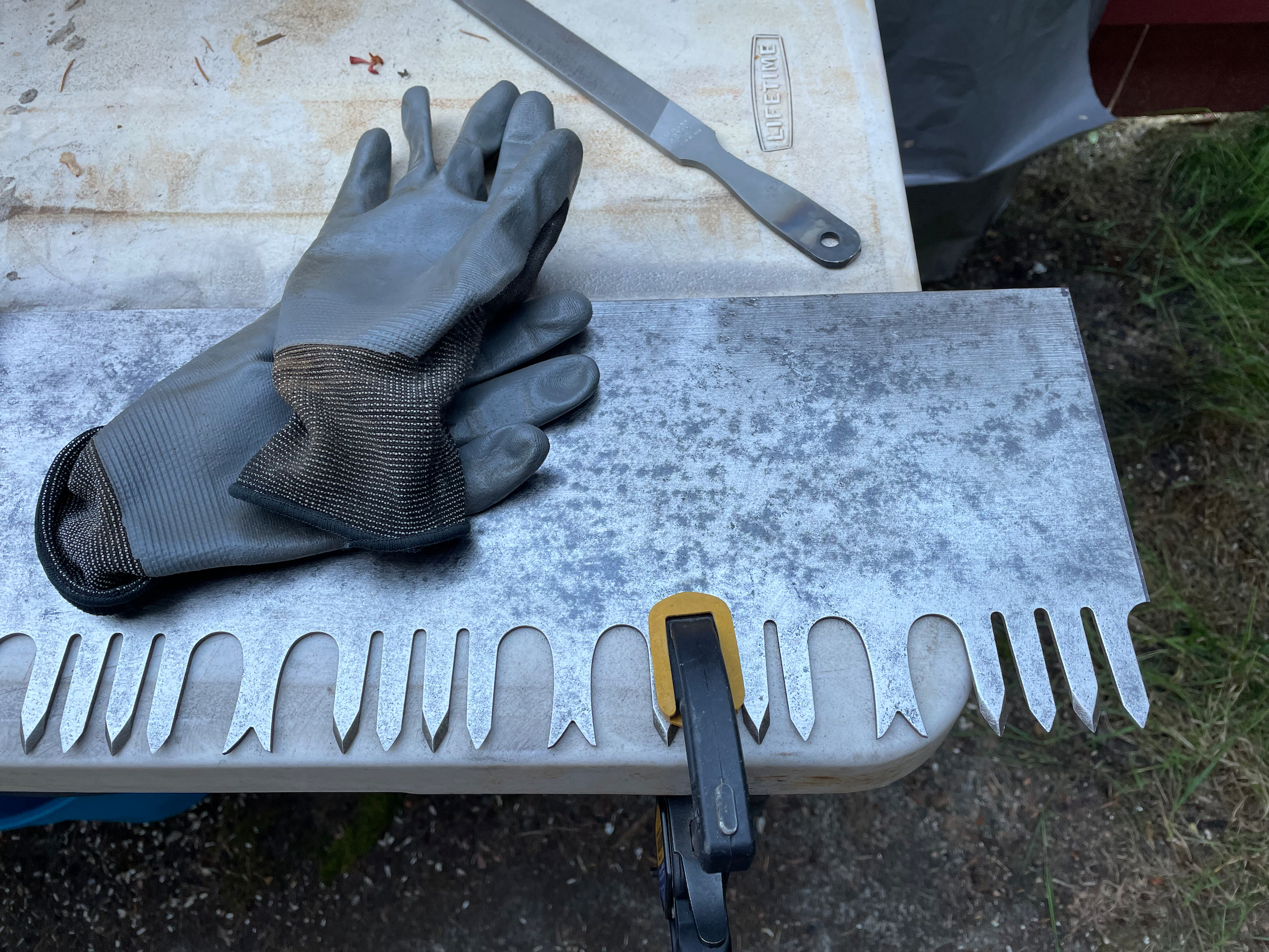

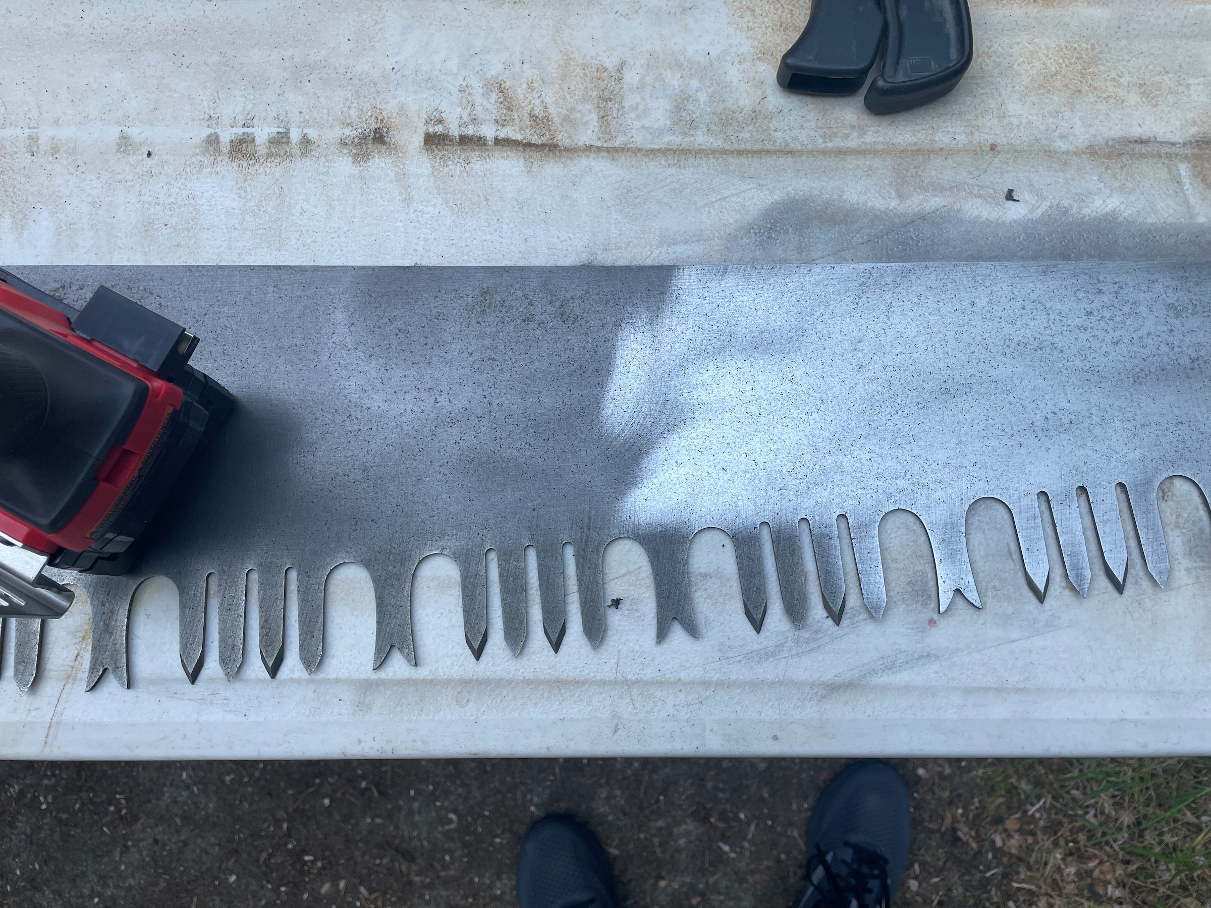

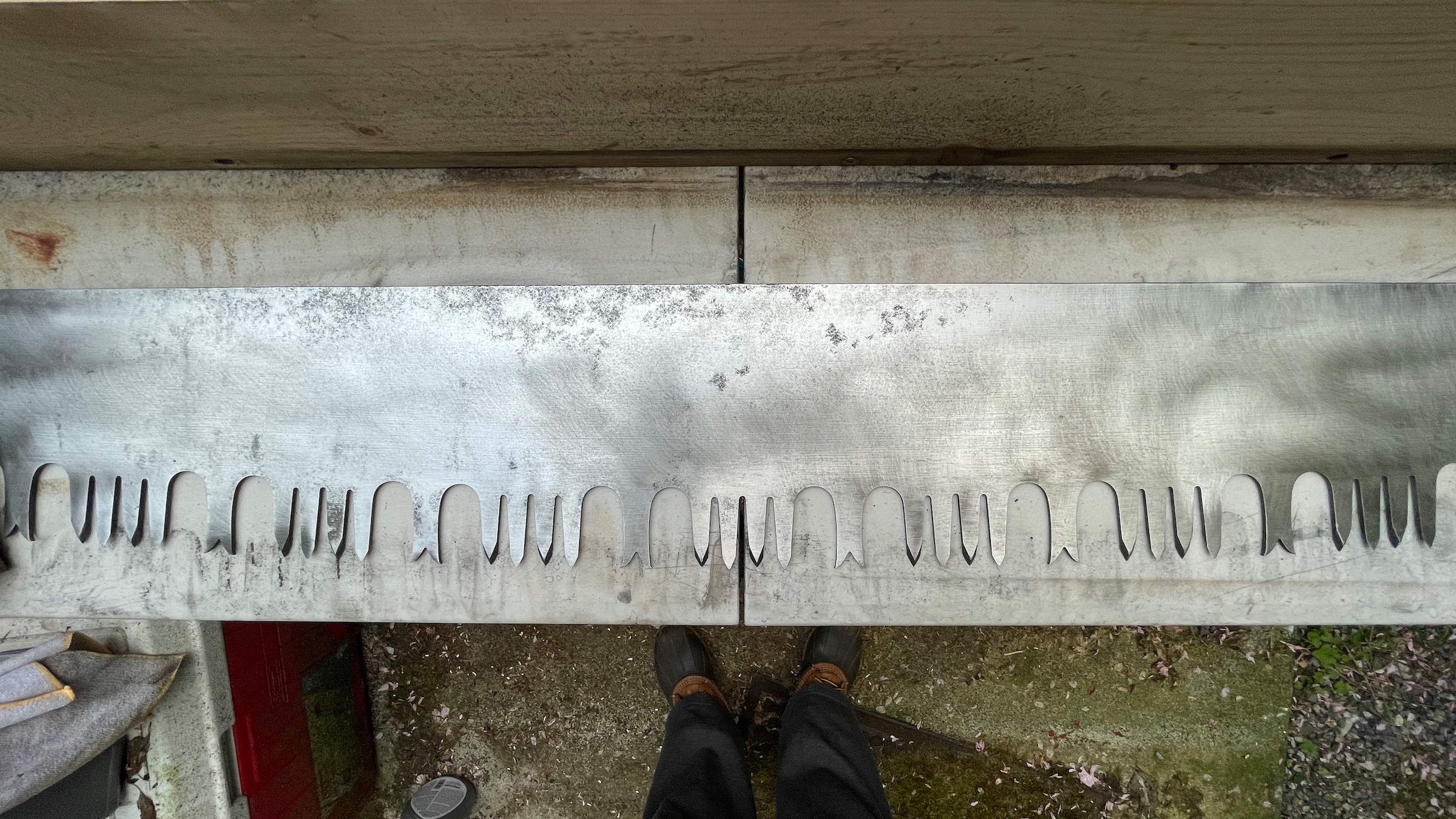

Here's one of my current project saws. It's a B3 saw (big bastard bucking saw), five feet long, good taper grind, and 1.5-inch teeth. It still needs some cleaning up, but it's got all of its teeth and I'm looking forward to getting it sharpened and back to work.

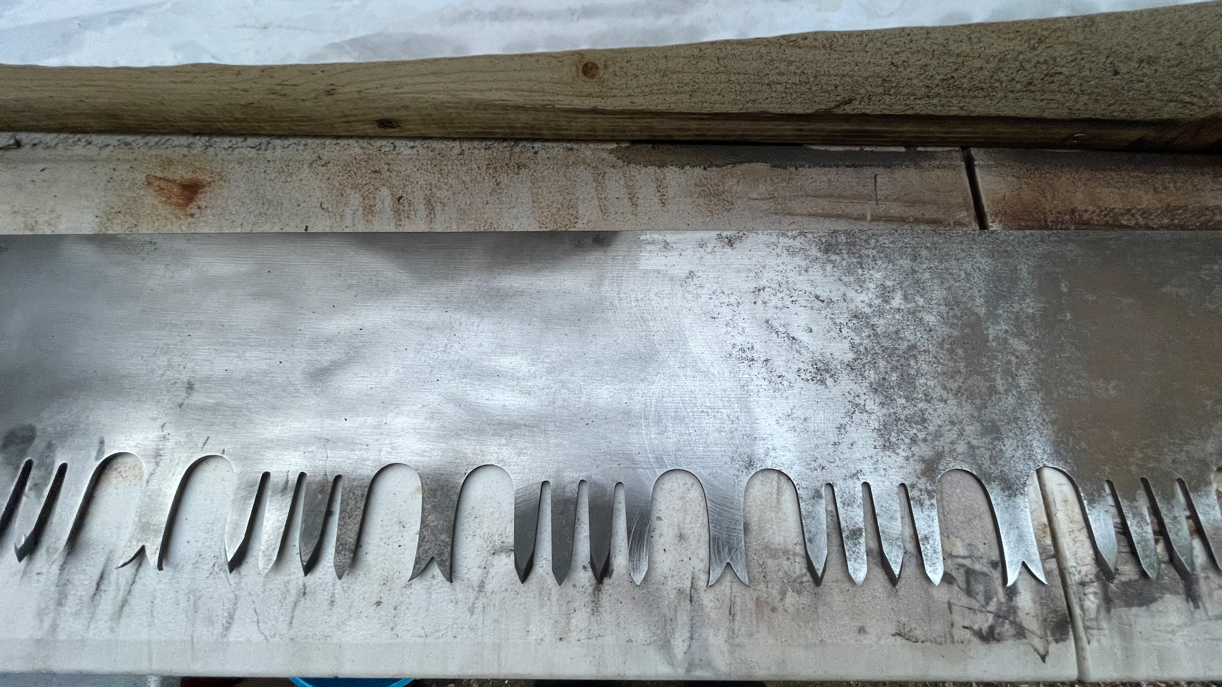

Here's another of my project saws, this one another big ol' bucker. This time I remembered to take a few more pictures during the initial cleaning. It started out as a six foot saw with a nice taper grind and 1.25-inch teeth, but with a broken raker and really gnarly pitting near one end. Evapo-Rust and grinding/sanding later brought it to this state, and then I lopped off the undesirable two feet. Once finished and sharpened I think this will make a great, four foot, bucking saw.
Can you post a picture of the whole saw for perspective? It's hard to judge a saw if all we see is 12" of teeth.

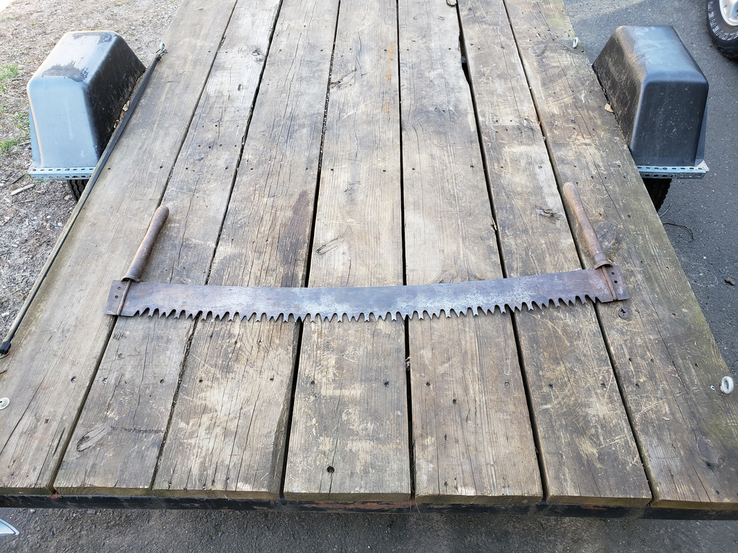

The cut off saw appears to be a Simonds 520. They make excellent trail saws. The upper saw in the video appears, based on the handle hole placement, to possibly be a Simonds 503? The 503 was one of the most popular bucking saws in the northwest prior to the chainsaw!

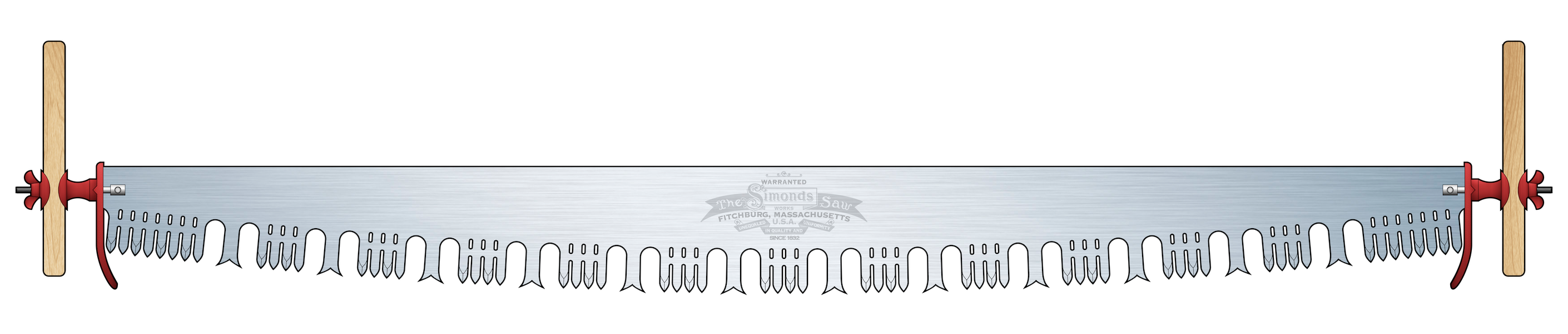

Stepping away, for a moment, from actual crosscut saws, here's a picture of one I created last year. Getting everything just right in my vector graphics program was insanely complicated, but I'm pretty pleased with how it came out. It isn't intended to be a picture of any real saw, but is a composite of a lot of the things I've seen and liked in a variety of saws. Were it real it would fall somewhere in the neighborhood of six-and-a-half feet in length.
