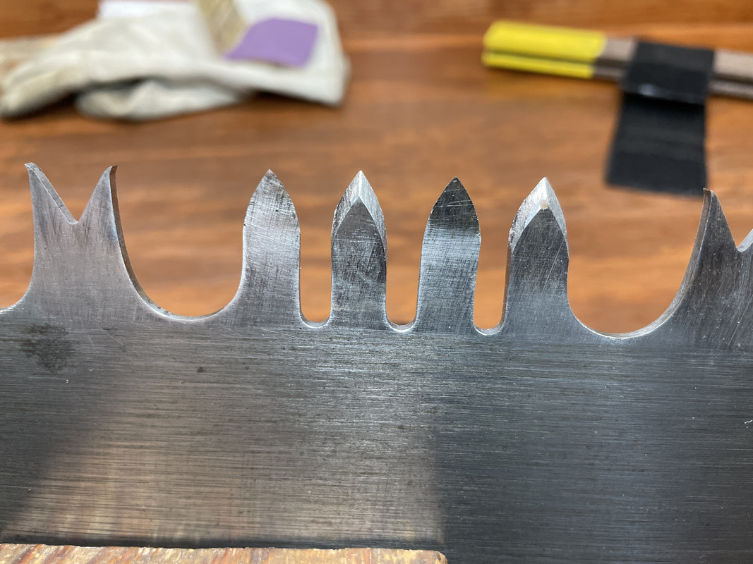

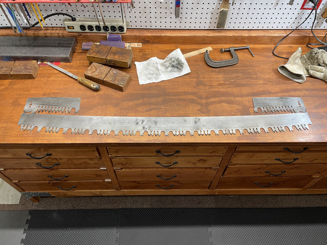

I took a 66" #325 Simonds and chopped it to 48" for a customer. Still long enough to double buck with and a very light carry. At that length, the slim belly 325 is still stiff enough for single bucking though it goes a little slower.

Here's the docked saw and a close up of the teeth with the bridges removed.

That's the ticket! Gorgeous!!
Looks like 6' down to 4'. Look at those rakers! Gullets smooth and clean! Just gorgeous!!

What do you use, how are you chopping/cutting so cleanly the bridge pieces from the ends?

Hacksaw, then smooth it with a mill file. Too cold in the garage to use an angle grinder and those things are messy indoors.
I always keep the end pieces to use for donor teeth and rakers when I weld up saws with missing parts. Makes them a bit of a Frankensaw.

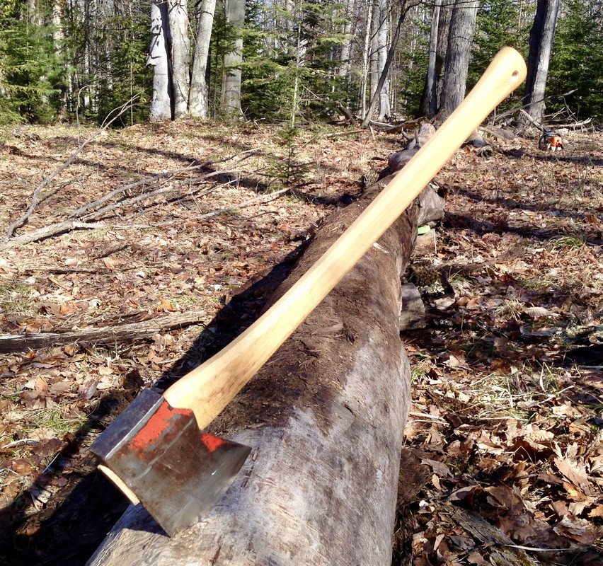

I just put that video up, glad you like it. I filed that axe with crosscut use in mind. The thin cheeks peel bark well and drive deep and hold fast when used for underbucking. The House handle didn't come as an octagonal, but that was easily done with a drawshave. Full size head makes a good wedge driver.
Here's a better look. I take it with me when cutting firewood for the stove.
