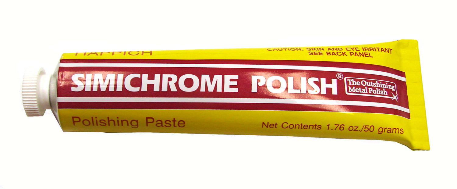

flitz, simichrome or mother's mag polish on a rag... no additional abrasives necessary.
Be aware, Flitz and Simichrome will fade the lettering. I like a more subdued look for graphics, so it's no big deal to me.
Also, treating it with Flitz rifle/gun/knife wax after polishing will help ward off any future staining.
