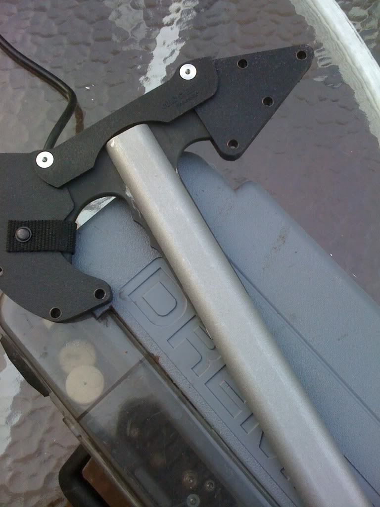

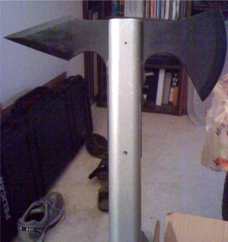

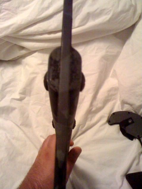

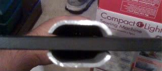

tube I used is 1.1/4 in diameter , I have to warn you hawk is heavy and I haven't tested it yet , I will post after I get chance to use it and let you know how it performs .
hopefully with pics.
Later.

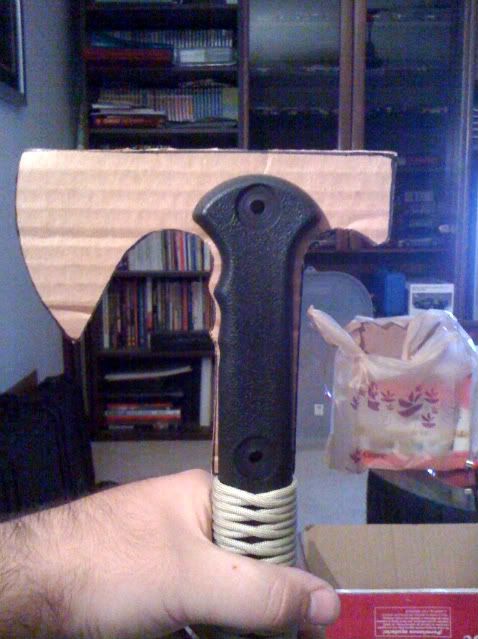

How bad is the flex with the original handle?
I have a SOG fusion Tomahawk with the poly handle, it flexes a little bit when you chop really hard.

ok, I finally got a chance to use it , it works , held up very well.
but you better have strong hands to use it.

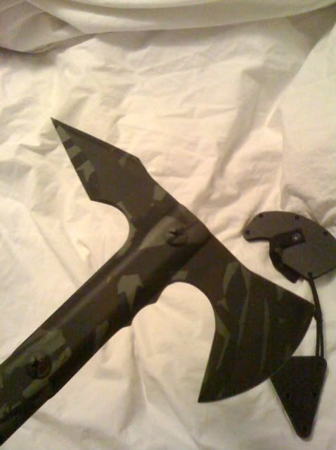

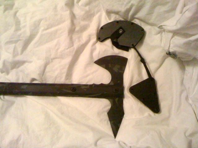

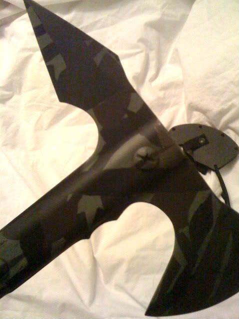

OK, As I said before you inspired me to make my own handle so here goes.
First I bought my trench hawk thinking I would "Shrike" it out.Yes you can cut the head of a Trench hawk down to this if you like.:confused:
Then I saw this thread.

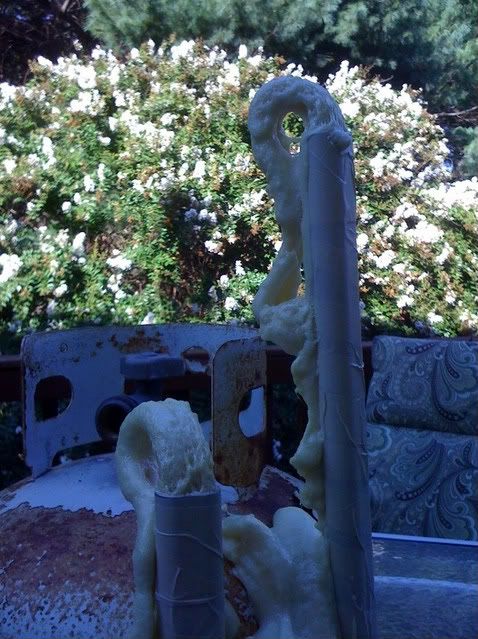

After I bolted it together I thought the tubing I had might be a little thin, So I back filled it with 8 lbs density urethane foam. Don't Mix too MUCH!!
Now here it is in all its 22" of painted camo glory (minus the paracord wrap)
Thanks for the idea...Sorry for the crappy Iphone pics.:(
thats 8lbs wet weight...what does it all weigh now that it is dry?
I think it's actually a measure of how much weight (per cubic foot) the fully expanded foam can hold. I ranges for 2lbs. to 16 lbs.. The 16 lbs. stuff is hard as a rock.
