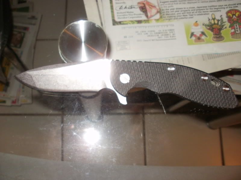

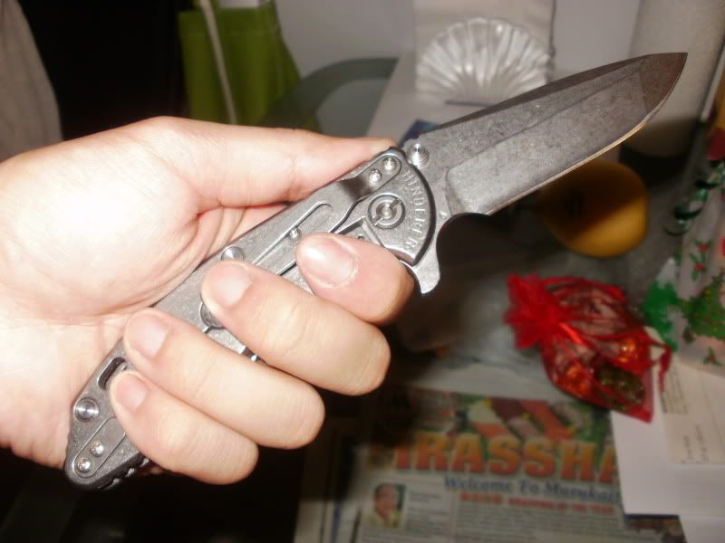

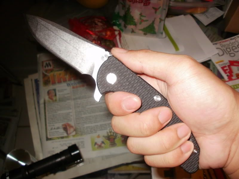

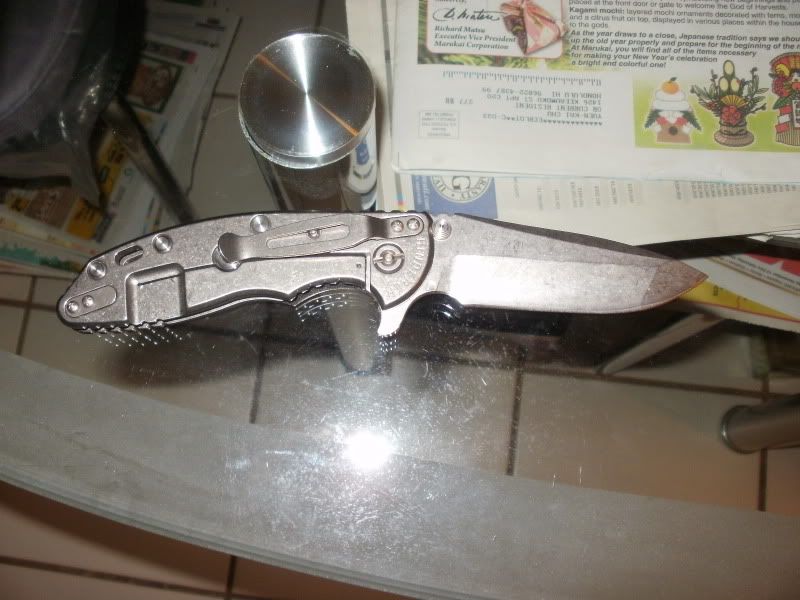

Look at what I got this morning:
The knife came in a bag with a handwritten note(which I threw away) inside that said that it was 20CV steel. However upon closer inspection, I saw "CTS-XHP" very faintly scratched onto the titanium side of the blade. It's doubtful any camera would pick it up unless said camera costs more than the XM-18 itself. The note also said that the scale was rare earth green, but it looks pretty black to me so I assume there was a mixup somewhere.
Anyways, onto the first impressions.
I'm not sure if this is just me, but the lockbar/detent felt a little..."loose". Given that this is a flipper model, I sort of thought that I could open the blade using the flipper alone, but it did require a wrist flick. Ditto with the thumb studs, as I can't seem to simply "flick" the blade open with the studs as I could have with my ZT 0551. The looseness does make opening beyond smooth, like Axis lock smooth but without the blade play issues.
Edge holding is pretty decent. I trimmed some celery and onions(root has some dirt which has silicates that are hard on the edge) and cut some cardboard with it, and the edge still roughly push cuts paper.
I am feeling a certain amount of buyer's remorse, as I don't think it was worth $660, maybe $575 given the(from what I can tell) brand new status. I can't say that this utterly blows my Lionsteel SR-1 away, but it's curious that I have little to no hesitation in using my XM-18 for any and all cutting tasks while I'm not quite as eager to do the same with my SR-1. This is a unique knife that is a work of art, and yet also begs to be used at the same time.
I AM looking forward to swapping the black scale out for orange, but given that I also need to purchase the spanner tool and the proper size allen wrench(if I'm looking at the screws right), that's going to have to be put on hold until after Christmas seeing that this knife drove me bankrupt, and I hope Rick is proud of himself:thumbup:.

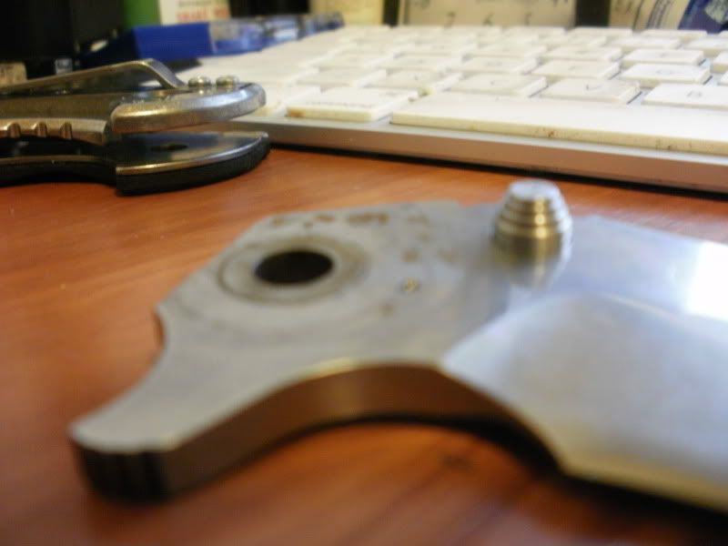

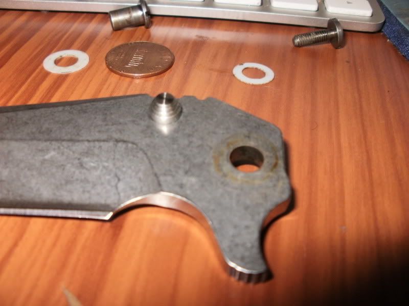

Here are the pictures:
Brasso did the trick in seconds. I also coated the pivot area of the blade with some Tuf Glide and will put the knife back together with some Chris Reeve Fluorinated Grease between the washers, the blade, and the handle for good measure.
I also did some light cardboard cutting(just a small piece) and noticed one particular attribute of the steel. It seems to lose the razor edge very quickly, but keeps an aggressive slicing edge for quite a while. At least, that's what I assume given that push cutting the cardboard would result in tearing while a long slicing motion would cut it clean.
This is getting a little ridiculous now.
After I put it all together, I rinsed the blade out with water and wiped it dry. And AGAIN I find spots of rust near the pivot, even AFTER the application of Tuf Glide(of which I want my money back because apparently it does nothing).
That blade is riding between Ti & teflon washers. Miltec-1 will stop that cold IMHO. Why do you constantly wash your knife all the time? :)

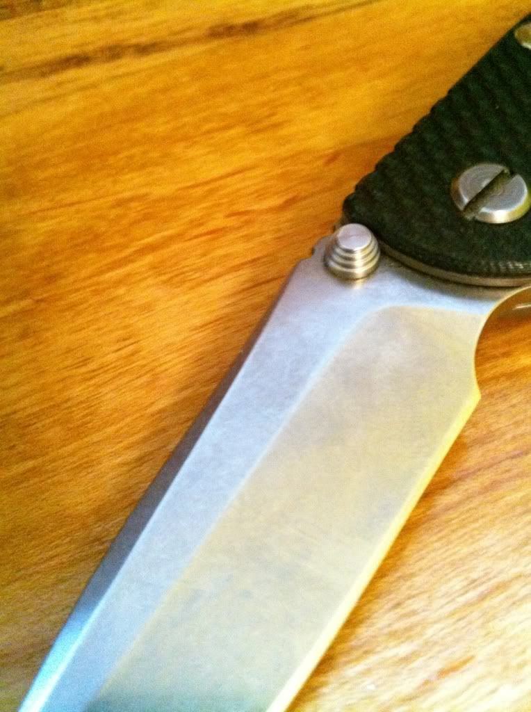

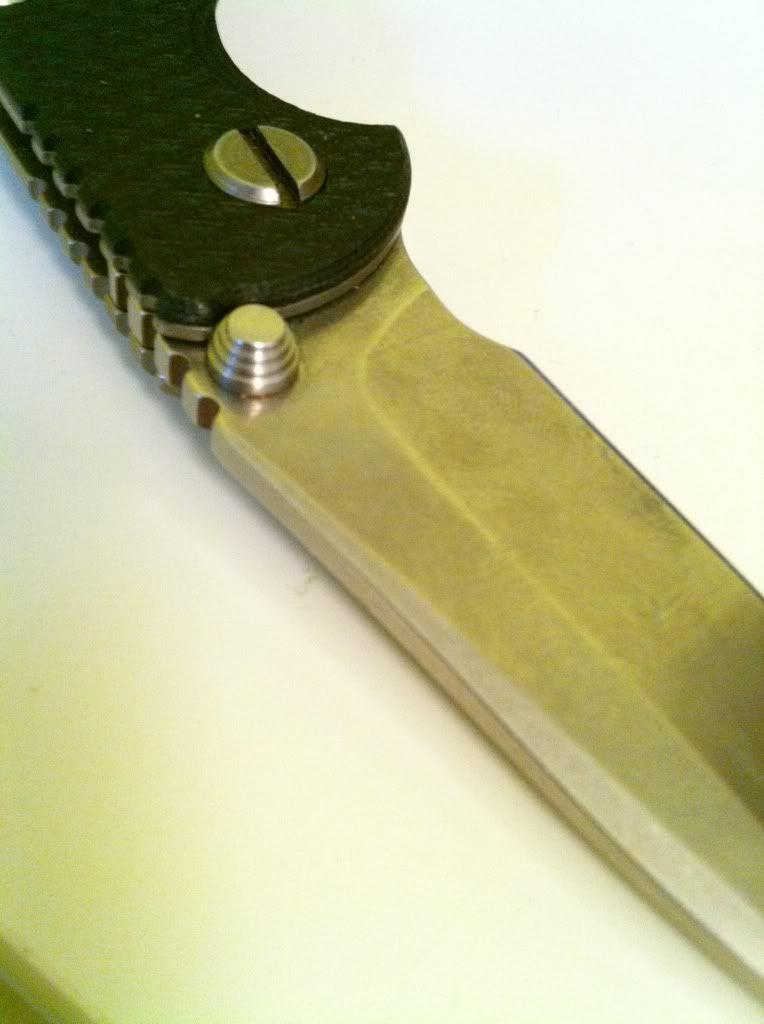

I also had some rust issues on one of my 20cv blades around the pivot .. I cleaned it off no problem but I think there is some rust where the thumb stud is pressed into the blade ! I'm thinking about sending it in for the shop to look at so things dint get worse .
Very hard to see but it's there
That blade is riding between Ti & teflon washers. Miltec-1 will stop that cold IMHO. Why do you constantly wash your knife all the time? :) :confused:
I tend to use my knives on food every now and again, and I would think washing it after cutting food was a natural thing to do.
Plus because of the above reason, I wanted to wash any leftover Brasso off the blade.
In any case, I feel tempted to put a mirror finish on the blade to avoid further rust issues. Of course, I find it curious that my ZT 0551 doesn't seem to have the same problems with its stonewashed blade, which feels even rougher than the XM-18. Maybe even Elmax has better properties than CTS-XHP.
