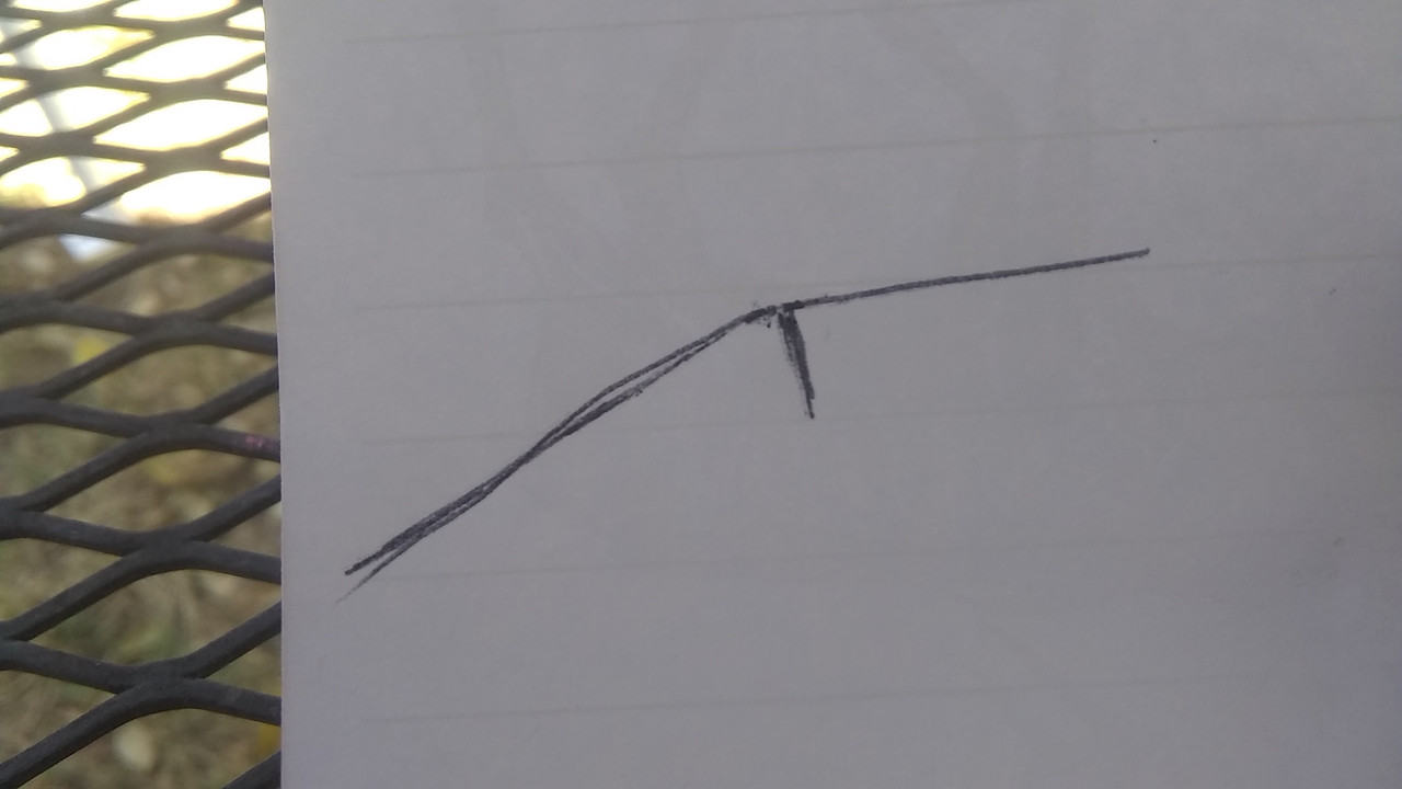

Interesting:thumbsup: Can you explain what you did and how, please?
Thanks, Will
No problem.

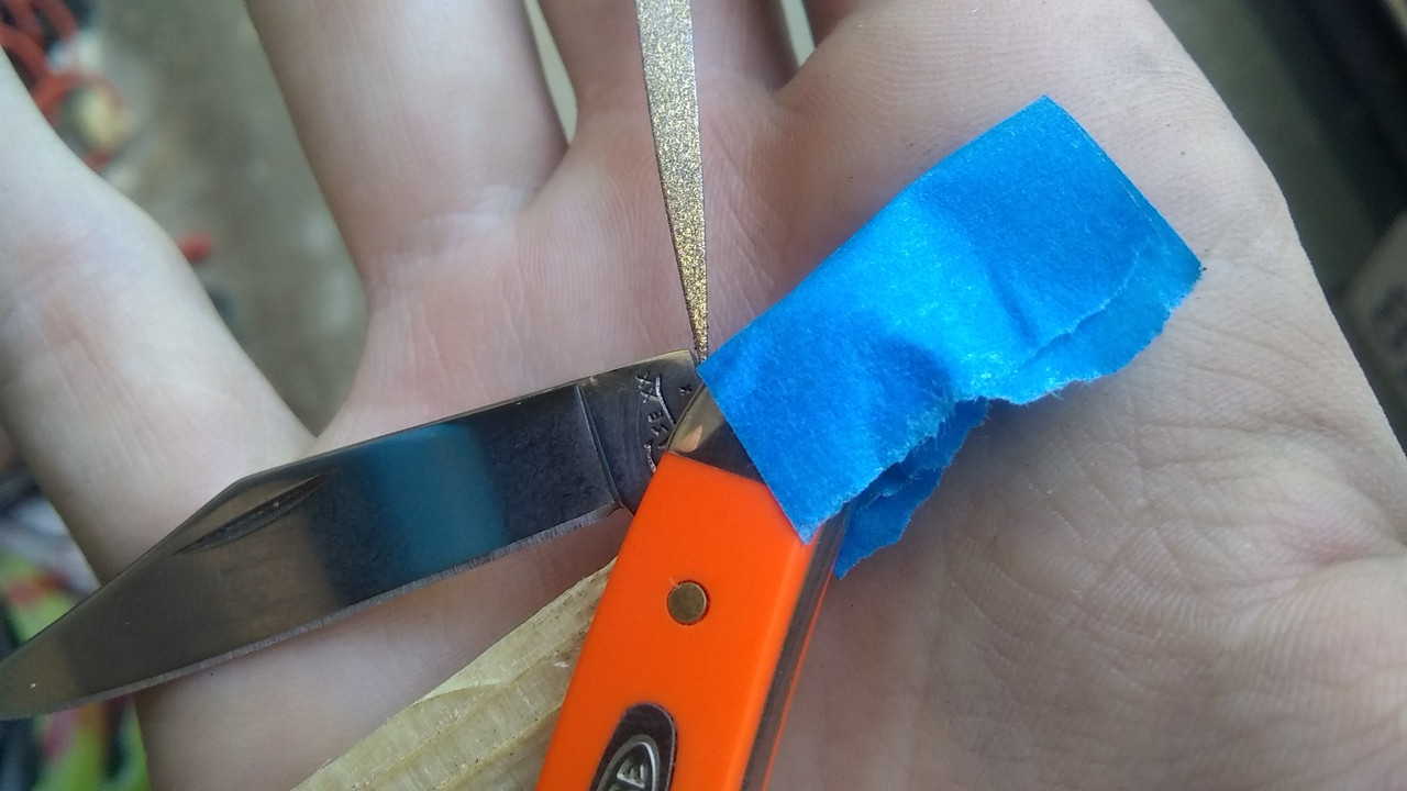

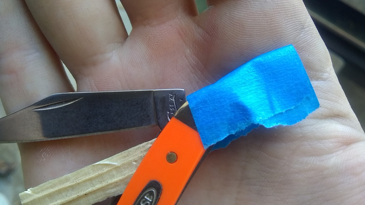

First you wanna use a piece of wood to wedge the blade open to about here and protect the bolsters with a couple layers of masking tape.
Then you're going to remove material right here, either with a needle file or by lightly kissing a belt sander.

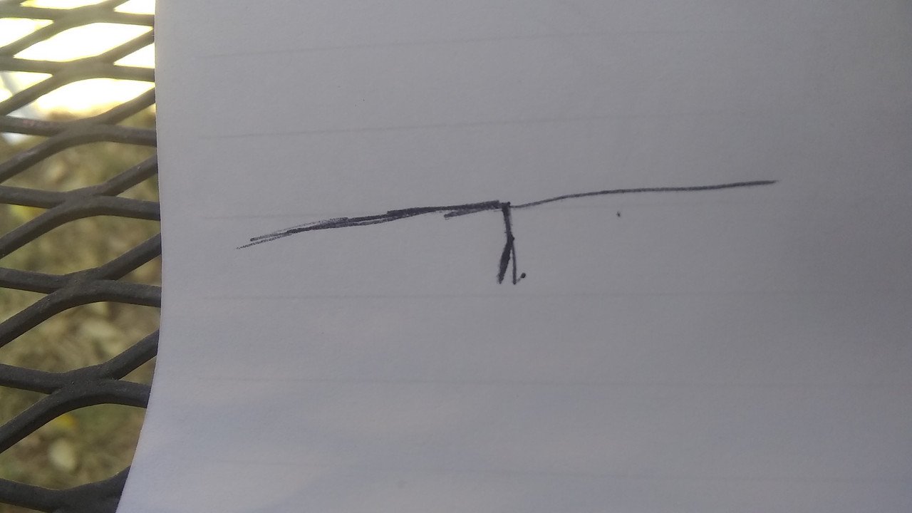

Just go slow checking your progress, then rinse and repeat till the knife is good to go.
Thank you! So to clarify, you remove the steel vertically from the entire tang or just the edge of the tang?
