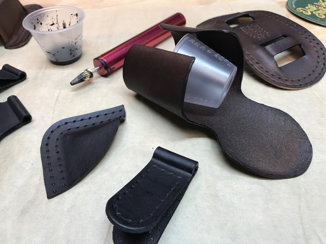

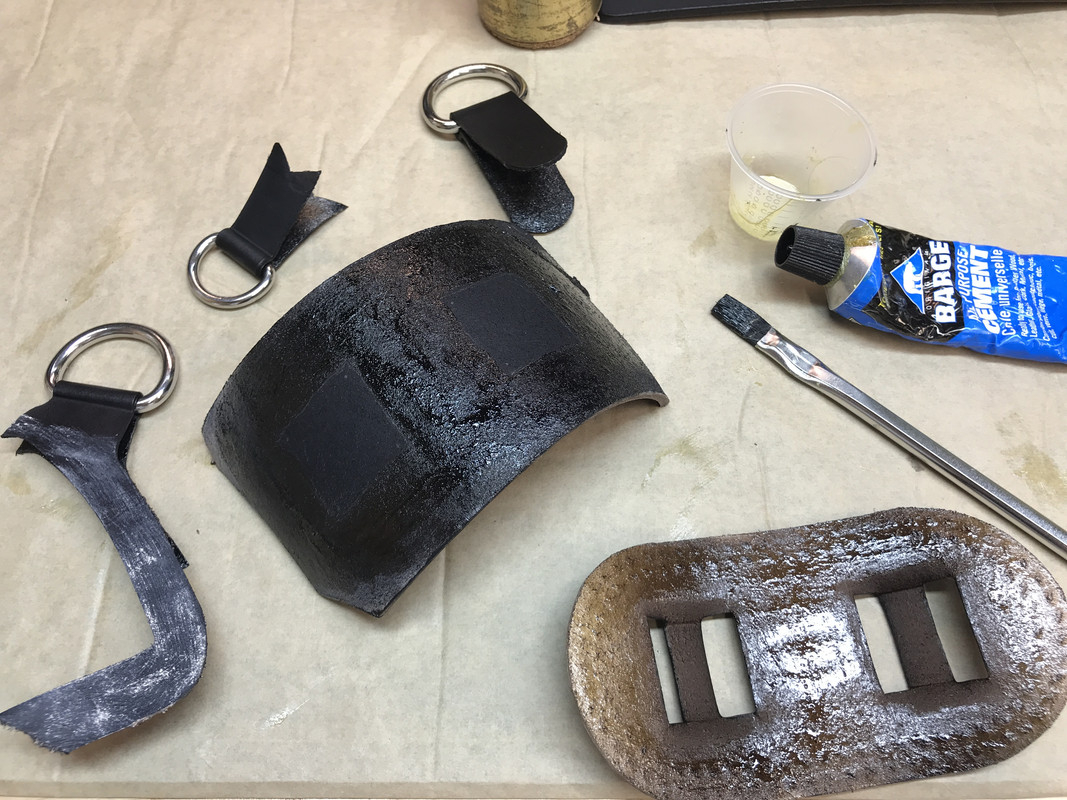

First doing a little edge painting of areas that’ll be hard to get to after assembly.
Scuffed the welt to help the Barge adhere.
Still edge painting and trying to glue everything in the right order.

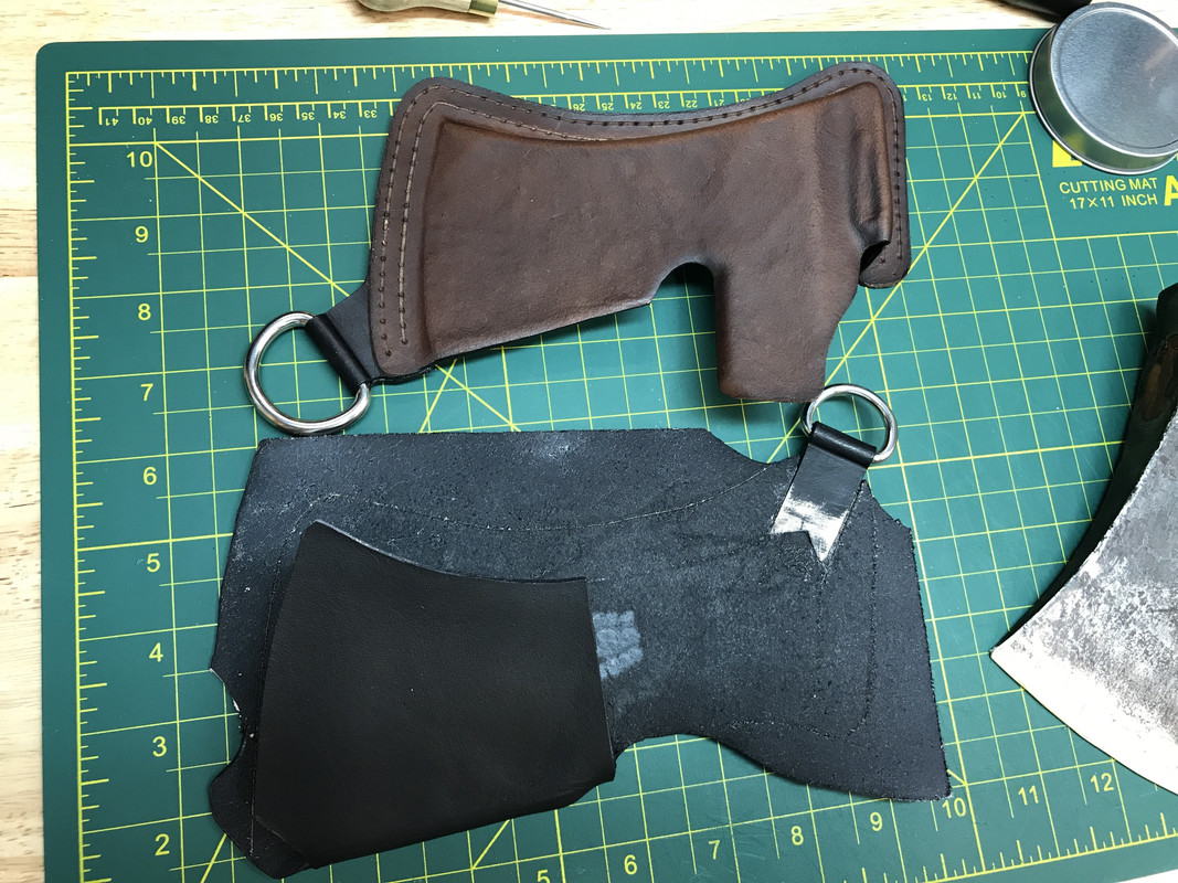

Normally I would punch and set the button first but I think I’ll have room in this sheath to do it afterward. Hope I don’t regret that decision but I’m not exactly sure of that placement yet.

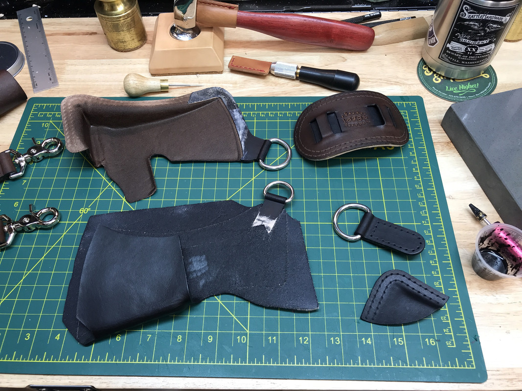

You’ll see I have only trimmed to size the two areas around the d rings. Giving me only two points of contact that have to be exact when the glue touches.

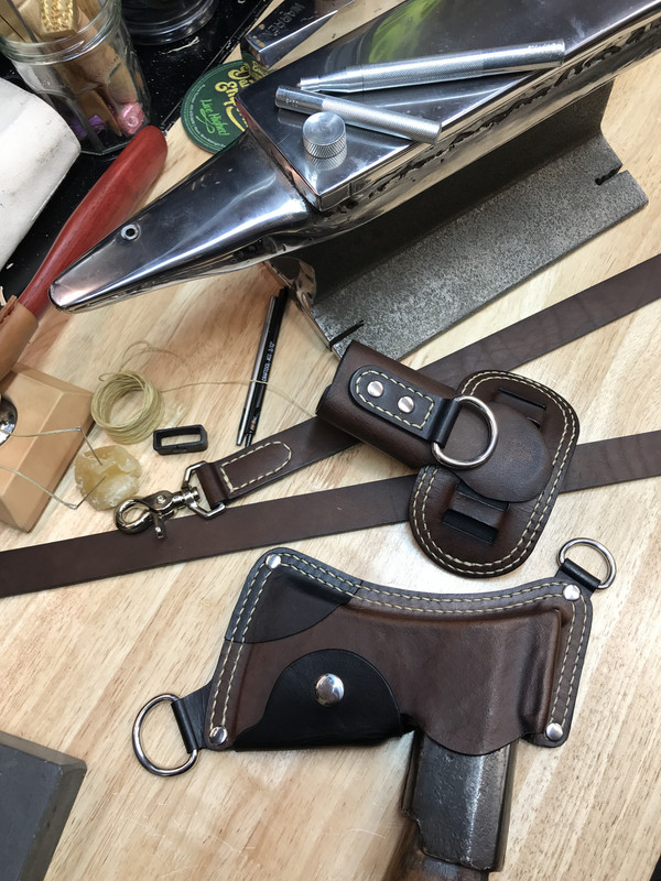

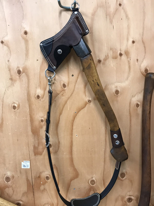

As it turns out, my design did work without any additional straps! The axe slips in and out with ease and the flap makes it nice and snug for travel.

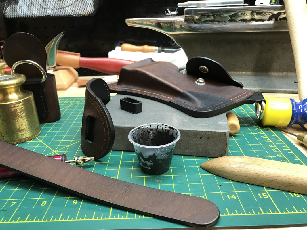

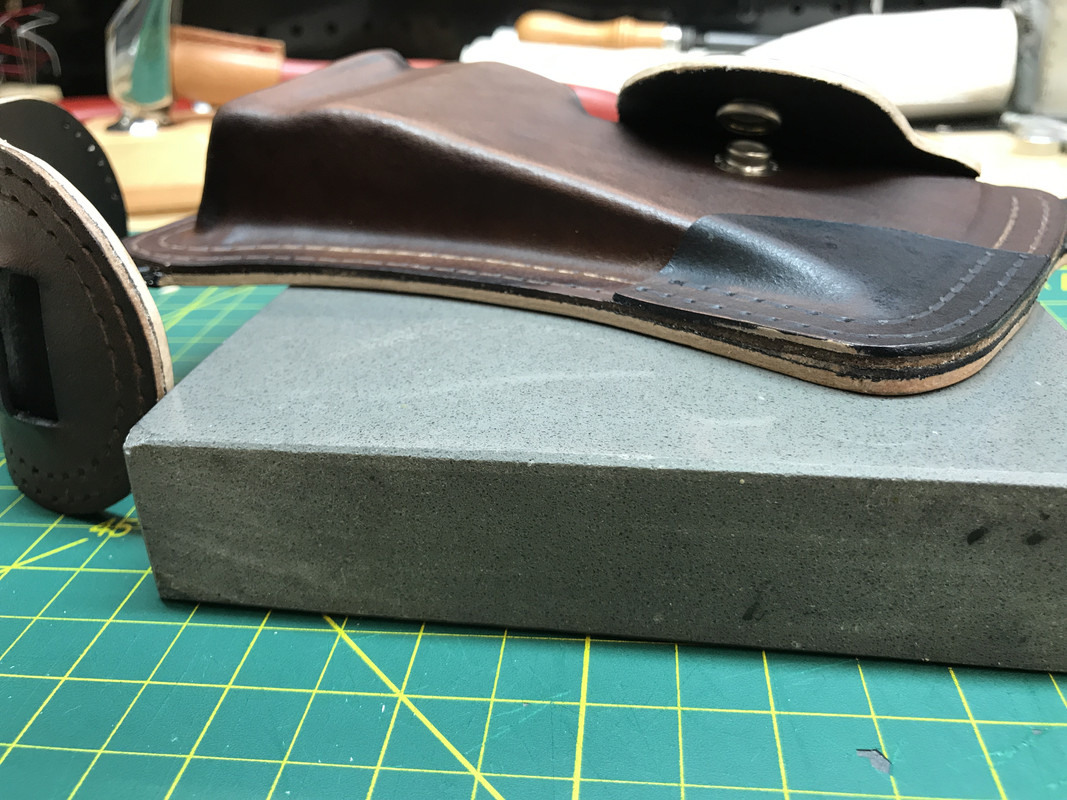

So now I’m trimming up the excess material I left incase something went wrong as well as smoothing and shaping the edges a bit before edge paint.
You can see how skiving the ends of the welt so it tapered to nothing. kept the edge clean looking.

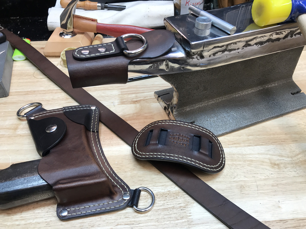

Finished up the edge paint using Exo-Flo Edge Flex. I’ll swipe a little satin finish on the edges before hammering in the rest of the buttons. Just rivets and stitching to come...

Well shoot. All the stores where I could get them will be closed today and I am just 4 rivets short of finishing. (I could do it if I put black anodized backs on them....o_O)
Of course there are things that I wish I would have done different.
I lament not being more creative with the main flap shape. I would have made it slightly smaller but also I wish I would have used two line 20 snaps instead of the one line 24 snap. If I had used two, I could have made that flap very asymmetrical and funky shaped to match the rest of the sheath.

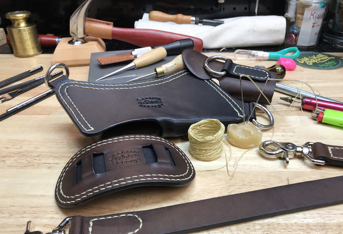

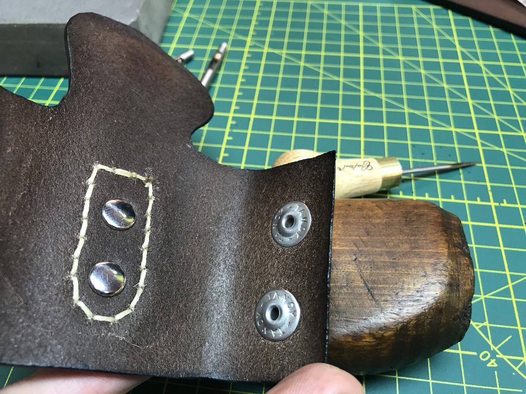

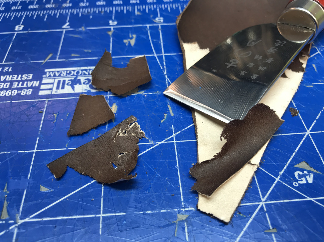

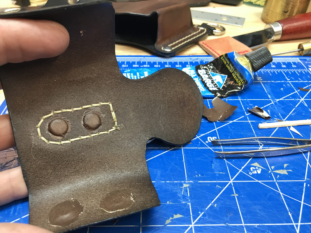

Just test fitting the collar for the handle I could see the backs of the screws and rivets could potentially mare the wood so I did something I have done for sheaths on polished axes.
I had to sharpen my knife for this. I skived very thin pieces off of my color sample piece and glued them into those metal backs. Even though this axe isn’t polished, I did it in the sheath at the same time for good measure.

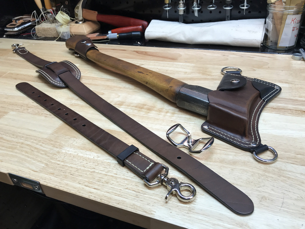

So close now. Waiting on those rivets that will go in the ends of the straps and I’m going to bang out a couple more strap retaining loops in brown in case he wants a different color or a second one to keep up the excess length on top. I left a ton of room for adjustment to go over bulky winter clothes.
The utility ring is intended to serve double-duty during time spent hanging in the back of the truck.
