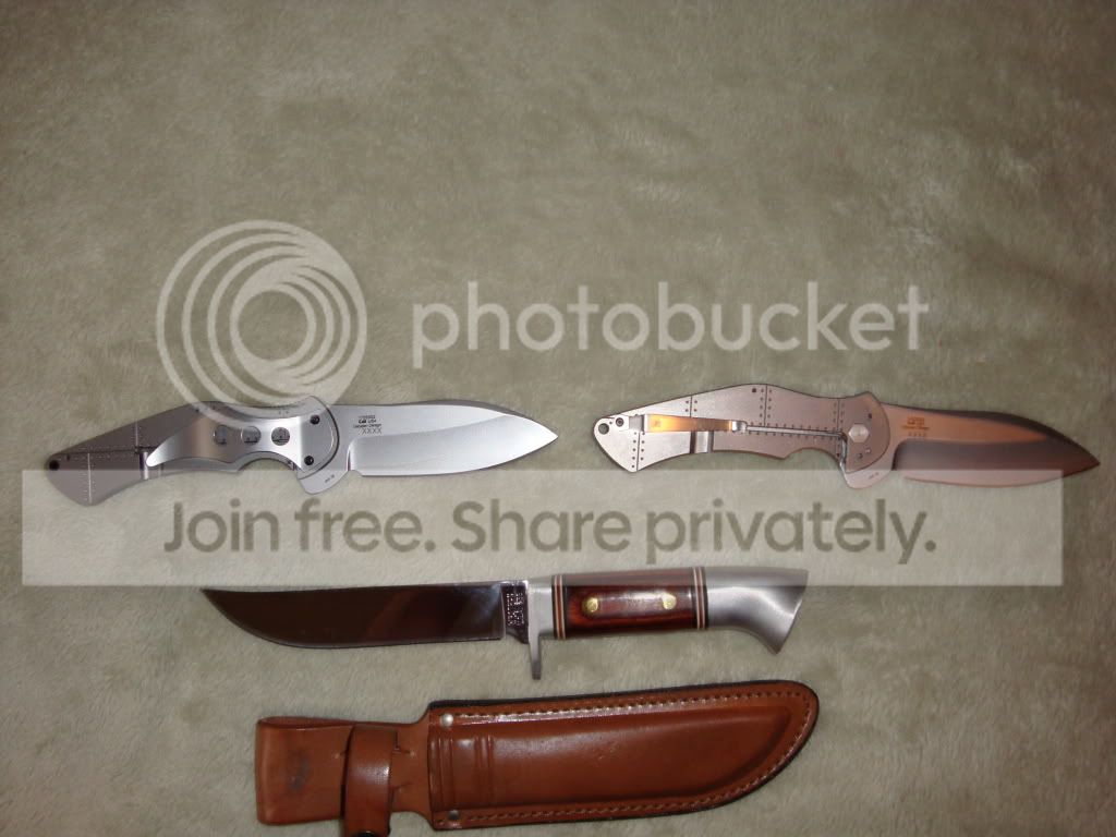

You can also pull the thing off and remove much of the offending material yourself. If you don't like the result, it's easy to go ahead and get a custom one, but if you do like the result then you haven't spent anything. I could have gone farther, but this two minute job made mine more useable and less, well...special. ;)
that is what i was thinkn of doing, your pic looks much better. I will try that first. great idea, thanks

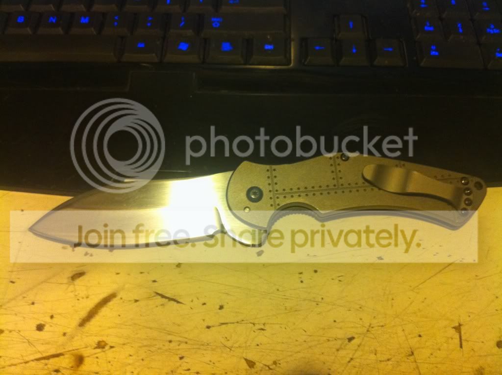

Here's a quick fix i did...it worked out perfect. Just used the clip of a crkt moskeetr knife i had lying around secured it with an extra kershaw screw (the screw was short so it worked out). you can use the hole that is already tapped at the end. I think STR's clips are hard to beat though.
