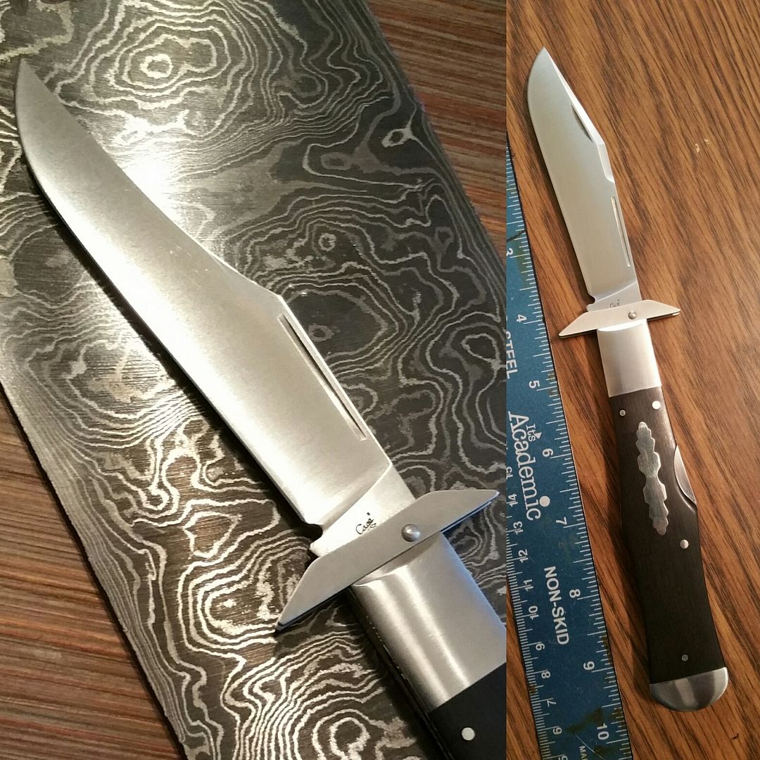

These are my two latest ones and I'm very happy with the way they turned out.
This first one is a Buck 111 with S30V drop point that came with laminated oak covers.
I took those off and added this desert ironwood.
This one is a Buck 110 with a BG-42 drop point blade.
It came with a dark laminated wood cover.
I took those off and added Maroon linen Micarta.

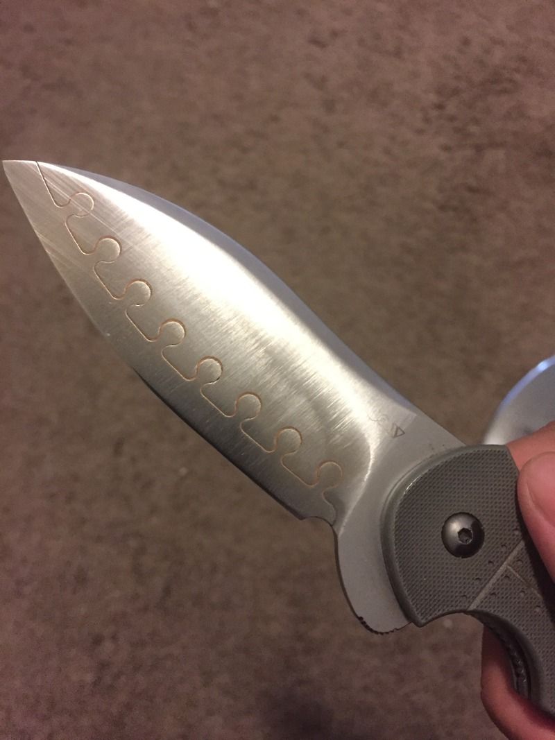

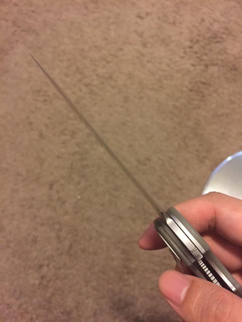

I'm not sure this qualifies as a modification, but I polished the steel and removed a lot of shoulder off the edge. Probably 10 hours of sandpaper stones and metal polish. 500, 800, 1000, 2000, 3000, 4000, and 5000 grit sandpaper, 4000 and 8000 grit stones, and mothers polish.
my arms hated me for a week after I was done, my tendinitis returned

Stump, very good work. With clean lines on both the 111 and 110 drop points. Those 111's bolsters are not easy to fit. DM

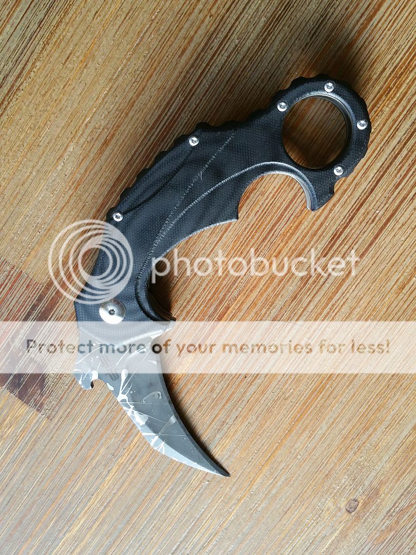

ferric chloride

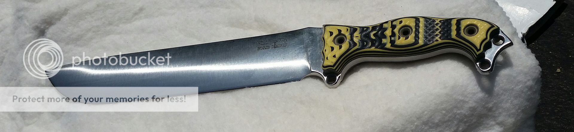

handle pimp

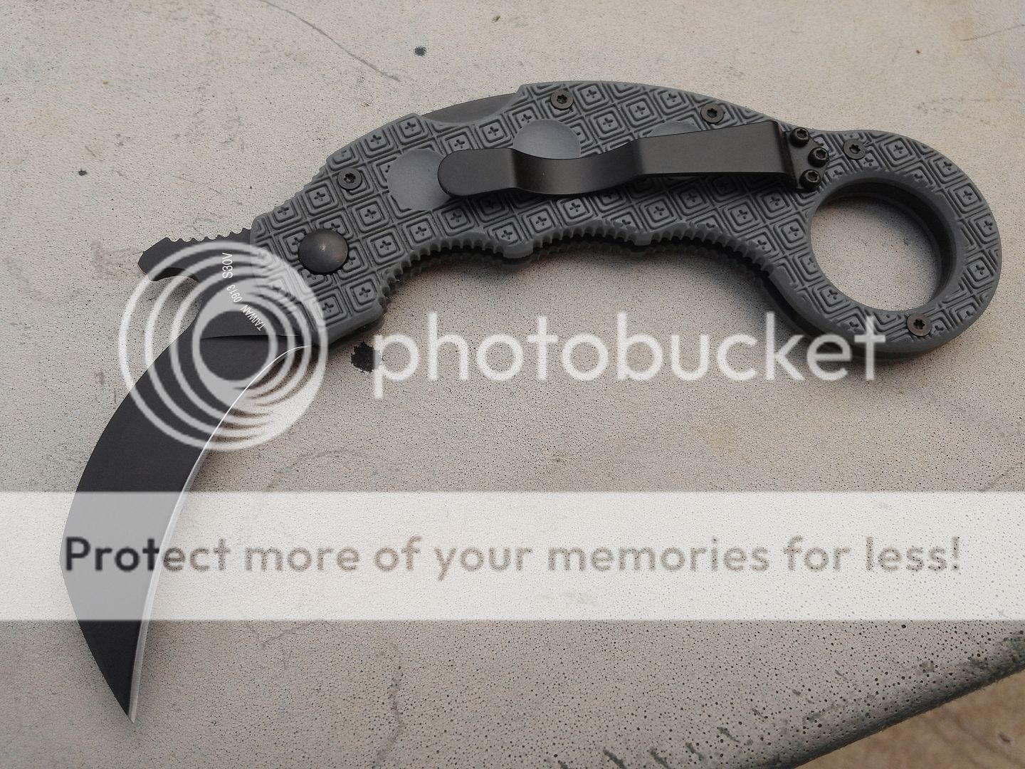

ferric chloride and it was half serrated
ferric chloride
