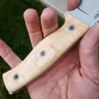

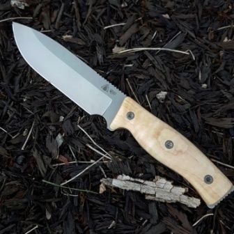

Another set for the 5.1 in stabilized maple. Really happy with the way these turned out.
These look great! Do they seem to get easier the more you do?
Thanks! Yes, for sure they get easier. I typically make a couple sets and figure out where the trouble spots are, then focus on how to solve just those details. That's why I had to make the stepped drill bit. Once I got that resolved, I was back in action. He first ones I made are probably never going back on a knife.
