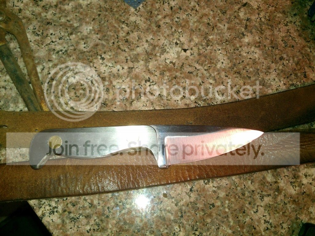

cut my finger already! lol... WIP (first knife, pic heavy!)

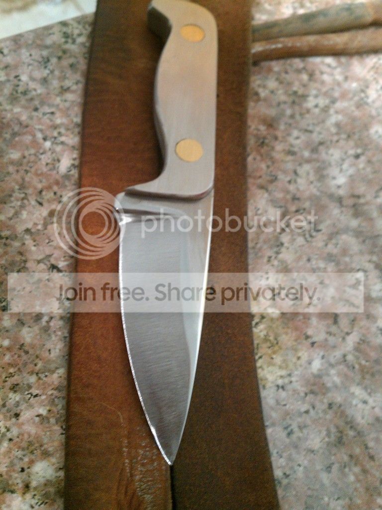

took your suggestion bladesmith... the counterboreing didn't turn out as clean as i had hoped but the sanding down of the bolts worked great...

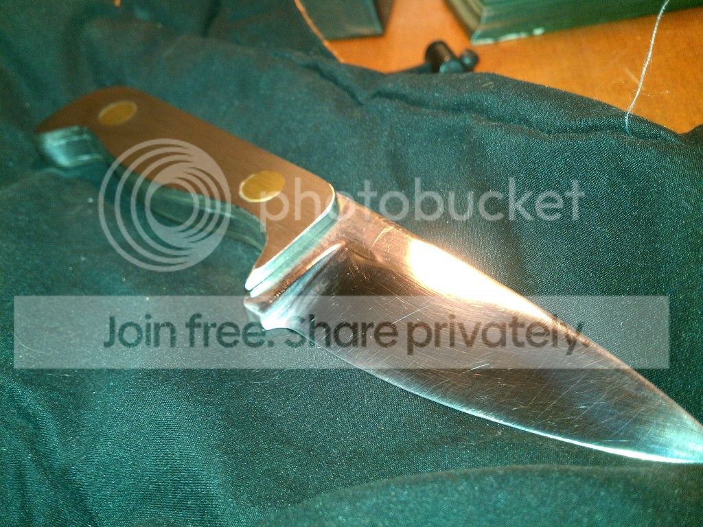

If you are still seeing scratches at the higher grits, then you haven't completely removed them at the lower grits. Scratches are pesky. You think they are gone, then they magically re-appear as you get to the higher grits and the fine dust from sanding fills them in and they become more visible. One thing you can do is get better light on the blade--even natural light--and look hard for the scratches.
One thing it looks like you might be doing is short-stroking, or "scrubbing" your blade with the sandpaper. Basically, you aren't running your sandpaper in the same direction for the entire length of the blade. This can happen a couple of different ways--either you are not running the sandpaper the full length, or you are shifting the direction slightly mid-stroke, or you are not keeping the sandpaper backing in full contact with the bevel during the entire stroke. The result is a bunch of fine lines (scratches) that are short, running in different directions along the blades, and even fishhooks. You can see it along your blade--the longer scratches in front of the ricasso suggest you spent more time there (that's a tough spot). There are more lines running roughly parrallel to the top grind line, but they vary 5-10 degrees and don't go the full length of the blade.
Overall, it's a good first effort. The scratches are a picky thing. While TV adds 10 pounds to a person, a large photo online adds about 4 grits to the depths of the scratches on a blade. :)
Thanks for the tips... I'm re-organizing my garage now to make it more work friendly... Most of the sanding was done in my living room, much to the chagrin of my wife... Lol... The edges on the handle scales are rounded out to a 1/8" radius... It's that leading edge that I left fairly square... and for the final fit I did use the heavy duty epoxy... the superglue was a temp hold while aligning the scales... The tang is drilled several times to help lighten the knife and I did bevel the edges of those holes...

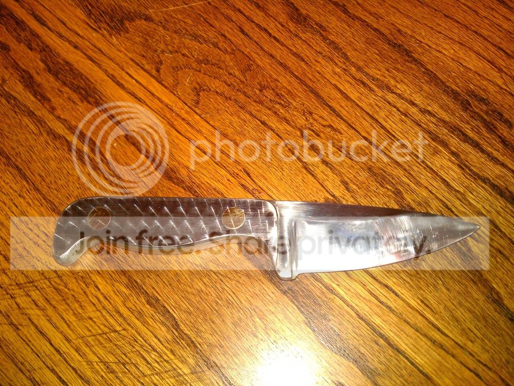

started re-working the blade tonight...
immediately i could tell that the original bevel was a bit convex... but in hindsight... i really like that belt sander... lol...
still going to do some more work... but i'm already liking it alot more... any suggestions on sanding it to keep it a nice clean beveled edge??? want to leave a bit of these sanding marks on the blade... might try the scotchbrite belt... got more research to do in the meantime...

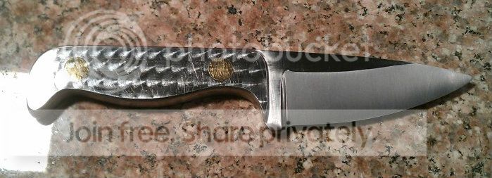

soooo... i was working on re-sanding my blade... since i got my bevels cleaned up more like i wanted them... and my hand was getting kindof tired... i started just looking at the knife and got to thinking about a comment a friend of mine made... he suggested that i jewel the handle... but i haven't ever tried jeweling something before... so i took a piece of scrap and started experimenting... decided that i could do it to the handle of my knife and went at it... this is just one side finished... but i'm rather liking the look... hopefully tomorrow i can finish sanding it and do some final touchup work and call it good...
i got it all nice and polished up... but it just seemed too much crome... it needed some texture, something to give it some highlights... so i took the scotchbrite pad, taped off the polished parts i wanted to keep nice and shiney... and gave the blade a much nicer finish... i'm now really happy to hang it on my wall... lol...
