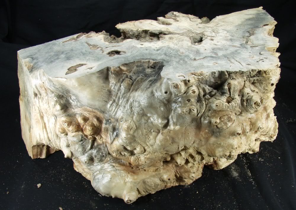

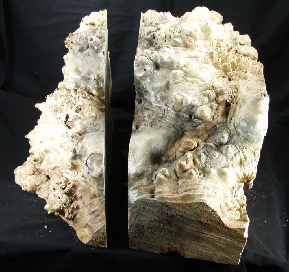

This photo is of a quarter piece of buckeye that I put away in a dark shipping container for the last year or so.
Looking at the outside you see only a hint of the coloring inside. That is because the outside is dryer than the inside which is still a little damp.

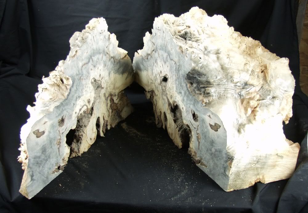

First thing I do is look at all the sides of the burl to decide where to make my first cut. You will usually get some of the best figure with cuts made parallel to the outer surface of the burl. With that in mind I wanted to cut the burl into 2 manageable sized pieces.
After that I looked at the 2 pieces to see which cut face showed the best figure.

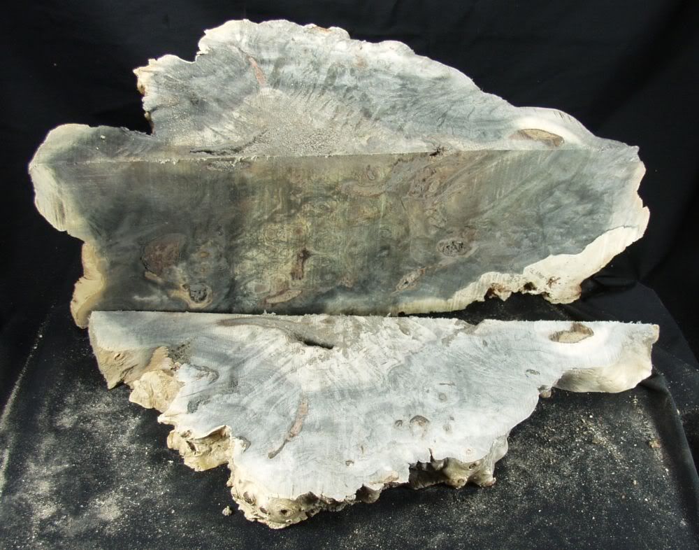

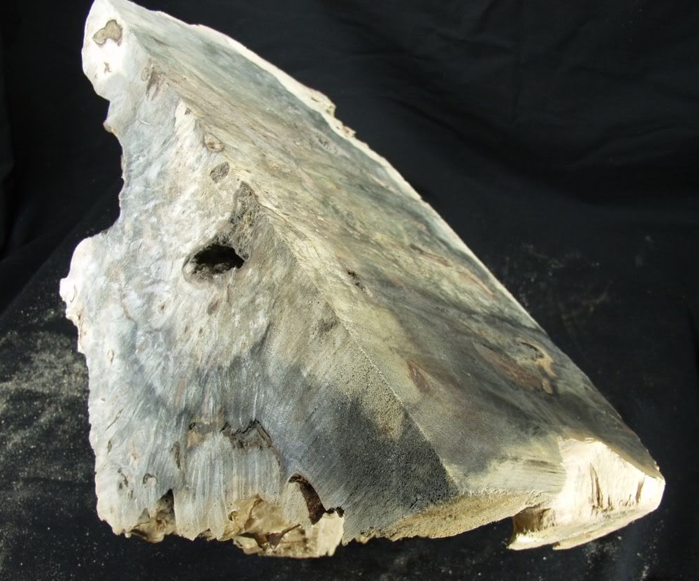

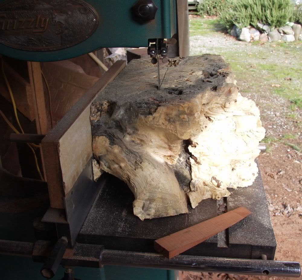

Next with the bandsaw I cut a slice a little thicker than a handle block off the face with the best figure.

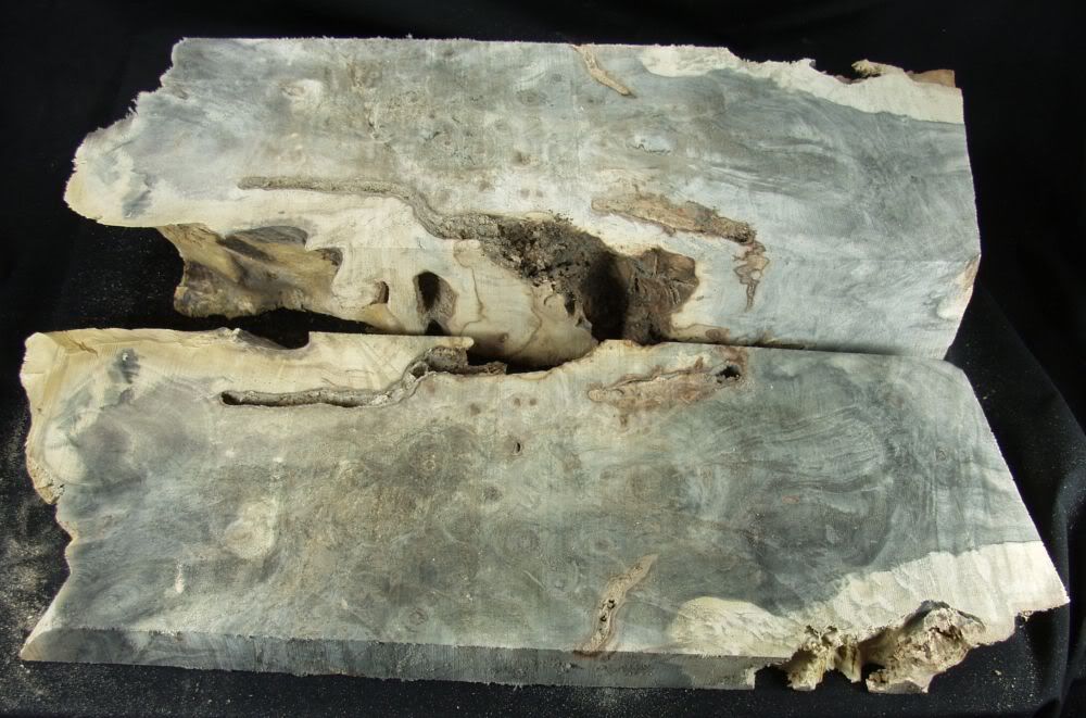

This shows the 2 big pieces with a slice cut off of them.
You have probably noticed there are a lot of voids.
For buckeye, this is a very solid piece. Usually there will be a whole lot more voids. Some of the voids will be bark pockets while others will have dirt or rocks inside. Because of that Buckeye burl is tough on bandsaw blades and will have a lot of waste.

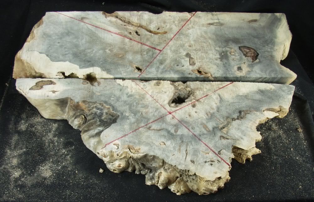

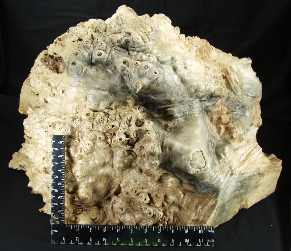

Next I take the 2 slabs I cut off of these pieces. You could just cut these into strips but I prefer to look at them and decide how to cut them next for the best looking handle blocks. With a pen I made marks for my next cuts.
I cut along those guidelines to make the strips that I would later trim into blocks.

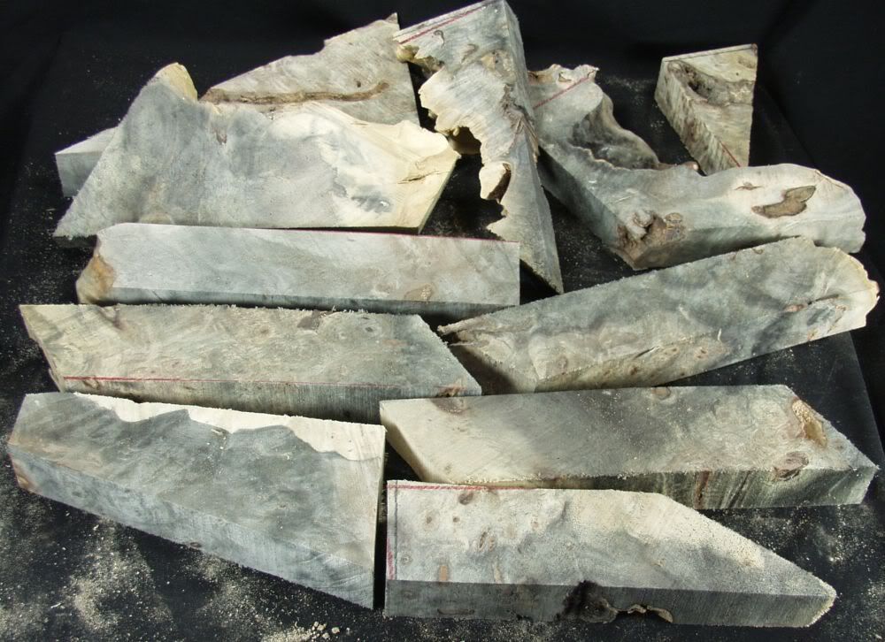

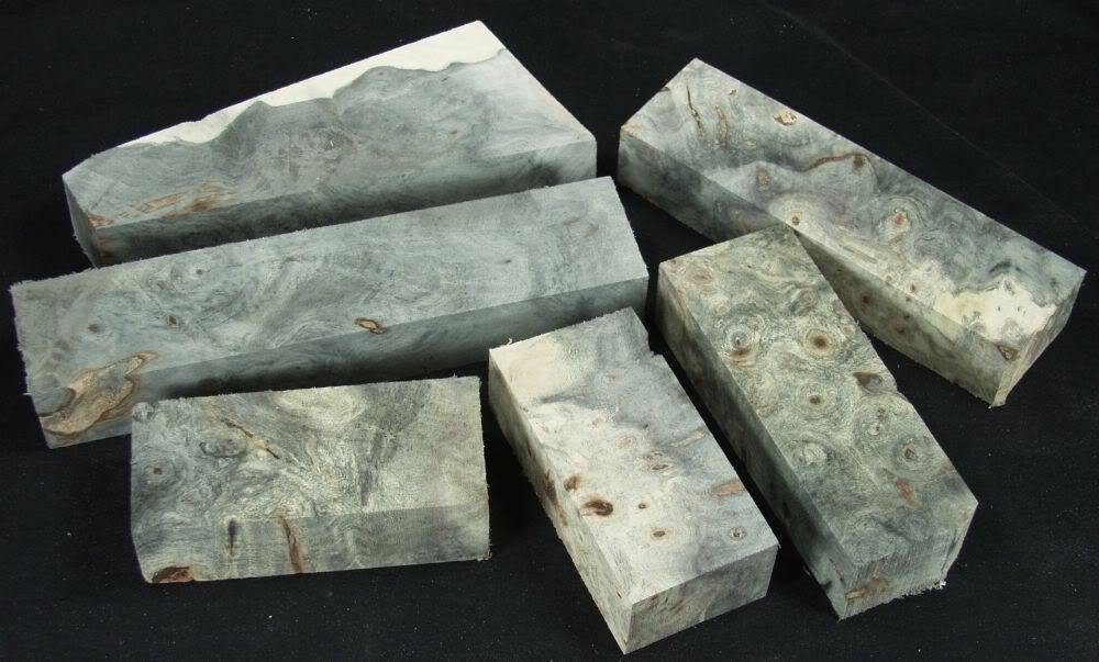

After that I trimmed the strips into what I felt were the best blocks.
It's kind of hard to see in the photo but these blocks will all have very 3 dimensional bubbly figure when they are sanded and finished.
Less than 1/2 of the wood from this burl was suitable for knife handles but I still got some really nice blocks.
