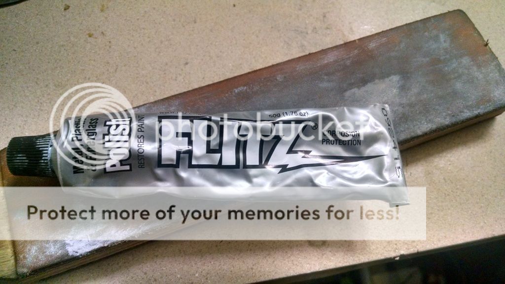

I was able to achieve this off .5 micron leather, followed by flitz on a paint stick...The hair is ridiculously fine as it's from my blonde 5yr old daughter's hair brush.
https://youtu.be/F6T7frfZ13I

That's a heck of a blade to work with! Really thick blades frustrate me, you must be a patient man :p
I'm guessing that is a Chrome or metal polish huh?
It's basically an everything polish, metal, plastic, fiber glass, ect...Works great I got the tip from someone here...also works great as a protective coating for carbon steel.
It literally took my edge from whittling thicker hair to straight cutting a super fine hair...
Good ol' Flitz!

I use the liquid form, I apply it liberally on a paint stick and allow it to dry, then strop away, reapply as necessary or get a new stick....It didn't work well on leather for me..it dried it and got rough and chalky..
