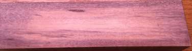

so ... today I went ahead and cut those babies up into 2" x 2" blocks for further drying. this one is for you Ben: the lighter colored block is this one (though not quite as purpleish as seems in this photo):

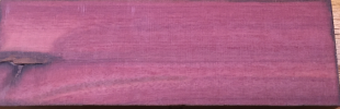

the darker colored one is this one:
(color is pretty true - really pretty reddish-purple coloring)
Do these help you any more to identify species??
Anyway ... tested the cross sections for moisture .. and the lighter one tested about 9-10% moisture. the darker (prettier one of course!) tested at ~15%. I am not sure why the cut versus existing surface measurements differed ... but maybe this is an argument for a pinless meter???
Anyway - given the moisture content of the darker sample, I took those and placed them into zip-loc baggies with a few holes punched in them - hopefully that will help slow down the moisture loss and reduce risk of checking. We will see.... I hope they turn out ok - those darker blocks are REALLY pretty :-)
