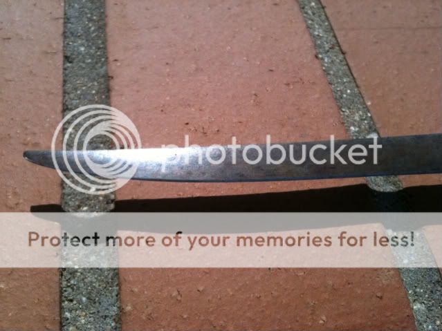

I also get a funky taste on fruit with my Case cv trapper. I think in time it will definitely go away, though. Probably when the Dexter was new, it had a funky taste too, but it's been sooo heavily patinaed that it's not longer the case.
BTW, here is a shot of the Dexter:
And here's a closer shot of the blade:
