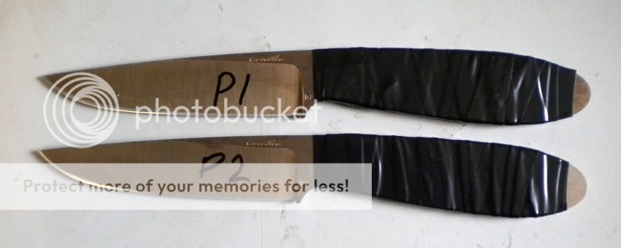

Today I'm doing a variation of my comparative test because I'm trying to eek out some subtle differences, I'm not looking for gross differences right now (I have that pretty much figured out at this point in this particular on going project) so I'm using relevant standards and previous test specimens as standards. A knife in a simple steel like W2 is excellent to have in a bunch of standards, but it isn't going to tell me much in my evaluation of changes to my D2 HT as well as comparing against other D2 knives. Ideally, at this point in this on-going project, things are as apples to apples as possible.
I'm testing two things today. A variation to the HT process timing, and the addition of a thermal cycle. So I'm running two blades through in order to evaluate both changes. (I try to make only one change at a time when possible in a test blade)
Both test blades measure about HRC 61, as do two of the D2 standards.

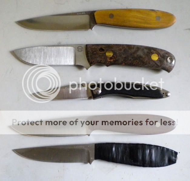

My standards for this test:
These are:
1 my personal skinning knife (.010 edge, HRC 60-61),
2 a high quality knife in D2 (.015 edge, ~ HRC 61),
3 a high quality knife in S30V (.020 edge, ~ HRC 59),
4 a knife from my last batch (.015 edge, .010 tip HRC 61-62),
5 a knife with a known issue with retained austenite (.015 edge, HRC 61-62).
That's five standards. Part of the reason for so many is to make subtle differences between them and my test subjects more apparent, and part of the reason is to give additional illustrations of the testing procedure for this thread.
The blades being evaluated:
P1 and P2 are identical to each other in every way except one received an additional thermal cycle, ( .015 edge, .010 tip, HRC 60-61) I don't know which is which (they're marked under the tape). Test coupons that are metallurgically identical to these two test blades have already been broken and looked at under magnification, there is a difference, so I do have some preconceptions that I don't want muddying the waters.
I'm about to start the tests. As I sit here typing this, I haven't started yet, and I don't know what the outcome will be (though I have a pretty good estimate, based on past experience). But, I won't be surprised if the final outcome is my work compares well to the other standards. So it may, in retrospect, appear that this entire article is shameless self promotion. If so, please consider the fact that I have been working at this for years, and my process has been tweaked to create blades that perform well at these particular tests. If I were to change my test to batoning through a cinder block my work would probably not perform very well. I don't really expect huge differences between most of these test blades because they're all pretty similar apples, but I'm hoping for incremental improvements in P1 and P2.

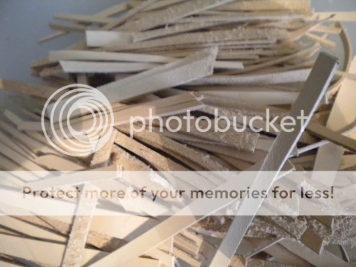

The test starts with cutting cardboard. A narrow part of the blade is used for the cut to eliminate blade length from the equation. They all cut an identical amount of the same cardboard. The cardboard may change from test to test, and even the amount of cardboard may change from test to test. But each knife cuts the same amount of the same cardboard as the other knives during a particular test. Then the edges are observed under strong light and 10X magnification and compared to each other.
Results after the first cut: I've cut ten feet of cardboard with each knife (70 feet total, my forearms are feeling it).

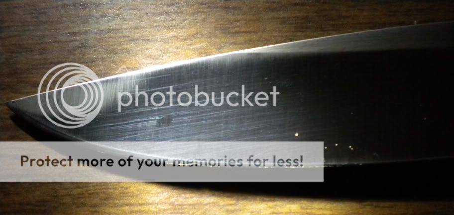

All the the knives are dulled somewhat, though they will still shave hair except the s30V. I can draw no conclusions from what I see so far. (did I mention that at this stage of the game, they're all very similar?)
Results after the second cut: I've cut another ten feet of cardboard with each knife (140 feet total, my forearms are now really feeling it). Time to draw some conclusions:

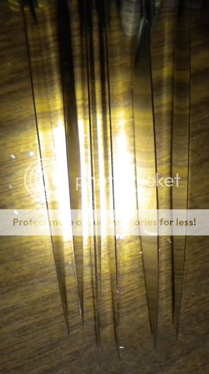

I do this by sorting them from worst condition to best condition, by observing the edge under bright light and magnification.
The S30V knife in this test (standard 3) is relatively dull at this point. The edge is wider and more washed out than the other blades and it won't shave hair. However, it is the only blade in the test without little shiny spots. This knife is pretty consistently a relatively low performer in these tests (compared to the other test knives). But don't get me wrong, it has been my EDC for years, it is quite good. So you see, everything in this test is relative.
Next is the blade with known issues with RA (standard 5). It is almost, but not quite the same as the other blades. I know from experience this blade will do okay until the last test. It has lots of little shiny spots. Shiny spots can be an area of RA that flattened out or rolled over, or it can be a small chip, or it can be an area where a band of carbide pulled out. They show up well under bright light.
Next is the high quality knife in D2 (standard # 2). This illustrates the fact that this is not always a perfect test because this blade will frequently beat out all the other blades in the test. However, on this particular day in this particular cardboard it didn't. It will not shave hair either.
The rest of the blades are too close to call. I can see no meaningful difference at this point of the test. They all have a few small shiny spots where the edge either chipped, rolled or a carbide pulled out, but these imperfections are on a very small scale. They all still shave hair.

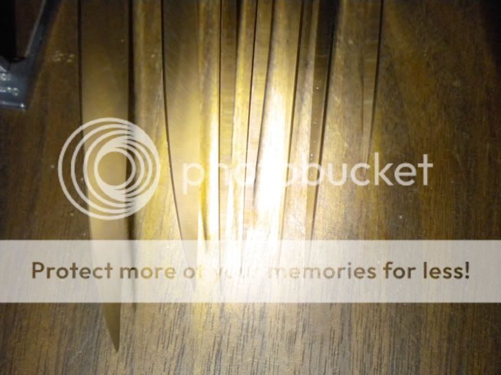

Time to draw some conclusions, I do this by sorting them from worst condition to best condition, by observing the edge under bright light and magnification.

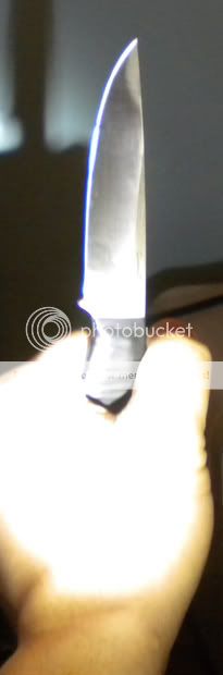

None of these knives are as dull as they appear in this picture. Highlighting the edge with a bright light and taking a photo of it makes the little flaws look like small parking lots. With the exception of the S30V, these all still cut well.
The S30V (standard 3) is doing poorly, and by a large margin. It failed to completely cut some of the cuts. I can run the edge across my fingertip without fear of cutting myself. I included it in this test because it has similar geometry and is a high carbide steel like the test subjects. But I also included it because, being one of my standards, I already knew it wouldn't perform well and I wanted y'all to see this. When I first started doing these tests I would get a large spread in the performance of the test blades. But at this point I'm splitting hairs, and the differences are subtle. I put this stainless folder into the mix so you would at least see some of the spread I used to see when I first started doing this. And, hey look, D2 gave S30V a major spanking. *grin*
Next is the blade with known issues with RA (standard 5). Although this blade is the same steel, with the same geometry and hardness as the other blades, it is beginning to show its weakness here.
Next blade is both P1 and P2, my test subjects. This is disappointing because it means the tweak I made to my process did not have the effect I hoped that it would (I had hoped these would rise to the top). Sigh.
Next is my skinning knife, (standard 1)
Next is a knife from my last batch (standard 4)
And the blade with the least amount of wear is the high quality knife in D2 (standard 2). I'll give credit where credit is due, this knife is a Bob Dozier in D2. On this particular day it out performed my knives on the leather test. However, at this point, these knives are so similar that the order varies from test to test. I'm picking nits here, but calling it as I see it. They're very very similar, and so far represent the ultimate in D2 that I have been able to find. I keep looking for improvements, but so far it appears I've picked all the low hanging fruit.

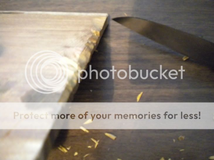

The last test is in some ways the best test, because there is usually a wide spread and little ambiguity. But it is also a somewhat less relevant test because it is an extreme test and doesn't really represent normal use. This is my hardwood whittling test. It tests edge stability, which is not D2's strength. This is an area where the W2 standard walks away from the others. It is also the area where I have made the most gains in my process.
This test chips and rolls the edge. It is the most difficult to perform evenly, so results have to be taken with a grain of salt. I carve a piece of wood with each blade, going from knife to knife, *trying* to keep my technique the same. After each knife has made five cuts I inspect the edge.
This test is brutal on a very thin, relatively hard, high carbide steel like this. I push the edge into the osage orange with my thumb while twisting the knife to carve out a little divot. It is unfair to the thinner sharper knives because they dig in more and can be more easily damaged, but in this case all the blades are thin, and I use the sharp area behind the belly that didn't get used in the other cuts so it is mostly apples to apples.
All of the cutting edges are somewhat damaged, none emerged completely unscathed, but it mostly requires a bright light to see the flaws. Every knife except one performed well, at this point I'm mostly just splitting hairs. But one stands out as quite bad. An order of magnitude worse than the others. This is very very interesting, because it is the same steel, same geometry and same rockwell hardness as other blades that do fine. What is the difference? *retained austenite* . This blade (standard 5) received a snap temper before being allowed to complete its quench. This was the standard D2 HT I received when I sent a batch out for HT several years ago to a respected heat treater. It represents the industry standard for D2. This is how many D2 knives out there are treated and this is a reason D2 has a reputation for taking a lousy edge and holding it. The best D2 knives are treated in ways to address its tendency to retain stabilized austenite. It's fugly. You don't need magnification, you can see the edge damage with it held extended at an arm's length

Folks, this is what I've been preaching about around here for years. Maybe you want to snap temper your simple steels, but don't do it with D2. Freeze it immediately. (Mf is generally listed around -100F)
Next in line for loss of edge in the hardwood whittling test is the high quality D2 knife (Standard 2). This is an excellent knife, and this test in no way shows any inadequacy at all. Having compared my work to Mr Dozier's for the last few years has been consistently humbling, I have a tremendous amount of respect for his accomplishments.
Next is the knife from my last batch (standard 4).
Next is test sample P1
Next is test sample P2
