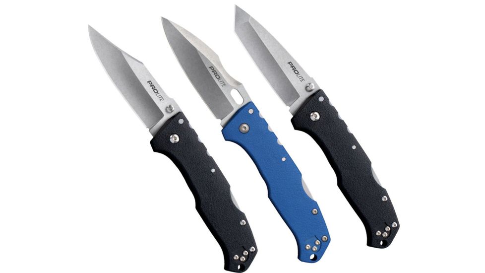

Cold Steel Pro Lite.
Incredible quality for the price (around 70€ on Lamnia, can be found cheaper)
