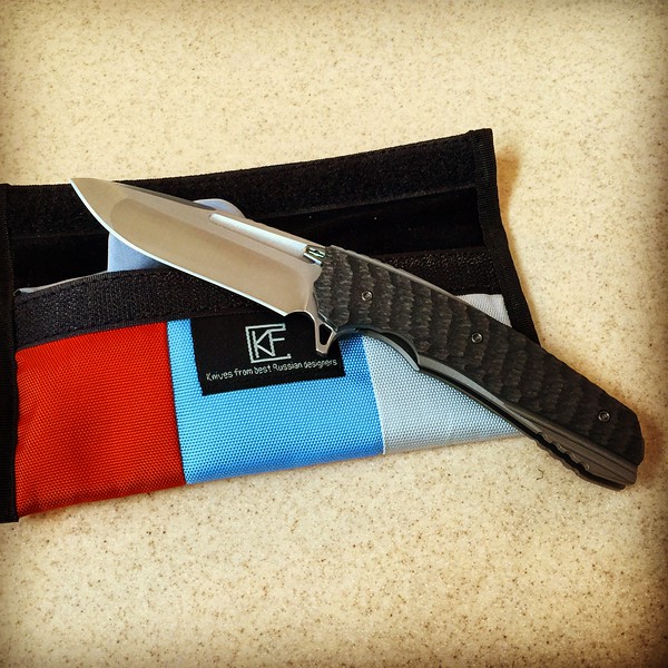

So I got my daboia/ckf/kevin john flipper today. Before anyone has a stroke, no its not a clone or counterfeit. This example is one of the few that is completely sterile. Some had stonewashed blades with the K. John Venom II logo, some had black sterile blades and then this type which is a sating finish. Here are the specs.
Opening system: caged ceramic ball bearing (single row) and ceramic detent.
Blade Length: 3.875" (98 mm)
Blade Steel: S35VN Stainless Steel
Overall Length: 8.375" (213 mm)
Closed Length: 4.5" (114 mm)
Handle Material: Carbon Fiber Face Scale with Titanium Liner and Frame Lock
Weight: 4.9 oz. (139 g)
Made in China
Pros: Very grippy, excellent ergos. Great centering. Flipping action is absolutely perfect. Snappy detent and blade falls right back into the handle under its own weight. Early lockup that is secure with no blade play in any direction. Perfect blade finish. No scratches. Very sharp polished edge. Perfect size. Its smaller than expected but has very good blade to handle ratio. Overall has a lot of bang for the buck.
Cons: Thumbstuds are decorative only. The strong detent as well as the stud placement make it impossible to open with them. There are a couple very very small marks under the coating that IMHO should have been dealt with before coating. To be fair I am ultra picky and I have seen worse on knives costing much more. Also it appears one of the tritium vials has a hairline crack. I am seeking a replacement if possible.
Overall: Very pleased with the knife. Sure there are a couple minor issues but nothing more than any other in this price range. At the price I find it to be wel worth the money. Only time will tell if it earns its keep. Unfortunately these are now impossible to get. I have a feeling it will be available again but through different suppliers. One thing is for sure if they pop up again, I will be buying another.

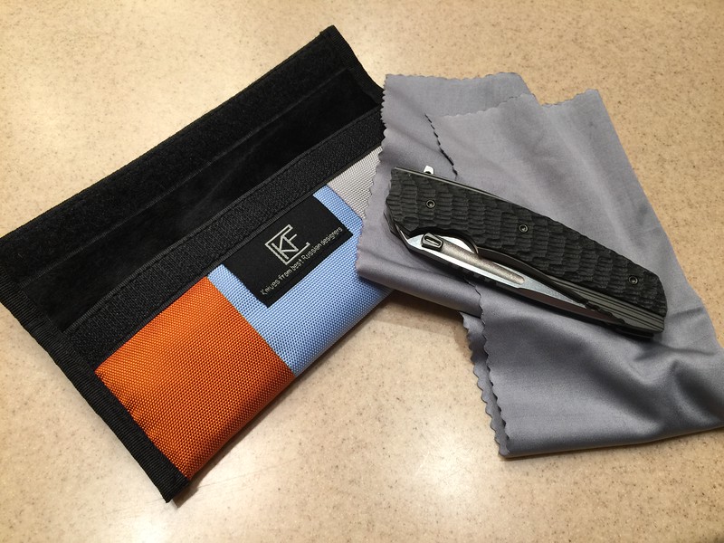

Packaging:
Packaging is very simple, a very nicely made lined nylon pouch done in orange, blue and grey stripes with an embroidered CKF tag (even though this is not officially a CKF product). I'm sure the stripes are intended to evoke the Russian flag, Red Blue and White. It is nicely lined with a faux fur and a full length Velcro strip. The liner does NOT shed which is nice, I've paid more for knives that came in some kind of velour bag that left tiny black hairs EVERYWHERE. NO. THANKS. So it's nice to see a quality pouch here, and not the usual wool and faux leather or nylon zip-up taco affair we usually see. Even my wife thought the pouch was cool.
Also included is a very nice unbranded microfiber cloth.

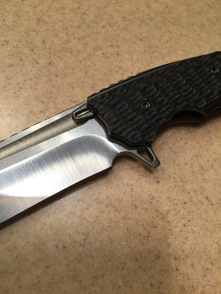

From outward appearances, the knife is very well made. Titanium frame, nicely carved CF overlay, steel insert on the framelock, lanyard loop, nicely designed flipper, decent jimping. The size, to me, is perfect. The grinds on the blade are excellent, and I love the Spanto grind. The whole package is surprisingly slim despite the size and it carries well.
The blade is perfectly centered and came right back to center after the teardown. As you can see, the tolerances of the frame to the blade are SUPER close.
And of course, the tritium. Oh lord, the tritium. I'm like a moth to a porch light when it comes to tritium, so this sent the knife in to the stratosphere for me.

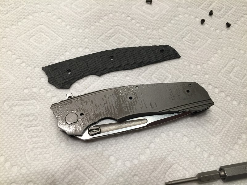

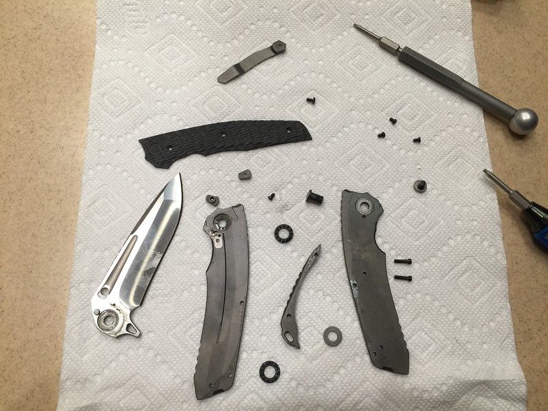

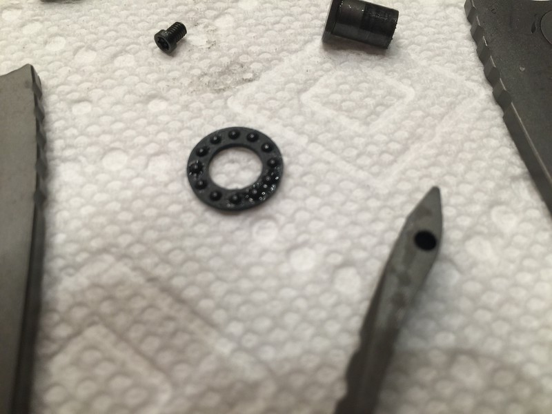

Teardown:
Here we get in to the nitty gritty. First off, all the bolts are T8 except for the pivot which is T10, this is nice because you won't constantly have to be changing your driver size as you go. The bolts are well made and don't feel prone to strip. All are very tight as well, so make sure you have good quality drivers.
The CF overlay is held on with three T8 screws and is separate from the frame.
This means that changing the scale will be as easy as three screws. Excellent.
The scale is also nicely milled for clearance on the pivot.
The texture of the scale is excellent, grippy but not too aggressive that it cuts up your hands.

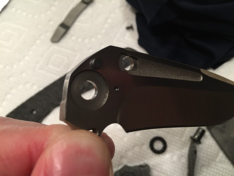

The blade is nicely detailed with all the edges chamfered, a very nice high end feeling touch.
The bearings are properly raced with washers.

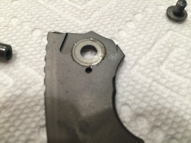

All of the machine work is decent. It's not perfect, but it's not the worst I've seen. I have more expensive knives with terrible looking insides compared to this.
In fact, most of the "flaws" you are seeing in these pictures are grease/lint/etc. and not machine errors.
The lock bar uses a ceramic detent (my fave) with a steel insert. The end of the lock bar was machined to use the steel insert tab as an overextention stop, a very nice and trick detail.
The bearings are indeed sealed ceramic.

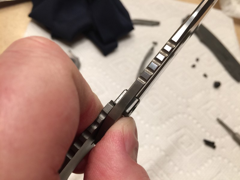

The "thumb studs" do indeed engage pockets in the frame. They are not fully blade stops (the tracked pin does this internally), but they do somewhat function as blade stops so they are kind of "backups". The blade is very very solid when locked.
All of the parts.

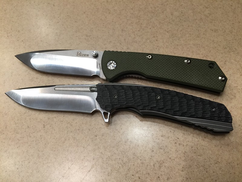

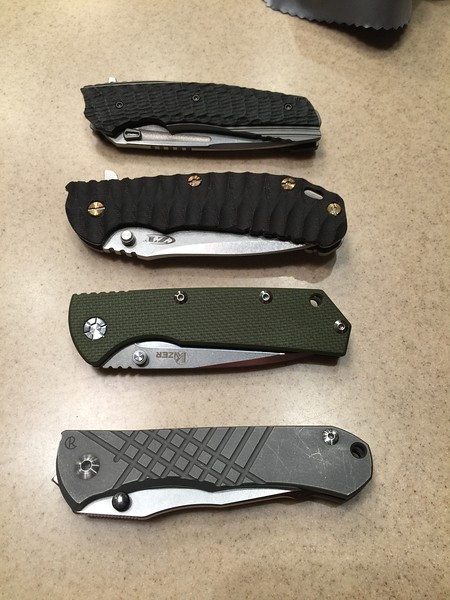

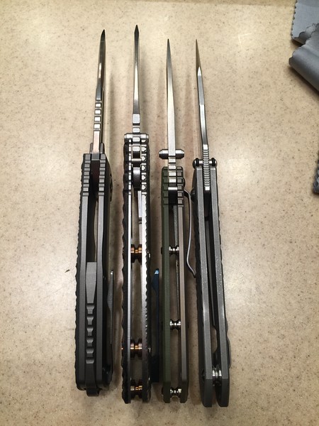

Comparisons:
Here's the Daboia up against some other knives of similar size and blade grind, namely the Kizer 4403A, ZT 0561 and CRK Umnumzaan.
As you can see, it's actually pretty slim and trim when you compare it to some of these other beasts.
I put it up against the Kizer 4403A because that's one of my favorite Kizer knives (other than the tip-down clip). Earlier I called the Daboia the "Perfect 4403A" and I took these pictures to show why, it's the 4403A turned up to 11.

4) On this example, for some reason the thumb studs kiss the frame during deployment. When I first got it, it was strong enough to feel like a second detent. It's now broken in and you barely feel it. Oddly enough there's very very little evidence of rubbing on either the studs or the frame. My other example which I sent to Auston did not seem to have this issue. The tolerance in this spot is very tight and this one was probably made at the high end of those accumulated tolerances.

EDITED TO ADD: Just looked at mine and the "thumbstuds". WOW! I cannot believe how close those come to hitting the frame when being deployed. Mine dont touch at all. No rubbing whatsoever. But I swear you couldnt get a human hair in their as the blade swings. Did you see if there is any give to the thumbstuds? Maybe loosening them and holding them forward while you crank it back down maybe giving you a tiny bit more room?
I tried doing what you suggest, loosen the studs and see if they will move, and they barely move within their sockets. Since I did the teardown it seems to be a little better so they may have slightly moved.
As I said, the tolerances are very tight. It only takes one part being at the end of one tolerance and the other part being at the other end of the tolerance for this kind of stuff to happen.
