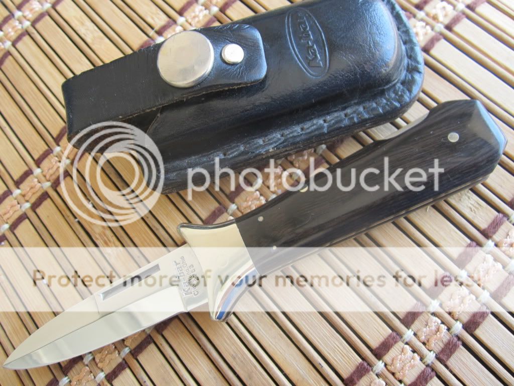

It's made from a Nicholson file, so I believe it's 1095. Got it polished so far, thinking about a guard of some sort now, and will be making it bloodwood handle scales.
It'll be 1095, Don Fogg bought steel from a Nicholson plant and had it analyzed...I used to think it was W2.

Looks much better than my first attempt at a knife, holds a shaving edge quite well so far, although being a novice to heat treat, I'm not about to try bend tests or anything like that. Still need to figure out where I can get something to polish the blade more. I'd like more of a mirror finish than I'm getting with just UF ceramic rods. Balance is right where I wanted it, right at the spot my first finger rests. Next project will be a bit bigger though.
Use wet and dry sand paper, start course and work your way down...when on a finest grit use the paper till it just about falls apart and you'll have a super fine mirror finish. :)
