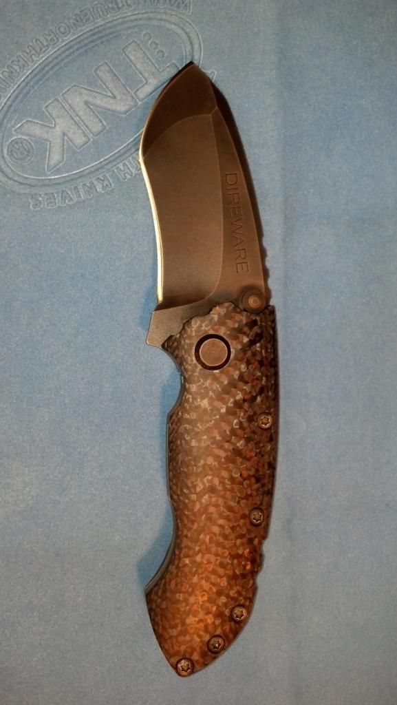

I may have to check these out awesome blade brother. I still love my Direware(s) own one have two more coming.
thanks guys!!!
i gotta say that direware is a sweet knife!!! solo 2 non flipper is the bomb :D
Yea I have a requiem 1 and s90 flipper on the way. After seeing this knife here I'm interested in it. I don't have much knowledge of your stuff Mr. Dalibor could you tell me more about this model i.e. materials thickness length price. Do you take orders? etc. Thank you.

The Direware looks nice but I dont care for that blade style. Just wouldn't be practical for me and what I use knives for. Hey Dalibor I better get a cut of each knife you sell from now on! LOL! Or maybe a discount on my next knife! :D I can't wait till Dalibor makes a flipper model too!! And I couldn't imagine a fixed blade from him! It would be a monster!! :thumbup:
I understand its not the easiest our most practical blade shape to use. I'm still getting used to it. I've seen one with a krein regrind the blade looks a lot more like this dalibor blade.
