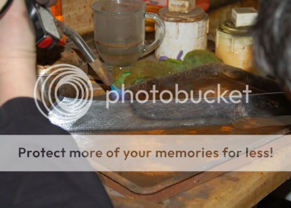

I set the blade in a tray with about 1/4" of water and slowly walk down the spine with a propane torch.

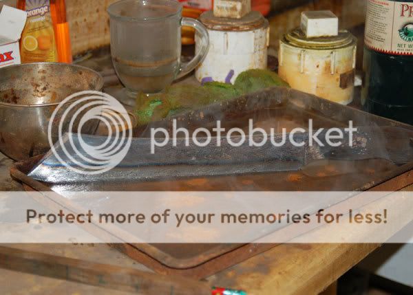

This is what it loks like when I'm done. This will leave the blade about 58 RC at the edge and closer to 50 RC at the spine.
Burt .. are you doing the propane treatment to the tang as well? I just want to know the hardness of the tang .. is the tang is having a 50 RC or a 58 RC or another different hardness?
In your opinion, which one is good for the tang .. 50 RC (i.e. same hardness with the tang) or 58 RC (i.e. same hardness with the edge) or a different hardness (i.e. defferent from the hardness at the tang or the edge)?
So sorry for a bit late in asking this particular question .. sort of anti climax I guess .. anyhow it is better to learn something from a MS :o
Mohd.
