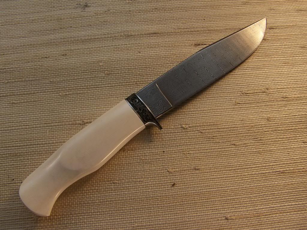

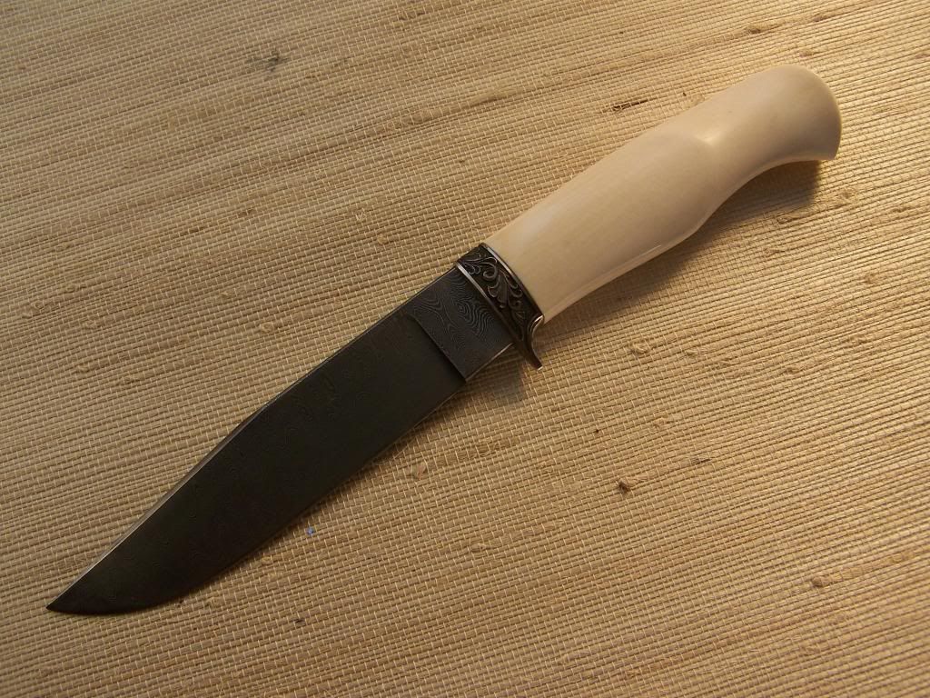

This is a customers design. I don't say that to remove myself from the concept, but more to give credit where credit is due. I find it a very well thought out and thoroughly functional knife. One of our own designed it and I am sure he will chime in.

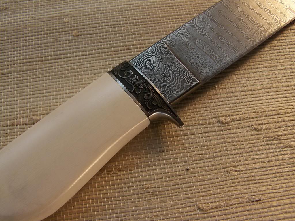

The blade is 5.5" of 400 layer ladder damascus of O-1 and 15n20 at 59rc. The handle is 4.5" of ivory and the guard is 416ss. The guard is adorned with my sculpted and Frenh greyed deep releif scroll engraving. It is also a take down as all of my fixed blades are. Balances just behind the front edge of the guard.
The guard to handle fit is done on a radius in that the rear of the guard is concave, the ivory is convex. It creates a subtle touch that adds a little interest.
Let me know what you think!!
