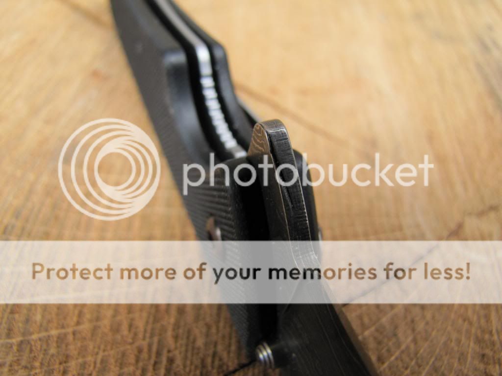

I posted this in general and it didn't get much feedback so I'm trying here. I'm on the fence about sending it back because I like the knife so much and plan for it to be a user.
Look at the pics and you will see what looks like a crack or void on the edge of the flipper. My questions are is this a result of the Damascus manufacturing process? And will it cause any future problems? It doesnt seem to be in a structurally crtitcal area.

Another member who is very knowledgable in all things Damascus contacted me. He described it as a"delamination of the (Damascus) weld." This info was very helpful in making the decision to return it. Just wanted to share that in case someone else encounters a similar problem.
I'd return it from where you bought it and have them exchange it. Kershaw usually does not keep Damascus Blades on hand. But give them a call and see what they say..
Looks like a cold shunt to me:) Have seen it several times over the years,they tend to also show up by a rust line as the shunts tend to rust more easily. Glad they have a replacement!

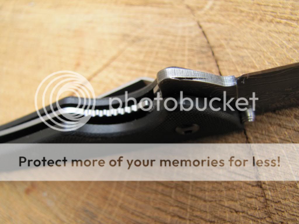

Got the Damascus Leek today, this is my first Damascus knife as well. The blade on this one has what appear to be imperfections, I don't know if this is just a normal thing inherent to Damascus or if this is something I should be sending back for.
Not great pictures but hopefully you can see what I am talking about. Looks almost like a crack in the blade.

I used sticktodrum's advice and asked if they had a replacement when I called. As he stated they can check if a replacement is availible. You might want to try and exchange it with the seller. First for a faster turn around. For me this was not an option because the Skyline is sold out everywhere. I see the Leek is stil available at a few places. Good luck, it's a sweet knife.
Pistonandgears that is a perfect example of a shut you can see what looks like the rust line also it is going across the grain. When I grind a blade and find one it becomes a user for me. Send it back and let them fix you up.
