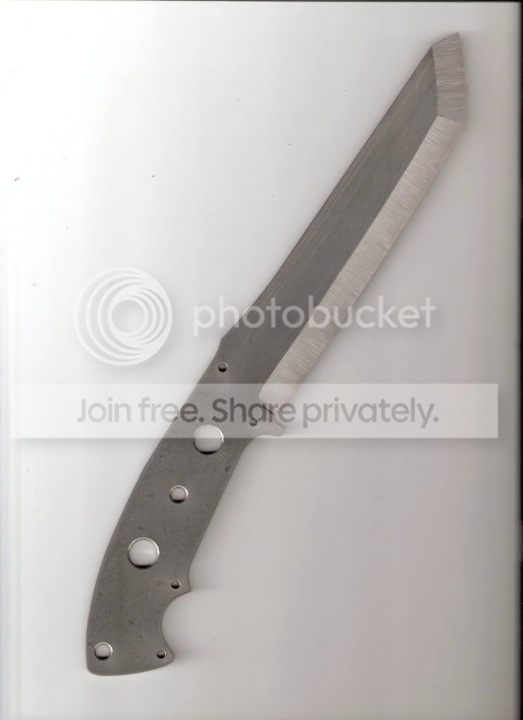

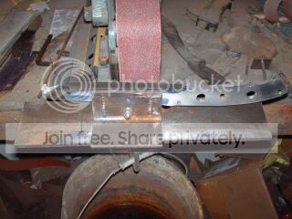

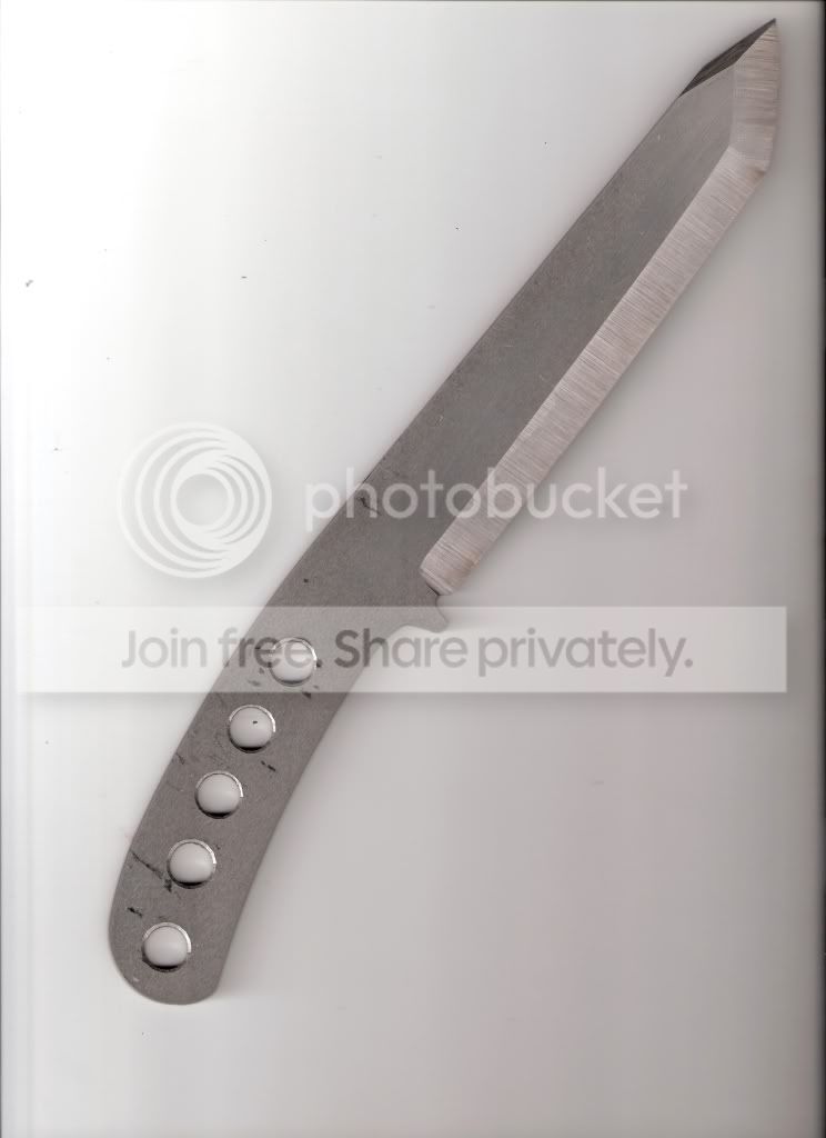

well after the cussing and band aids and not having fun, as in this thread here,http://www.bladeforums.com/forums/showthread.php?t=578272

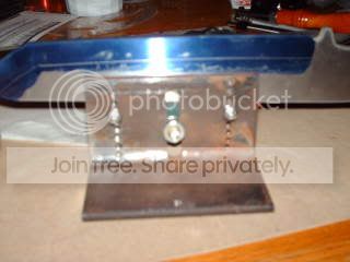

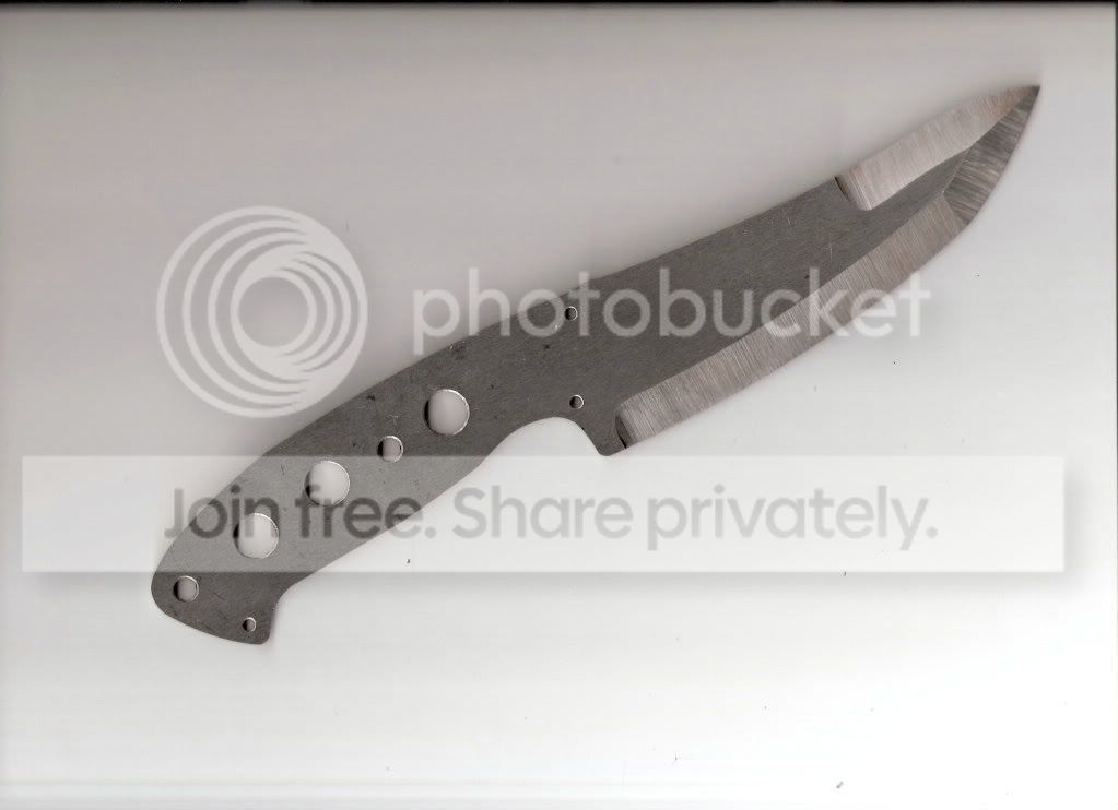

I made me a jig.
i know, it does feel like cheating but it is so much easier now.
it's fun once again.:)
These are very nice grinds, good job. I'd say if you are happy with it keep cheating then :D

That jig took about two knives to get used to before i was getting those nice clean lines. U have to sweep and caress the belt lightly in one fluid motion from plunge to tip in order to keep the grind looking nice.

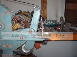

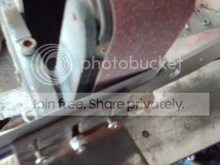

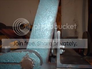

kiahs, im running a squarewheel grinder with a modded work rest. the jig stays flat on the workrest and i angle the flat platten to the desired angle.
I can stage the set up if you guys would like to see more.

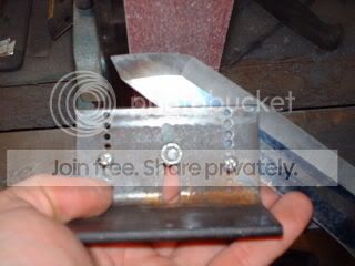

I made one this morning, only difference is I used c clamps to hold the blade to the angle alum, measured, drilled, and tapped a couple 4-40 holes strategically to what looked good for the different widths of stock I use. I was able to clean up one blade, and grind flats on one other in about an hour.
I am still grinding on a 4x36, so I adjusted the angle of the whole platen, took about 1min. I used layout dye to check the angle after a change. Was pretty effortless for the most part. Awesome thing is once you get the angle set you do not have to touch it even after switching sides or belts. The c clamps make nice handles to hold onto while grinding, and also when dunking the blade in water. Oh, the alum kinda acts as a heat sink (think quench plates...) so I could grind a bit longer before water residue from the dunk would evaporate off from heat.

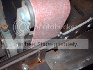

Dixieblade57. heres the set up.
Modified work rest and jig.

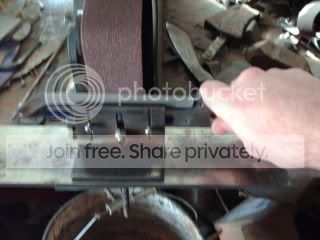

Pic showing angle of flat platen

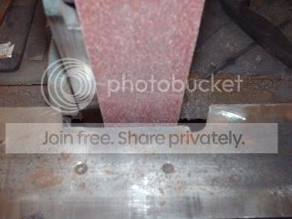

Allready ground bevel up against angled platen.

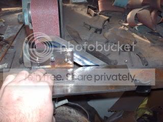

Modded work rest

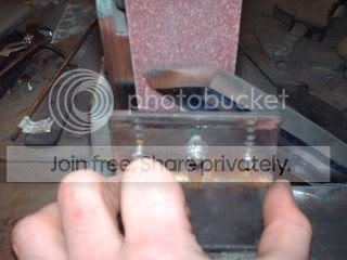

Angle at which i start my grind to make sure the plunge area stays even with the rest of the grind.

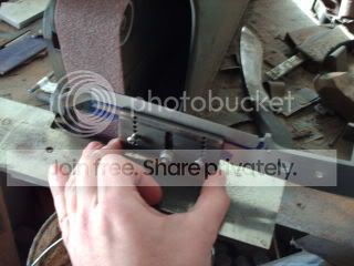

as soon as you touch the belt bring the knife in line with the belt and start drawing the jig to the point of the knife on the belt.
its hard to show since i have to hold the camera but put these photoes together to see how i have my hand placement.

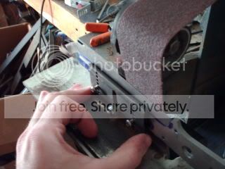

Setting up to grind the tip.
move the workrest out enough to allow clearance of the knife between the platen and rest.
if it's a curved tip just rock the jig back and forthto follow the curve.(if that makes sense.)
Pic of clamp. its just a scrap of G-10 I ground a lip onto help hold the blade with a hole drilled through to allow for a bolt.
pic showing the super super crude slot cut down the center.:D
It's cave man simple but very effective.
