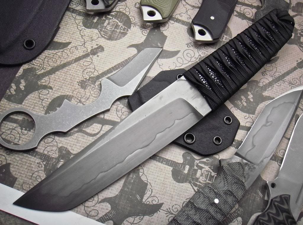

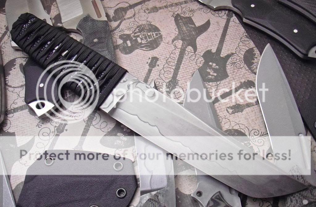

This fella is almost done, still needs a Turks head. 3/16" 1095 tapered tang, rayskin, 5.5" blade 10.5" OAL.
Hope you guys and gals like! Comments are welcome.

I like the shape of the blade very much but the wrap looks a little off
More than a little. The wrap is not up to the rest of the blade in any way, shape or form. It needs clearly shaped diamonds, in the way of the Japanese blades, hinari-maki....and for Pete's sake, use silk cord designed for tanto, and not shoelace material.

Thanks! I do appreciate that. I was in a hurry trying to get it done. Fortunately it's not permanent, I will address it.

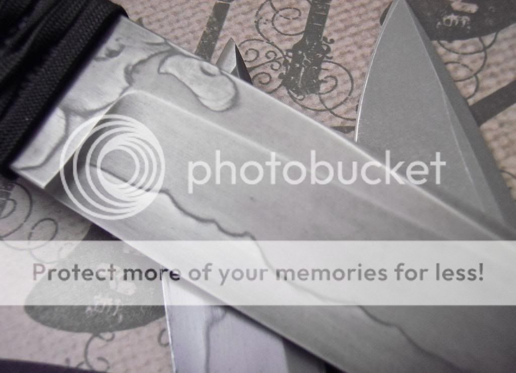

I'd just like to chime in that I agree with my esteemed fellow forumites, Joe and STeven, above. To my eye the blade itself is quite pleasing in both shape/grind and the character in the quench line. It deserves a good tsukamaki job.
On a more general note--not picking on you, Paul--we are seeing more and more Japanese-influenced design cues in knives from many makers. I would ask that in "borrowing" these elements that makers also consider whether (or not) their interpretation of these elements represent well-executed examples. This includes handle wrapping (tsukamaki), quench lines (hamon), blade collars (habaki), blade laminations (kitae), etc.
I feel it's important when adding elements that one must consider both the aesthetic and the intention that produced the original. I would not accept a shoddy, inelegant habaki on one of my swords, and neither would I accept one on a knife that uses one as a design element. A hamon that runs off the edge of a nihonto represents a "fatal flaw". This is true (in my opinion) for a knife with a similar quench line.

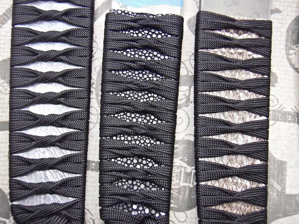

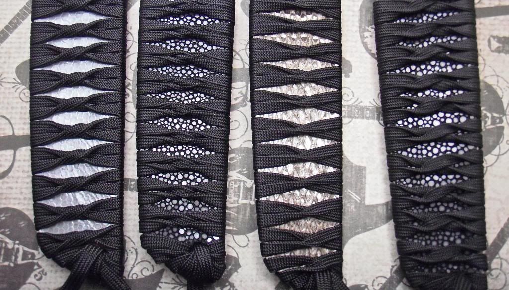

So I am finally getting around to posting some of these pictures. I figured I would try some different ideas. Yes they are still para cord with out the core, I will get some done in silk when I get some in stock.
I noticed when I was rewrapping the first handle the para cord was really stiff. The handle all the way to the right and last picture. I did try to do two folds but it really didn't like it. I went to the rope warehouse to see if they had any more in stock. It seems like the new para cord was much more flexible.
The handle on the farthest right was what I was initially trying for. A single fold I have done it in the past and I thought it looked good, but next to the others not so much.
So what are you guys thinking
