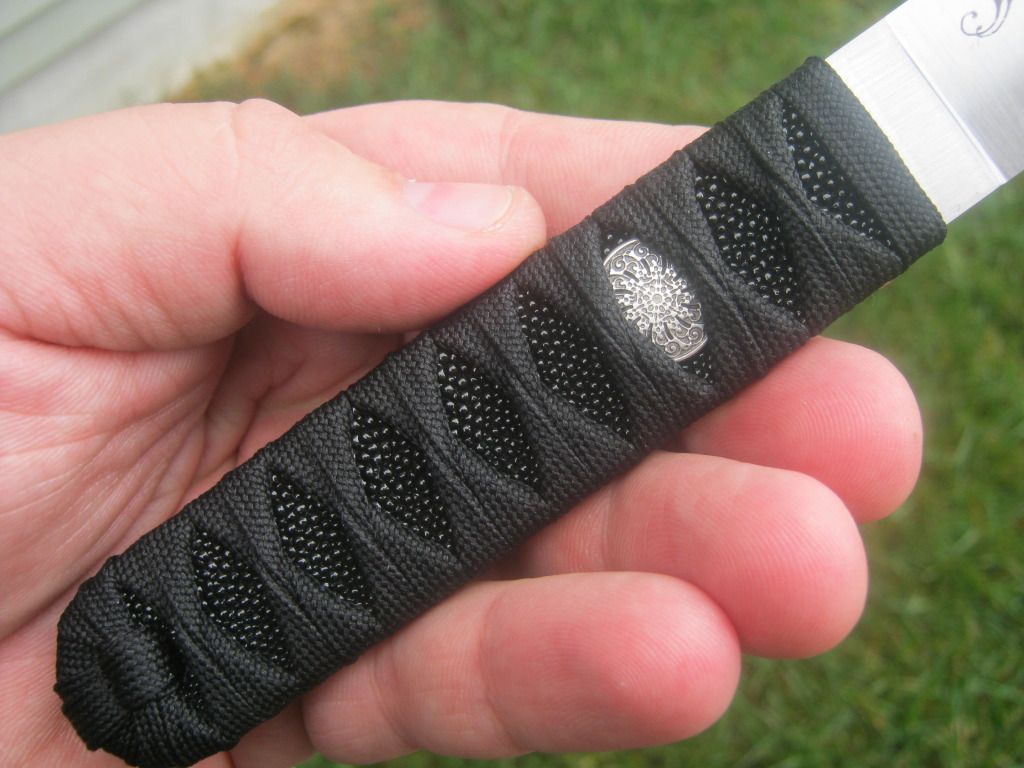

To reiterate STeven's point above, I think you really need to find some good quality ito and use that. Trying to do a Japanese-style wrap with paracord (gutted or otherwise) is like trying to fell a tree with a Swiss army knife. Wrong tool for the job, though it's perfectly serviceable for other applications.
Using a better quality wrap will improve things drastically
PH did not use silk iaito more like a flat shoe lace
But it was even and tight and had a resin coating on top

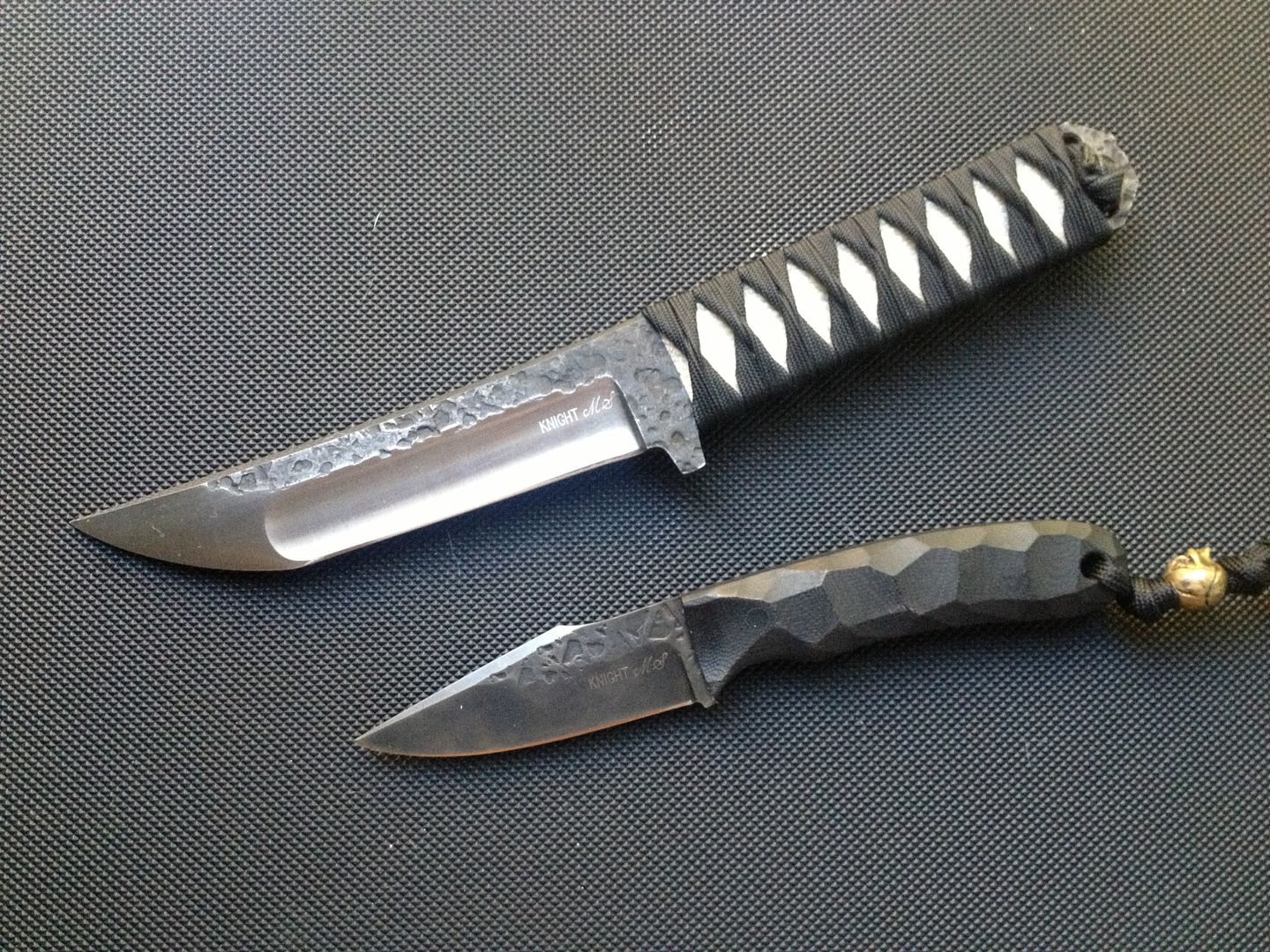

Jason knight does a tight well layed out wrap
Burt Foster does a very nice job
David Mirabile does great work with a carbon fiber wrap
RJ Martin in his day did a wicked durable resin soaked wrap
Even Shiva Ki did a very serviceable wrap
So the point is it does not have to be traditional but there are materials that work better for this application and para cord is not one of them. :)

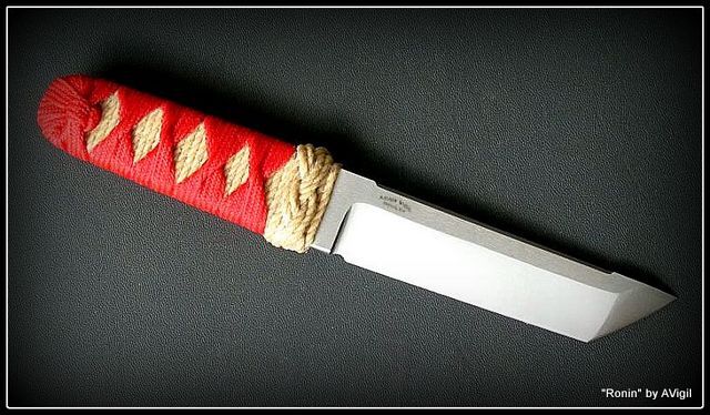

I like your blade very nice grind. There are different widths of cord you can try. On that size blade I like a bit of a wider cord. Here is one I did in Red with a cord of about 5/16" which when tied is about 1/4". I think when you try a good flat cord you will like it.
