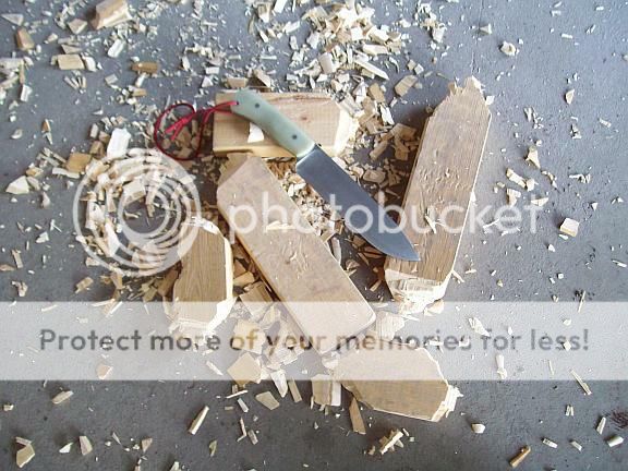

We found that we both had an emerging appreciation for nice Koa wood - and it was David who tipped me off to the availability of one of the nicest boards I have seen:
David was kind enough to take delivery of that piece for me and cut it up into generously-sized knife blocks. Which all led to the idea of maybe putting one of the blocks to use on one of his camp knives.

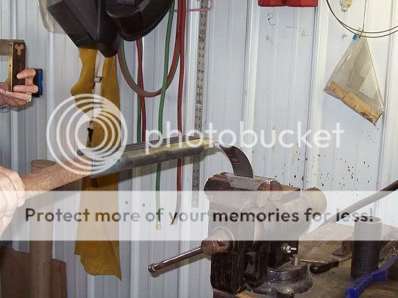

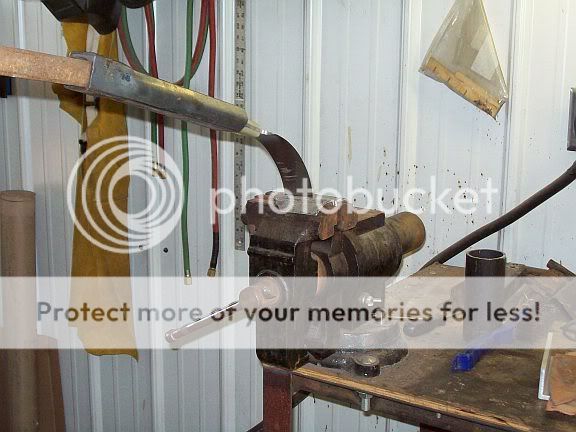

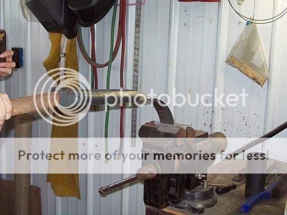

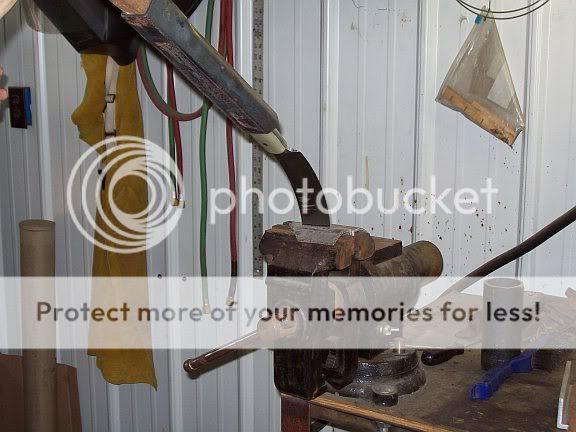

On a side note, I've been a tad quiet the past few months. FWIW, I've still been hard at work, mostly honing my Damascus making skills and getting ready to test for my J.S. Stamp.
I've been an ABS Apprentice for nearly 3 years now and I'm ready for the performance aspect ! I plan on doing it at the 7th Mid-America Bladesmithing Symposium in Troy Ohio, this August 26th, 27th, & 28th :thumbup: Words can't begin to describe how excited I am :D

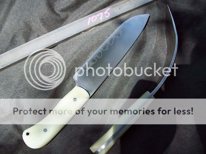

I made 2 test blades. The first was made to test here at the shop, the 2nd being the actual test knife. The first blade passed with flying colors !
I'm doing it a little different than many of the guys who've tested. Instead of using an edge quenched blade of 5160, I forged mine using 1075. I coated the back with satanite and did a full soak in my kiln and a full quench in Parks 50. I'm going to rely on the clay to do what it's supposed to do. Blade #1 was a complete success. I literally beat the crap out of blade #1.
Until I get the next set of pics in Roger's GUS Mod build ready, I hope you can share some of the excitement, and the butterfly's in my belly, by checking out these pics of my test blades.
So there you have it ................. sorry to get sidetracked for a moment.

And the 1075 I used for my test knives.............. BEAUTIFUL material !!
I don't know if you noticed or not, but I etched so I could get a look at the Hamon on my 2nd test knife. It was only finished to 600 grit so I'm sure it could have been even better if I'd taken it to 1500+
There was a dandy on the #1 blade too. It darn near killed me to create it and not bring it out to get a looksee ;)
