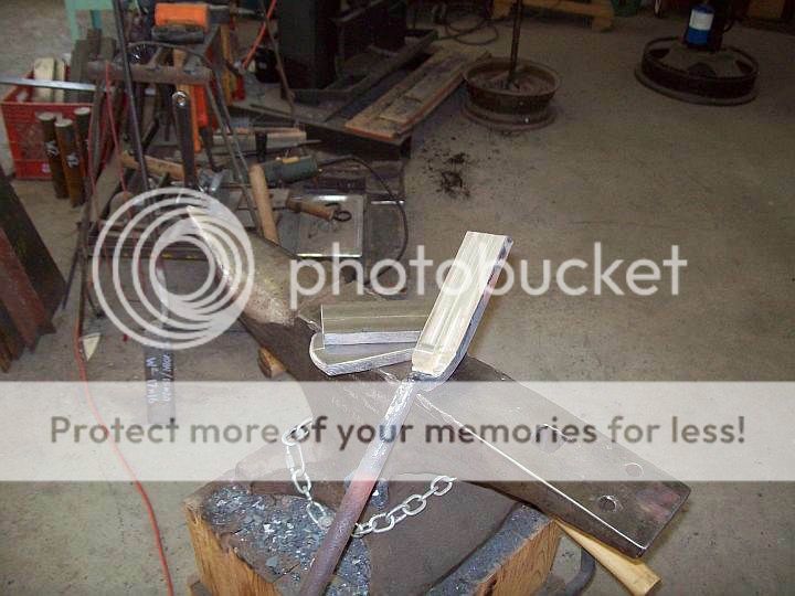

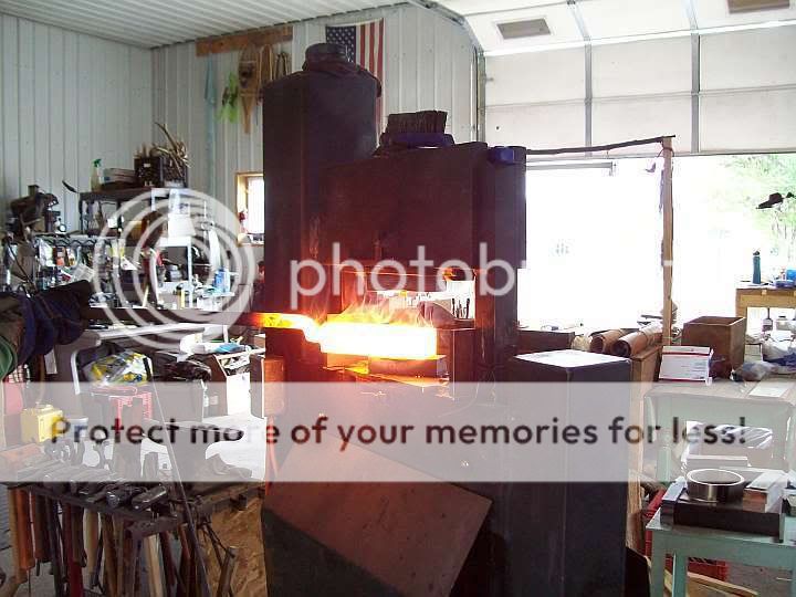

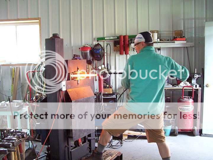

Here we see the forge coming up to temp.:
Getting ready to add flux after heating the billet:
The billet going into the forge for a good soak prior to making the first weld:
The first few bumps:
The billet just after the first weld:

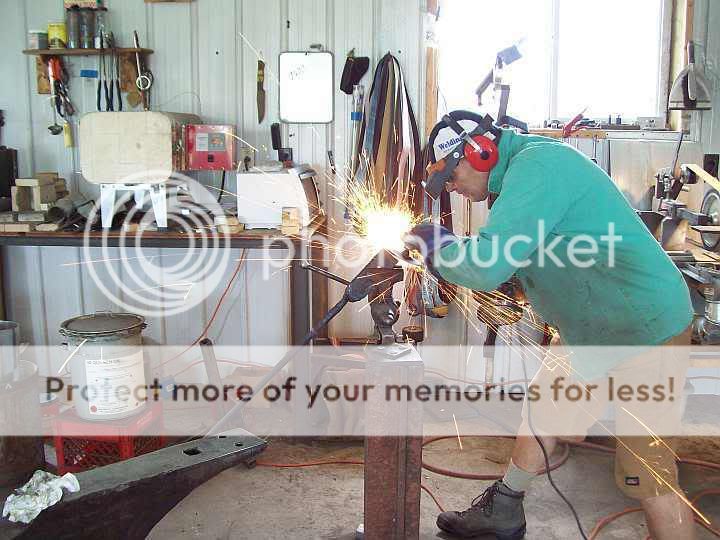

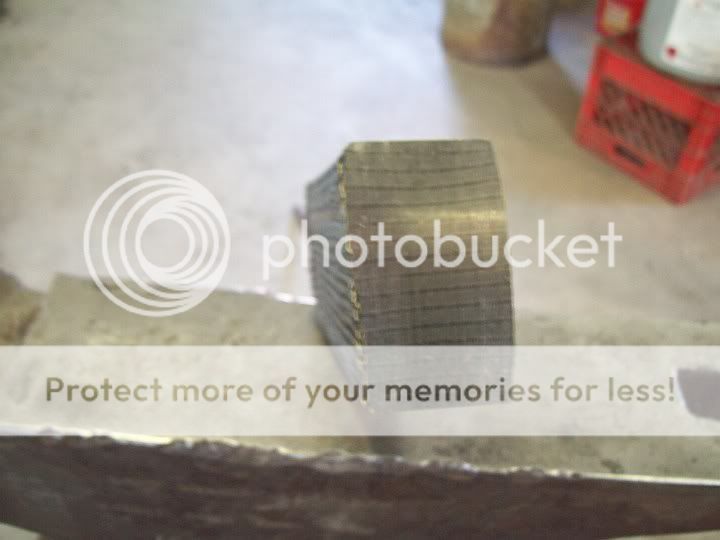

This first image shows the billet end after grinding and etching. Even though the welding I did (TIG) to keep the pieces of 1084 & 15N20 together prior to the initial first forge weld didn't include any filler rod, I still want to get rid of what could possibly be a random blob showing up somewhere in the finished billet. I do that by grinding the end to get rid of the TIG weld line, then doing a quick etch just to make sure it's gone.
Do to my background in Tool & Die/Machining, I attack my knifemaking and forging from a systematic approach. It's just how I've learned to do things.
That being said, my theory when it comes to making pattern welded steel is that random pattern is just that, random.
On the other hand, I want the ladder pattern billet I'm creating for Roger's blade to be a very clean example. No surprises or "random" blobs popping up in the ladder pattern.
Just for the record, I always like to give my teachers and mentors in this wonderful craft credit for what they've taught me. This "etching the end" trick, in fact, most of what I know, regarding making Pattern Welded Steel, I've learned from my good friend Kevin Casey ;) Thanks Buddy ! :D The time you've spent helping me is very, very much appreciated :thumbup: :thumbup:

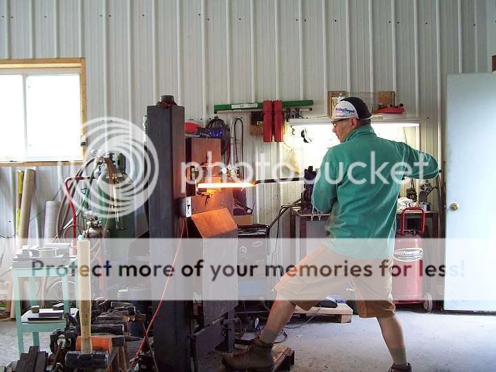

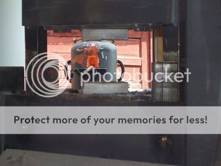

This next image is what I thought was a cool shot :o The billet coming up to temperature, ~ 2,150* F , through the dies of my press :thumbup:

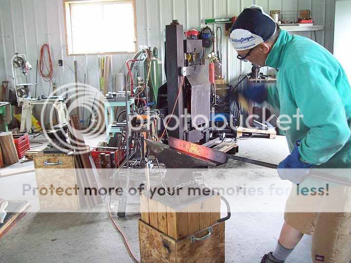

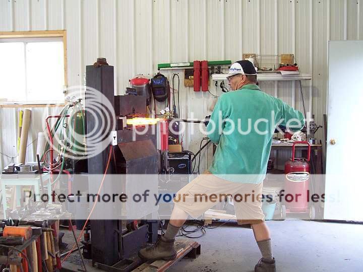

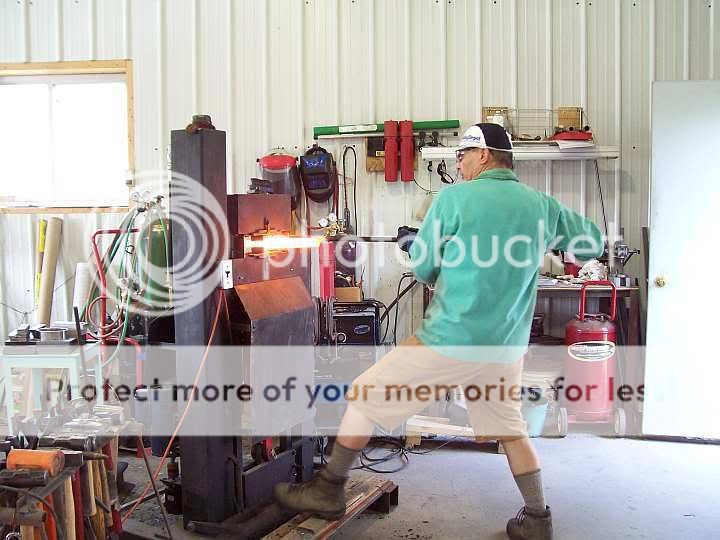

This next set of pics shows me drawing the billet out to what will end up being ~ 18" L.
Redundant, Redundant, Redundant
The next pic shows the billet drawn to it's pre-cut length of ~ 18" L.
This pic shows the billet cooling slowly, after drawing, in my vermiculite tub. This allows me to easily saw cut the billet into 3 pieces of equal length. I'll clean up top and bottom of each piece, tack them together and go through this same process all over once again, (forge welding & drawing). Theoretically it will make the 31 layer billet 93 layers of 1084 & 15N20.

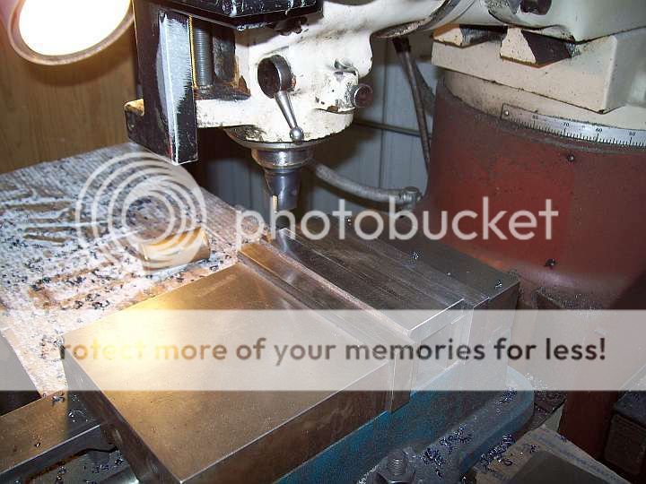

In regards to this build, today I was able to get the billet sawcut into 3 equal length pieces ~ 6" L.
Rather than grinding, when it comes to cleaning up the mating sides of a billet in preparation for increasing the layer count, I prefer to use my milling machine. I have the best luck using a 2 fluted indexable insert endmill. I simply clamp the pieces in my vise and clean-up the workpiece faces

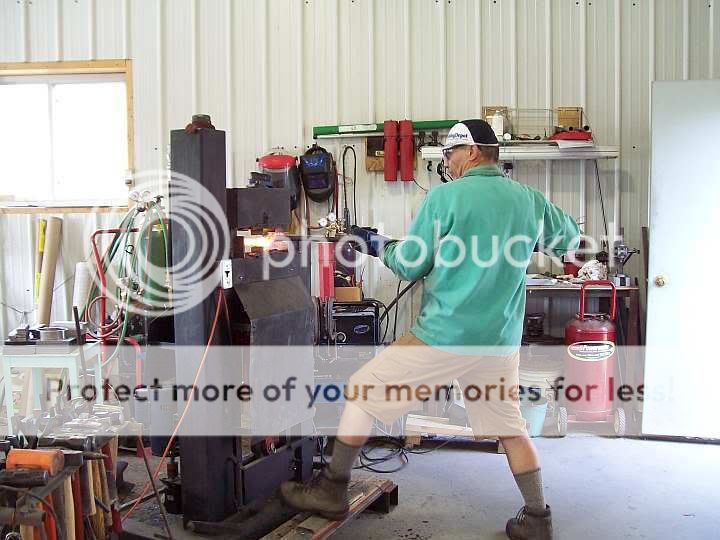

Here we see the billet all tacked up, ready to forge weld. FWIW, and I can only speak for myself, I've found it best to pre-heat the ends prior to welding. Being high carbon steel, if I don't pre-heat, I've found the welds like to crack. I haven't had it happen to me yet, but I've heard it can be a real drag trying to fish pieces out of the forge that have come undone from the billet due to failed tack welds. I'd rather not have that happen ;)

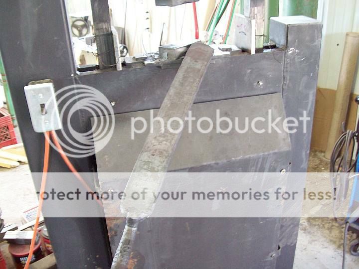

Here's a pic showing me drawing the billet out after forge welding .......
This one shows me at the anvil, just after the drawing operation. I occasionally end up here, using the long flat surface of the anvil to do some straightening.
After the above starightening operation I took the billet back to the saw, cutting the billet into 3 equal length pieces again. Then went to the mill again to clean-up the mating surfaces. This will be the last stacking, tacking and forge welding operation for the blade steel.

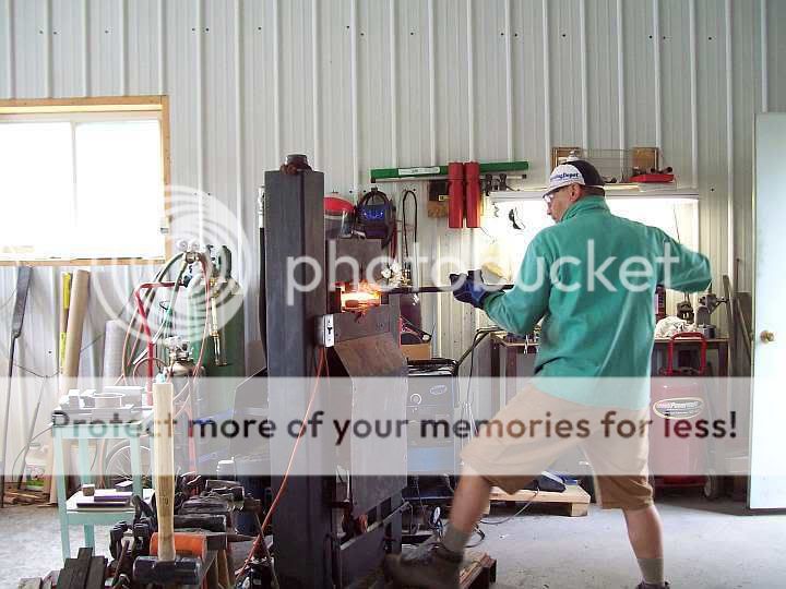

Here's what I think is a very cool shot of the billet just before the forge welding bump .......

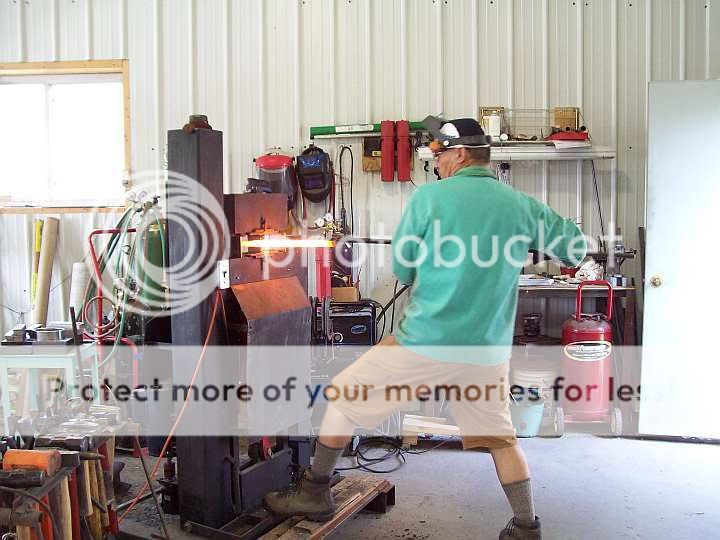

After getting rid of any possible weld, I went back for the final drawing operations
The billet is now at the final layer count of ~ 279, and ready for the laddering operation.
