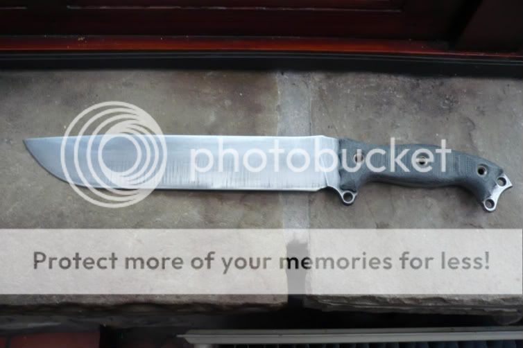

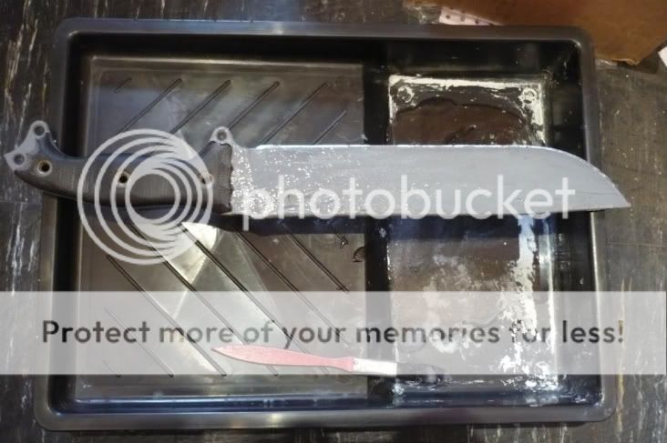

I found some pic's of when I stripped my NMFBM....here is what to expect....

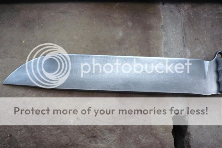

I had dimples on one side and some grind marks on the other...no two are the same though...you can get smoother finishes than I found...it's just pot luck...

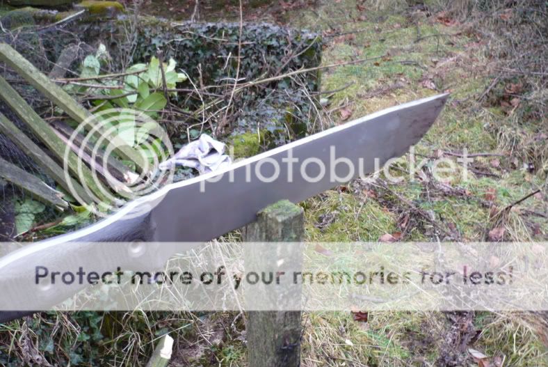

Took mine to the belt sander and by the time I had removed the grind lines using a slack belt method and a magic marker on the blade to determine consistant stock removal....the edge was a full convex one and truly awesome.
Take a hint tho from having then taken it to be bead blasted....use that edge up for at least a good week's worth of use take get the best out of it...the bead blasting blunts the edge considerably and it takes a little while to strop it back using a leather paddle and compound...you cannot use a full contact slack belt for a quicker restoration of the edge as this simply would remove the bead blasting....you could tho use the sander to give the full convex edge a slight secondary bevel...however I preferred to keep the full convex grind and brought the edge back using a leather strop...however once it is restored you have a great looking knife at a lot cheaper price than the BBDC factory prices being offered on the exchange...
After some hard use....and a few more stroppings....
It becomes your "favourite user"
